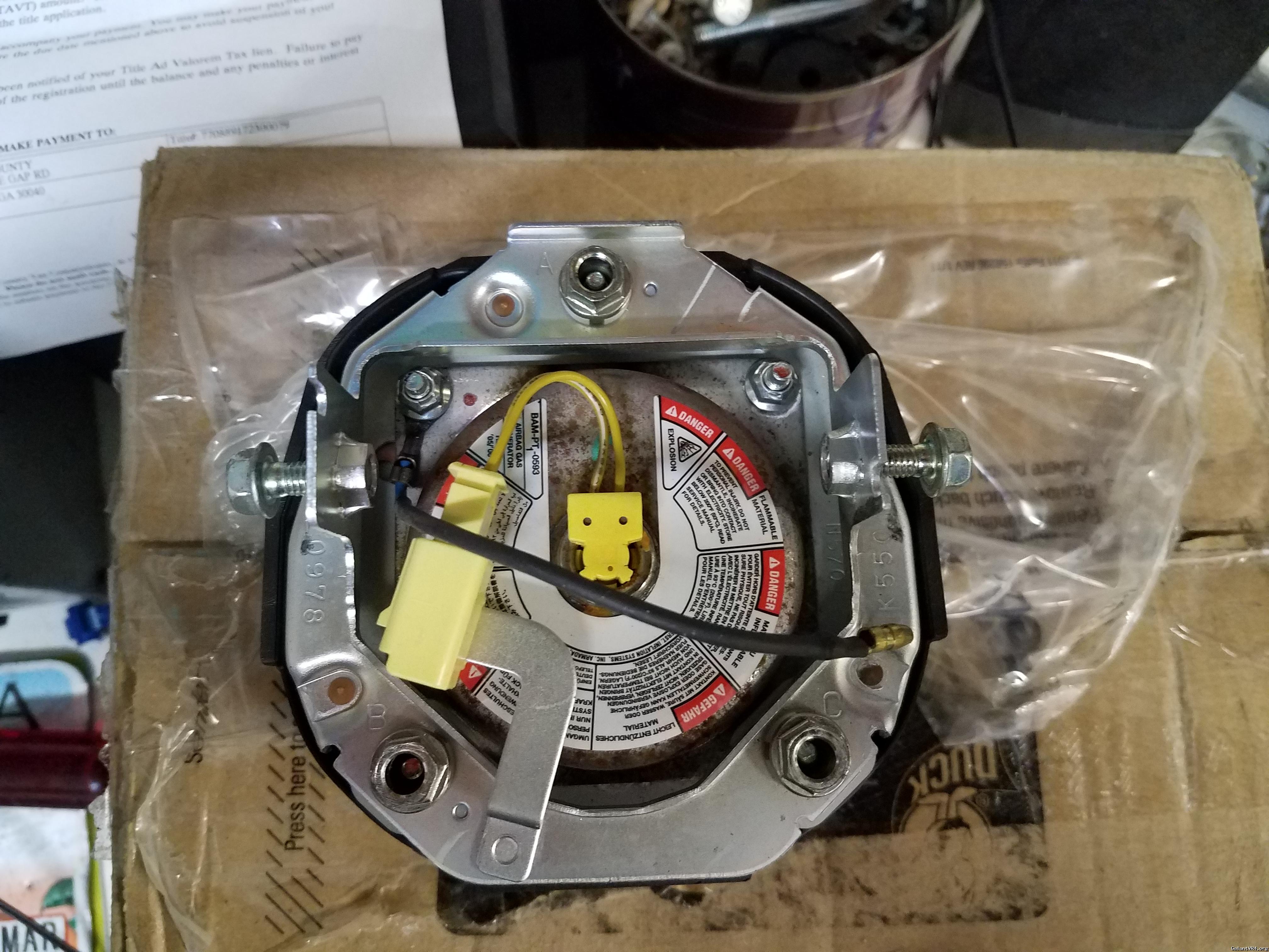

Alright have a few questions, I have the wheel ready to go with a modified center section from a 1g wheel(thanks Curtis). Just want to know the best way to make sure this airbag doesn't go off, ie make the airbag inert. Also the best way to get the horn hooked up.
10,992
Post a picture of the back of the airbag so I can look at it. I should be able to tell you what to do to disconnect it.
10,992
Basically you want to disassemble that and remove the part with the labels on it. That is the ignitor. You can leave the actual bag in the wheel so it feels normal at the horn pad.
