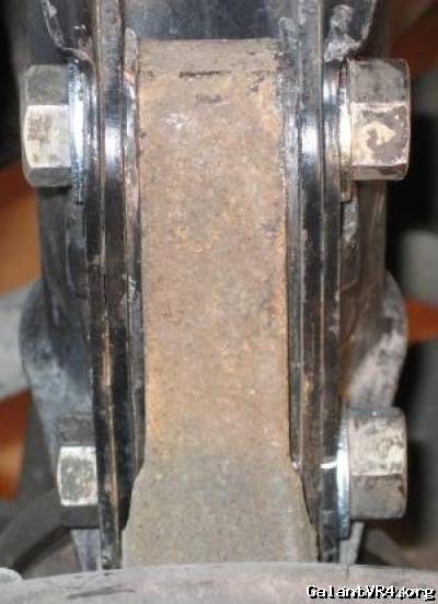

these thread here
quoting pudhed
The problems are: Galant struts have 22mm spacing between the strut ears,
Evo struts have 27mm spacing between the ears. So spacers are needed for
the front. The Evo rears have a fork, rather than a loop, so some welding is needed.

dont forget the hardened washers. I am only using one spacer up front btw...
