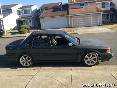

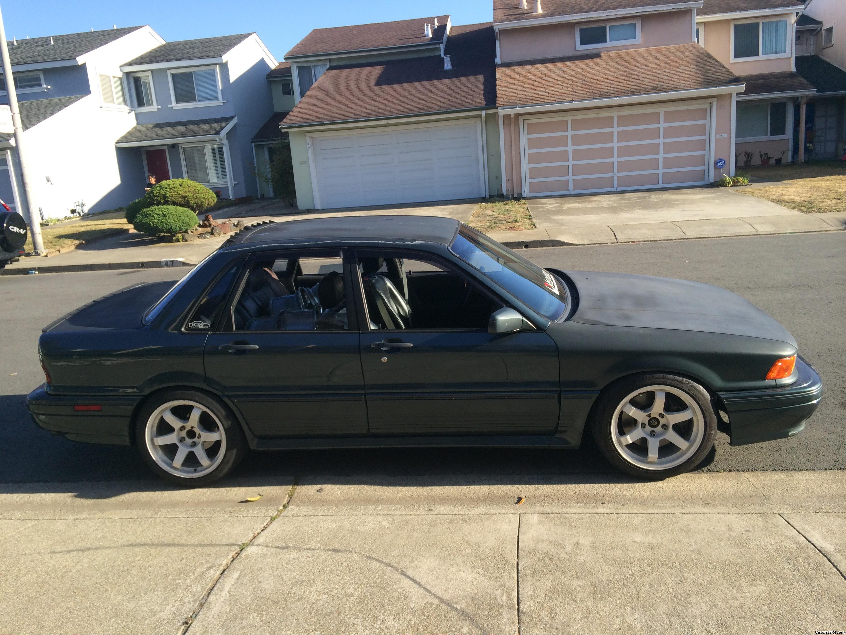

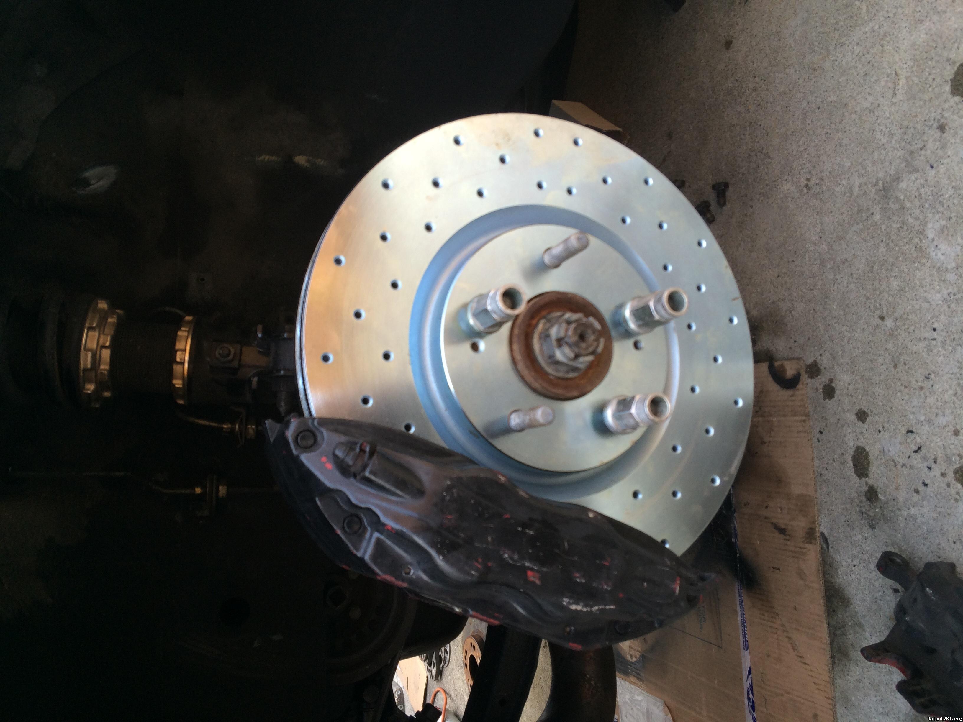

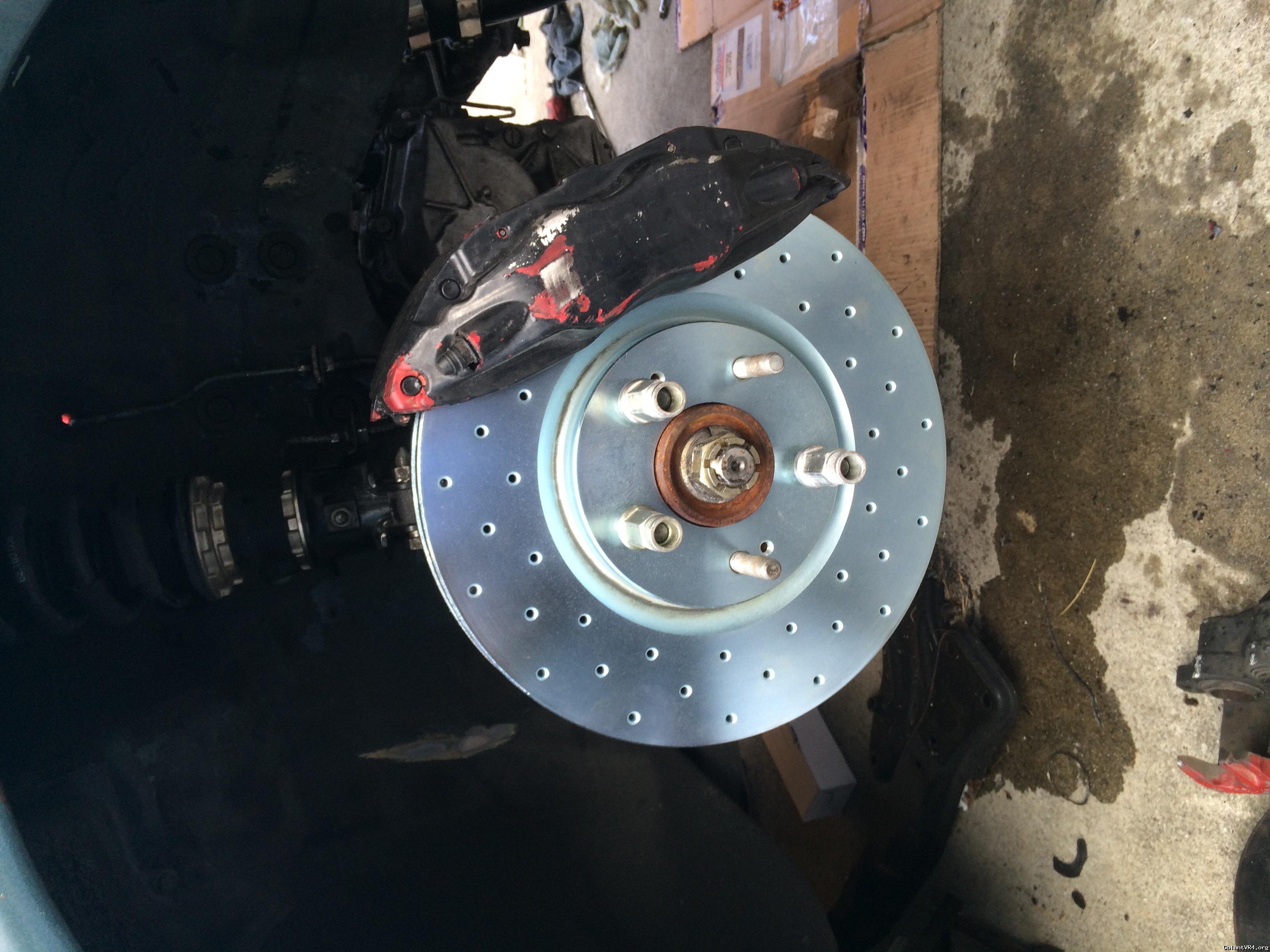

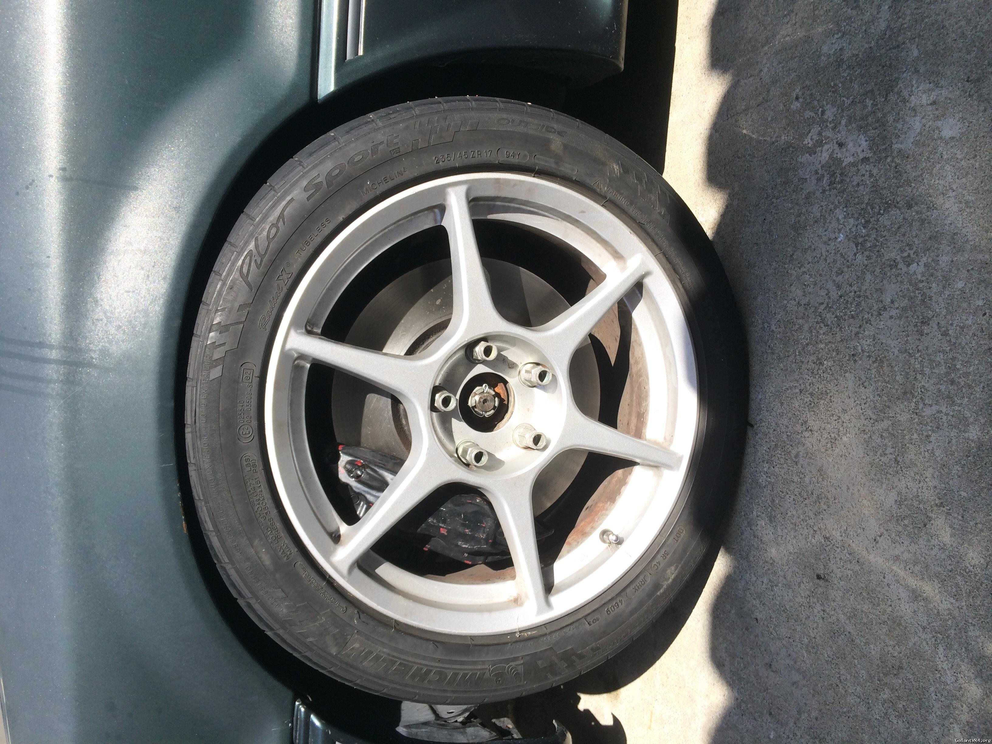

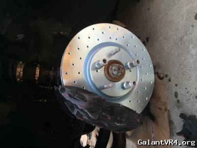

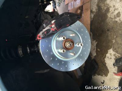

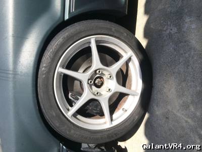

Havent been active for a while but here a lil update on the SHITBOX... Upgraded to the evo brakes... Found out kosei k1 didnt fit without a lot of spacers so has to get different rims...
Kosei k1 with 26mm spacers

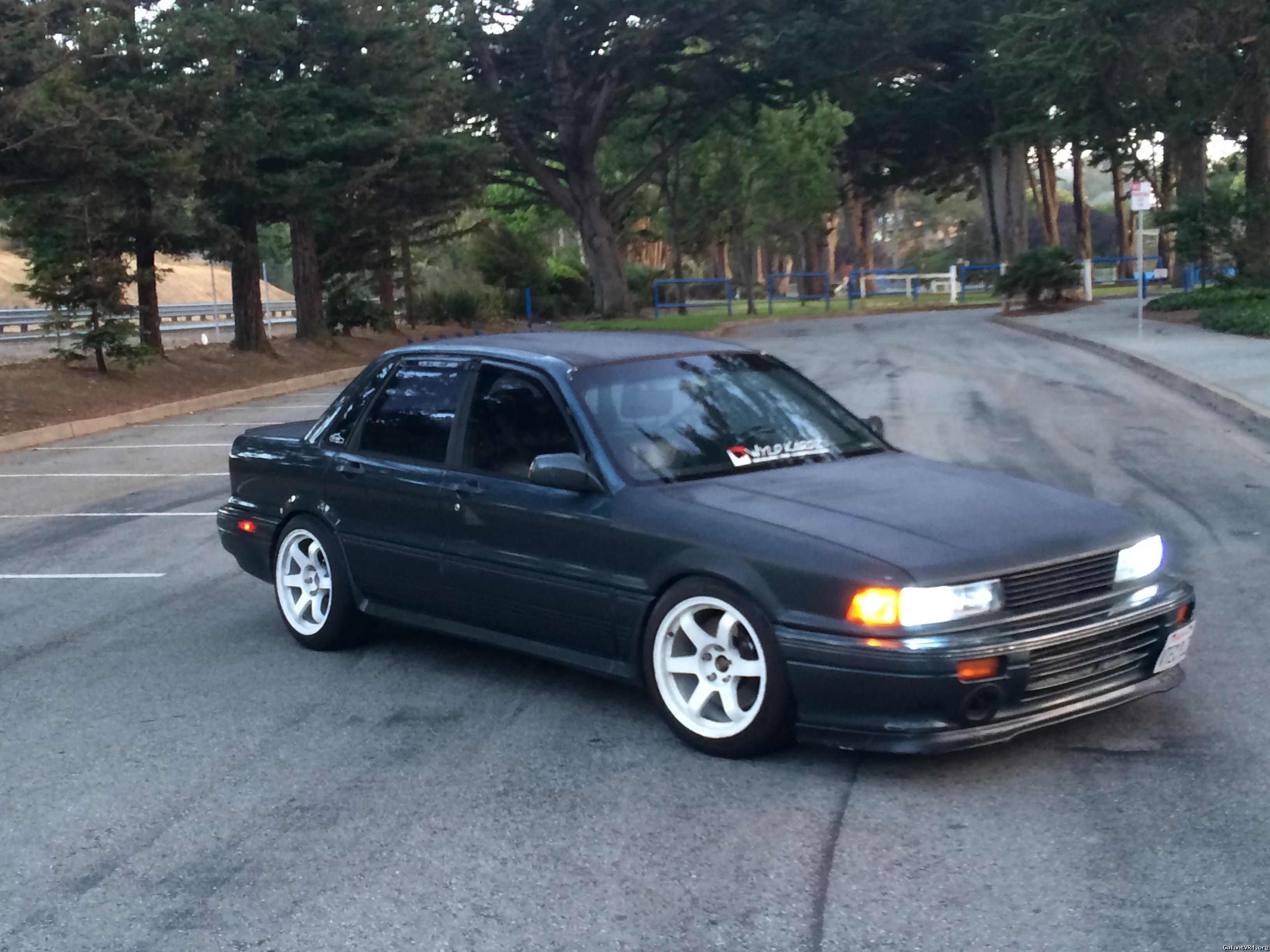

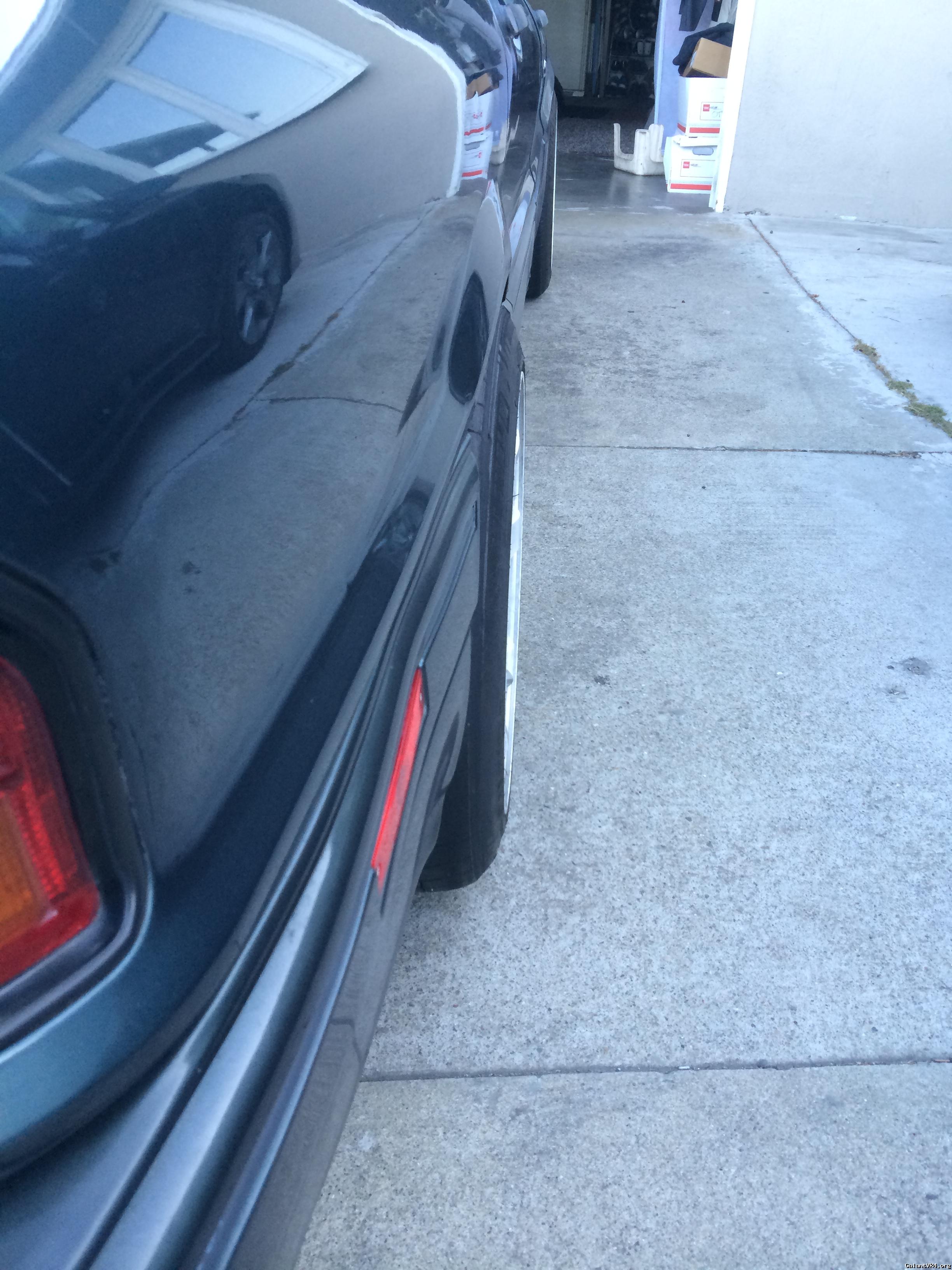

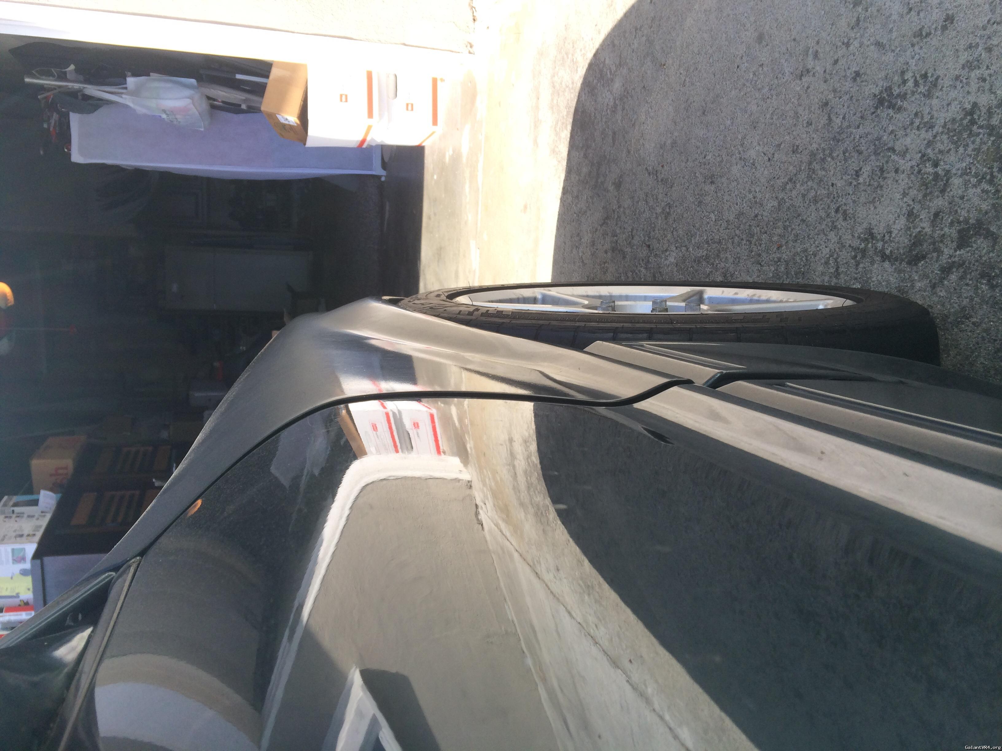

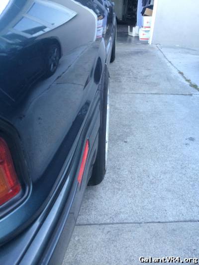

New shoes... 17x9 +20 rota grids on 235 45 17 no spacer on the front 3mm on the rear... Need to raise the car a bit cause the do rub and i want to run 245 40 17 in the future

they weight pretty light considering how wide they are... i didnt really weight them though... but compare to my 17.7.5 kosei k1 they arent much heavier... and the kosei's are light...
I use the same brackets from the dsm tuners brembo upgrade tread... ill update it with the brackets pix when i pull the brakes again to get repainted and rebuilt...

3,473
Can you post up a link to said thread? I've only ever seen a 2G Brembo upgrade thread there.

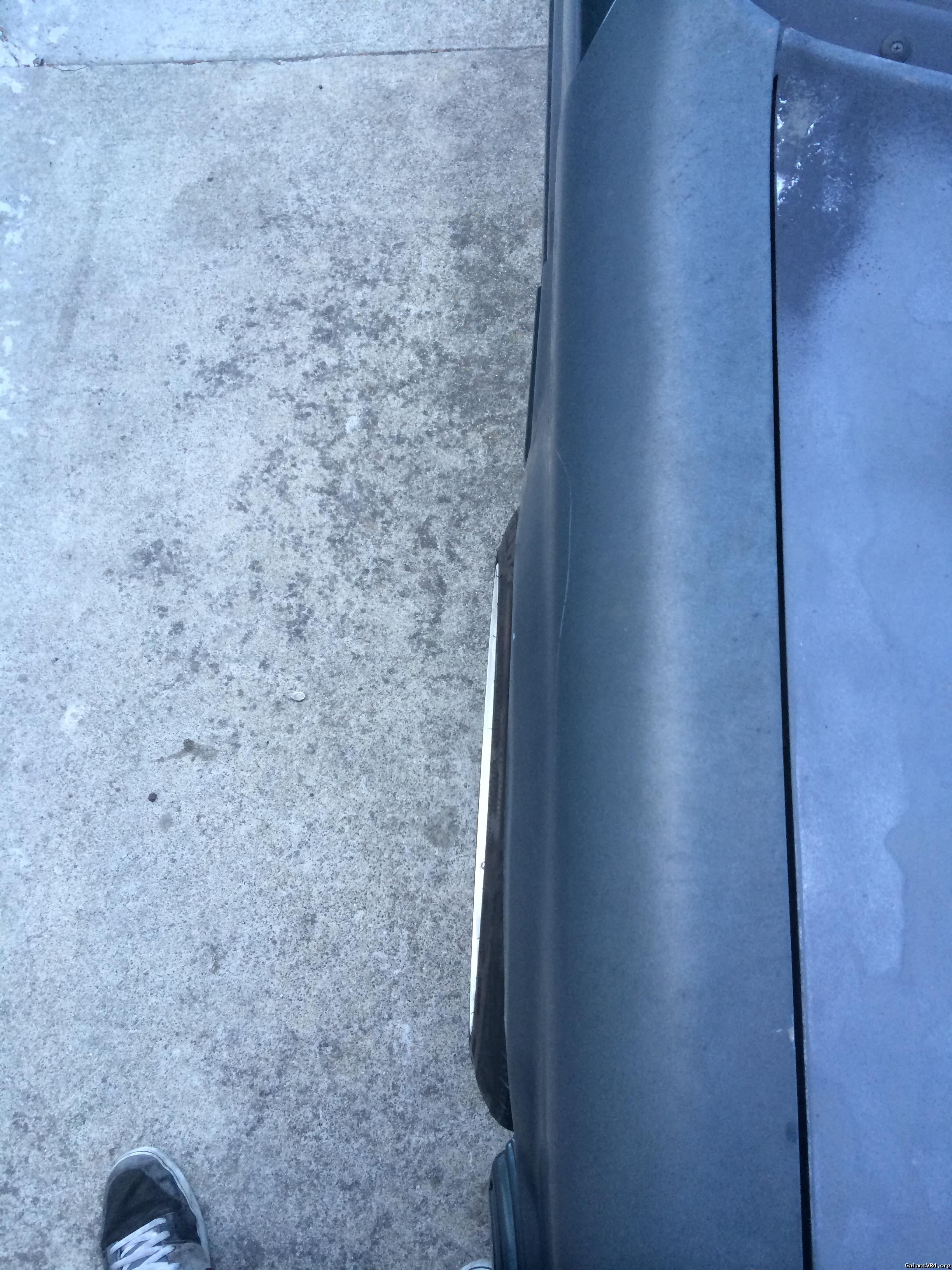

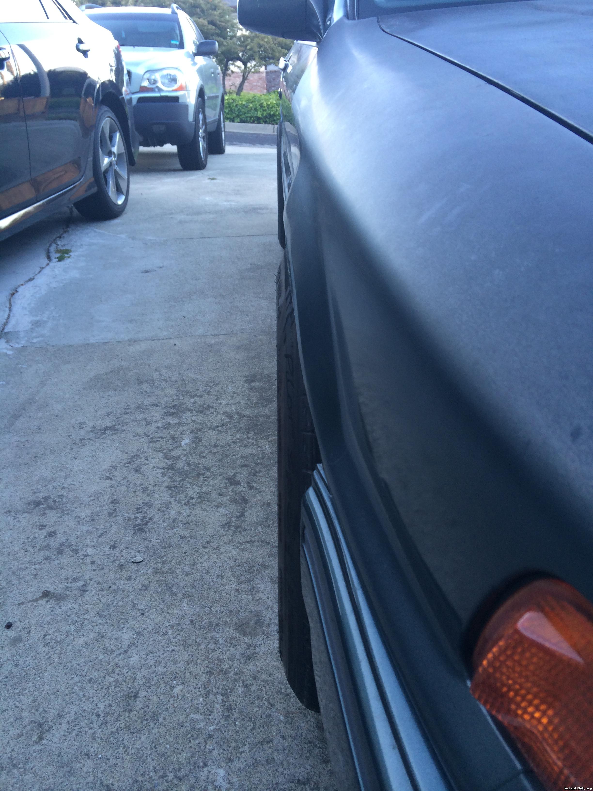

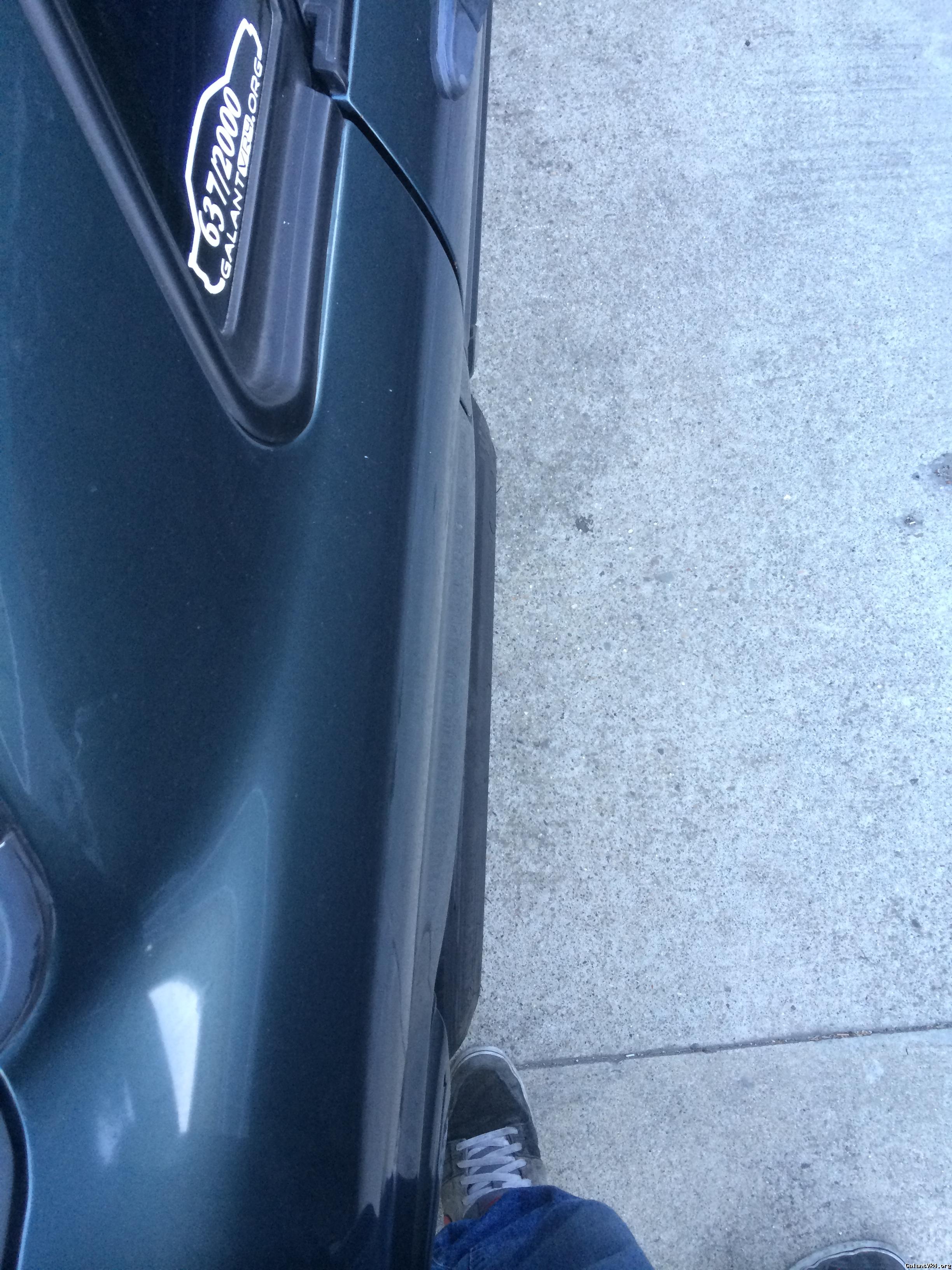

Looks great. Could you please post up a side shot to see how much they stick out. How much negative camber did you have to go with in the front?

What's with the ebay "vortex generator" on the roof?

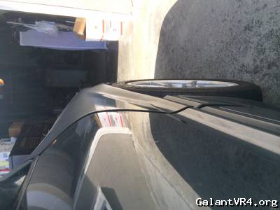

1" spacers were required on the K1's? That's huge. How much clearance was there with the spacer installed?

Drilled rotors was just for mock up it was actually my buddys rotors... Just wanted to see how it would look like...
Yes ive had that vortex generator in there for years... Even before the ebay one popped up... And i like it even if doesnt really do anything... People got different opinion on that... Not much clearance... Maybe 2mm with the spacers...
Im planning on getting some 245's soon and then the adjustable rear control arms to bring the rears in a bit more so they wont poke like that

Looks great! Are you certain that they are +20 and not +25? Why did you use a spacer in the rear? Just to bring them out closer to the front?
I am thinking of getting +25 and run 245/40/17 or 255/40/17.
