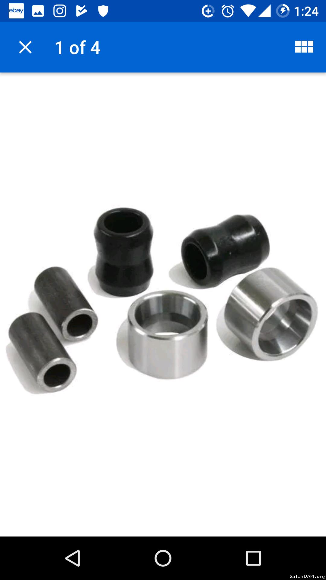

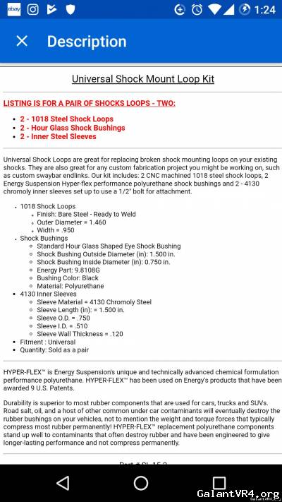

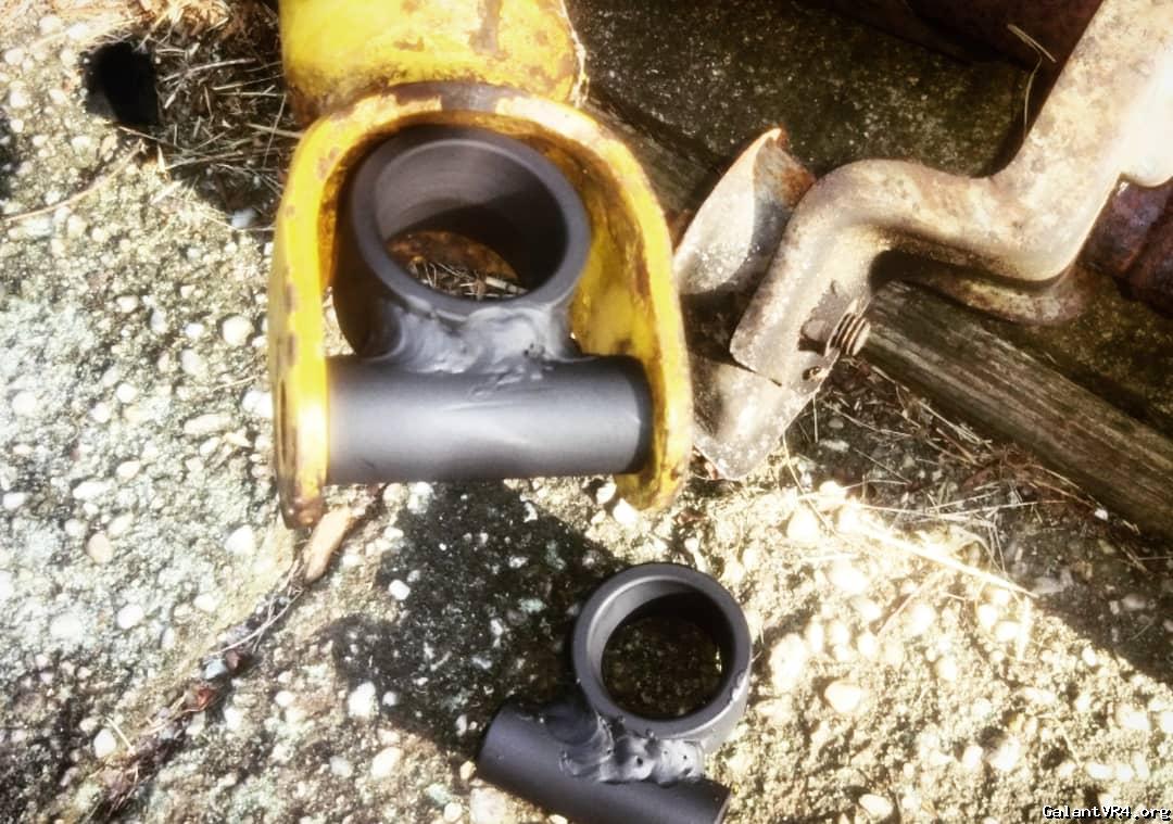

Steve something else you could do and I've done it on something just can't remember what it was.
Tap off the lower mount and clean up the old paint then weld a small tube the same dia as the bottom of the mount then cut to the lenght you want, and take a cartridge roll and dress up the inside if it flowed in during welding. That way your not tacking on the tube and the height will be what you want.
10,992
Looks like a decent possibility.
I think that rear mount bolt is 12mm, so could work.
tektic
Dec 19, 2012
1,497
ronkonkoma, ny
They fit real well. I had to get more tubing for the bolt to go through. $45 shipped for materials.
