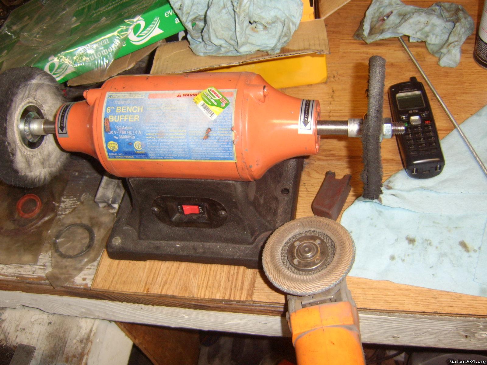

Tools
fine tooth hacksaw
tap (for re-threading)
grinder
buffer
file

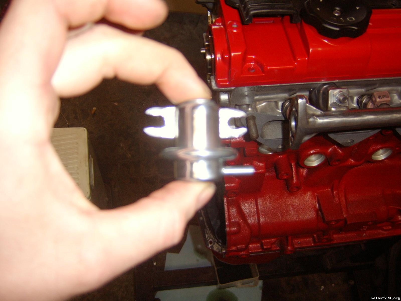

Steps

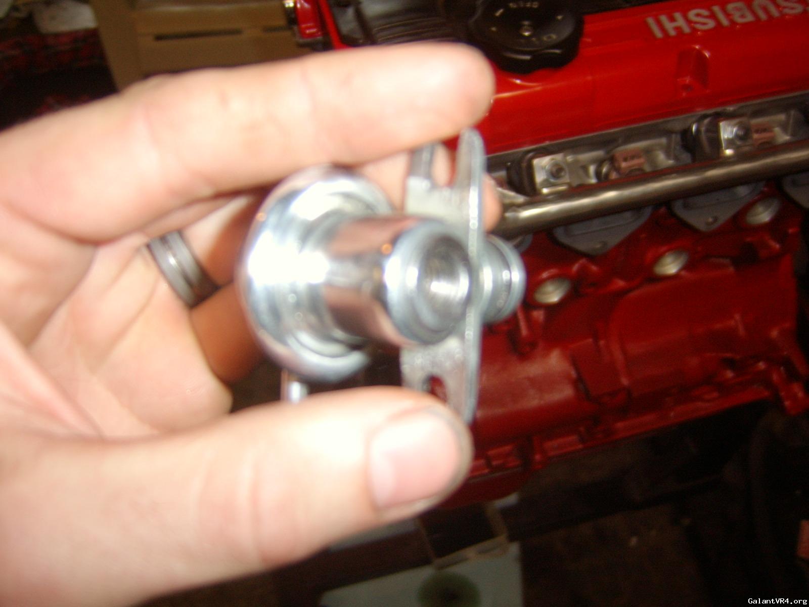

1. remove and disassemble fuel rail completely
2. clean and install the evo 560's in reverse to the dsm's (direct bolt on)*

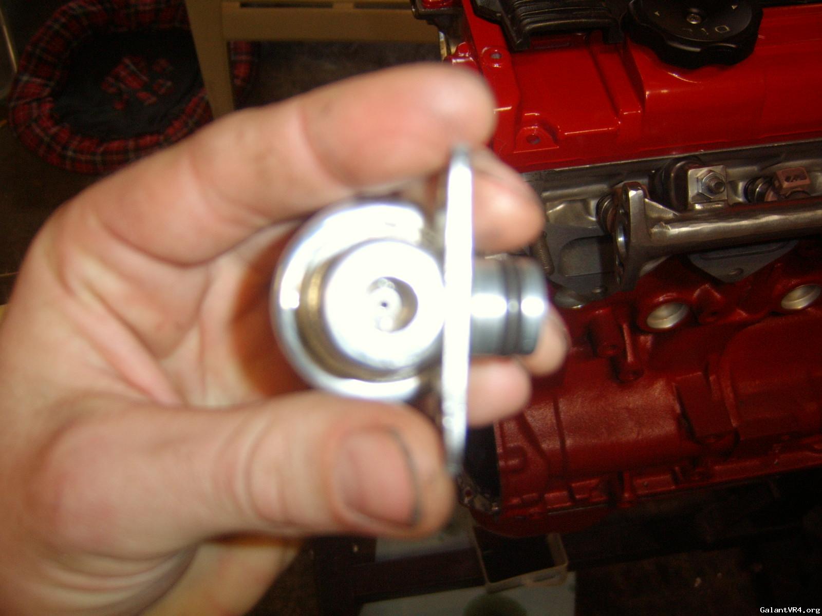

3. cut the return line nipple flush on the evo8 fpr.-(as it is bent the wrong way, also trying to bend it the proper way will kink the tube, trust me just cut it off)
4. drill and tap the return using EXTREME CAUTION NOT GO GO TO DEEP. i used a caliper and measured the depth then measured the drill bit and marked with tape.
5. the flange is a little narrower, so cut "open" the bolt flange's.
6. clean everything very thoroughly and blow it out good.
7. buff it!, or paint it, or?? just make it look nice (don't do it half-assed)

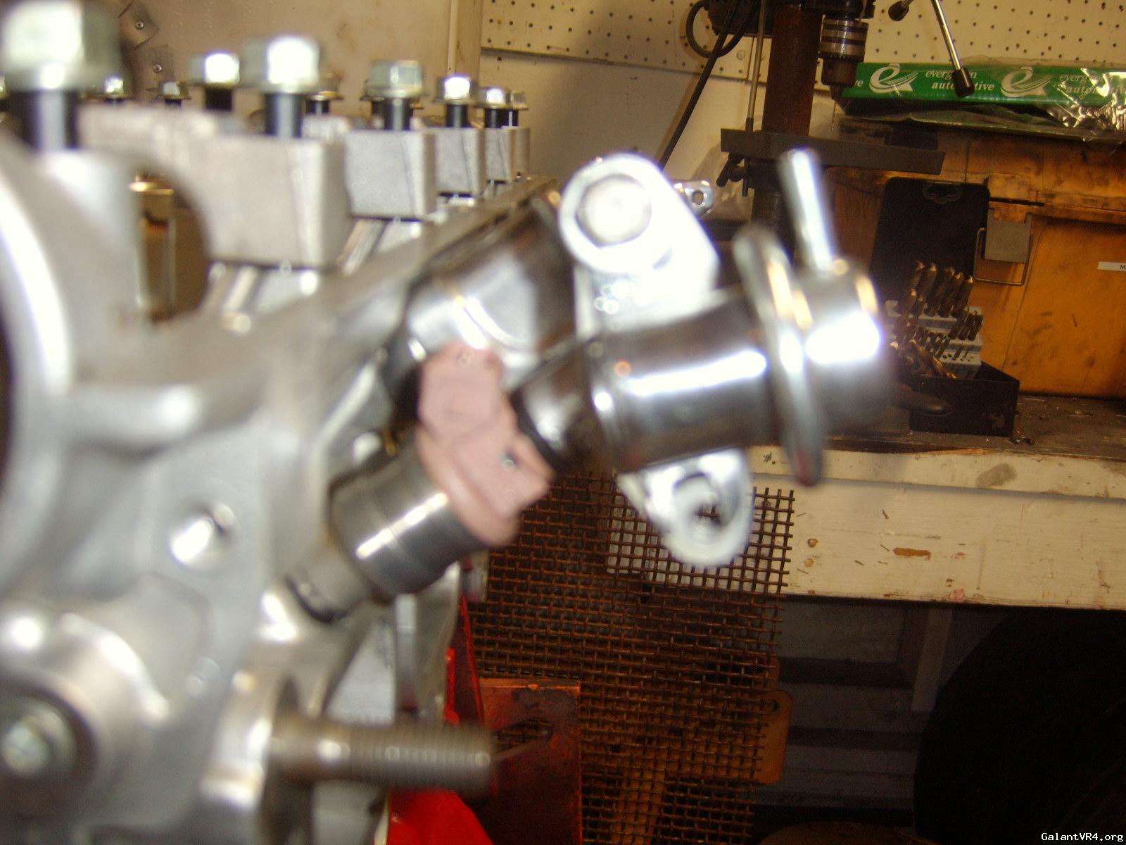

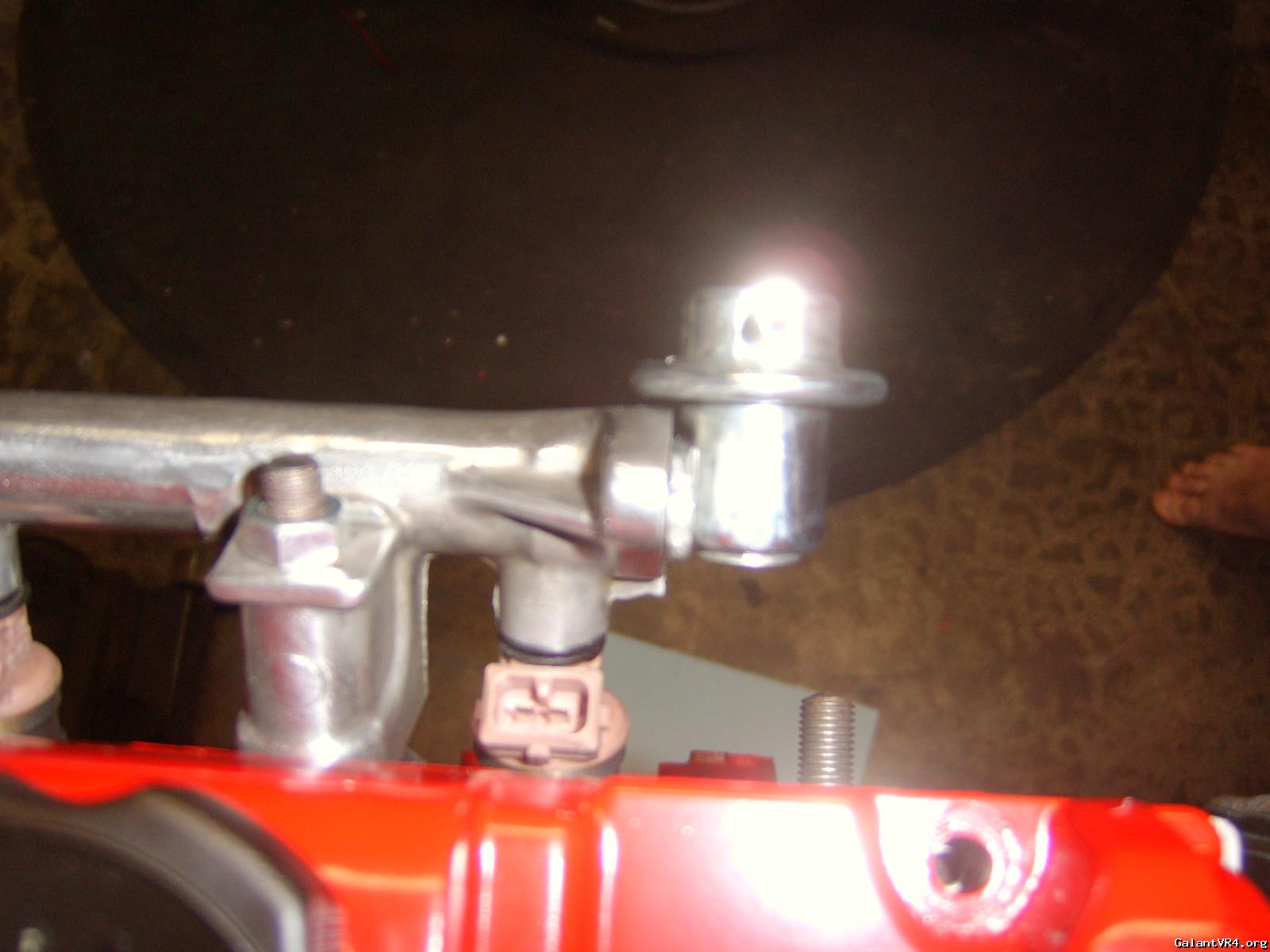

8. install in-reverse to uninstalling using washers to overlap the flange.
9. tune ecu.
p.s. I would,(as i did) replace the fuel rail bolts with studs. I don't know about you, but I strip out those threads way to easily.
