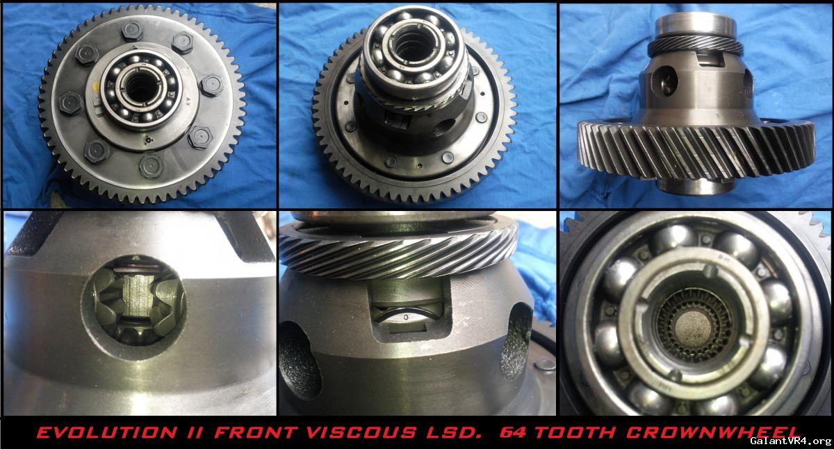

The tribe has spoken.
From the knowledgeable guys on 4gtuners:
Yeah, thats definitely a viscous front LSD guys lol
Here's something I put together some time ago with pics on different angles to show you.
The viscous plates are inside a sealed unit inside the LSD.
But the holes in the sides are to lubricate the diff pinions with normal gearbox oil as expected.[/img]

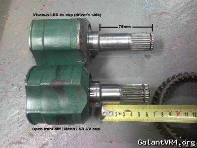

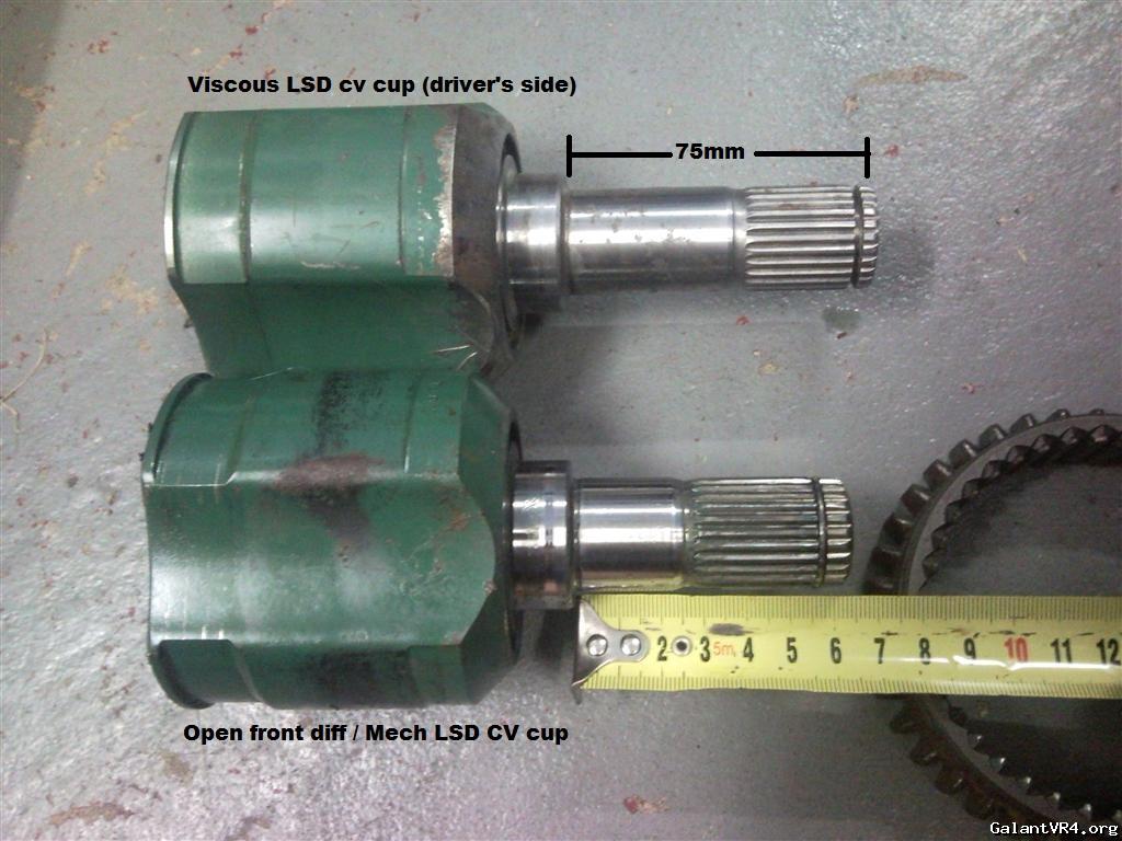

Oh and to the OP, yes you will need the driver's side viscous LSD cup as its a longer shaft.
Here's a pic comparing the driver's side viscous LSD cv cup to a normal open diff/mech LSD cv cup.
The part number of the viscous LSD CV cup is MR166160 and its retail price is around $400!!!
