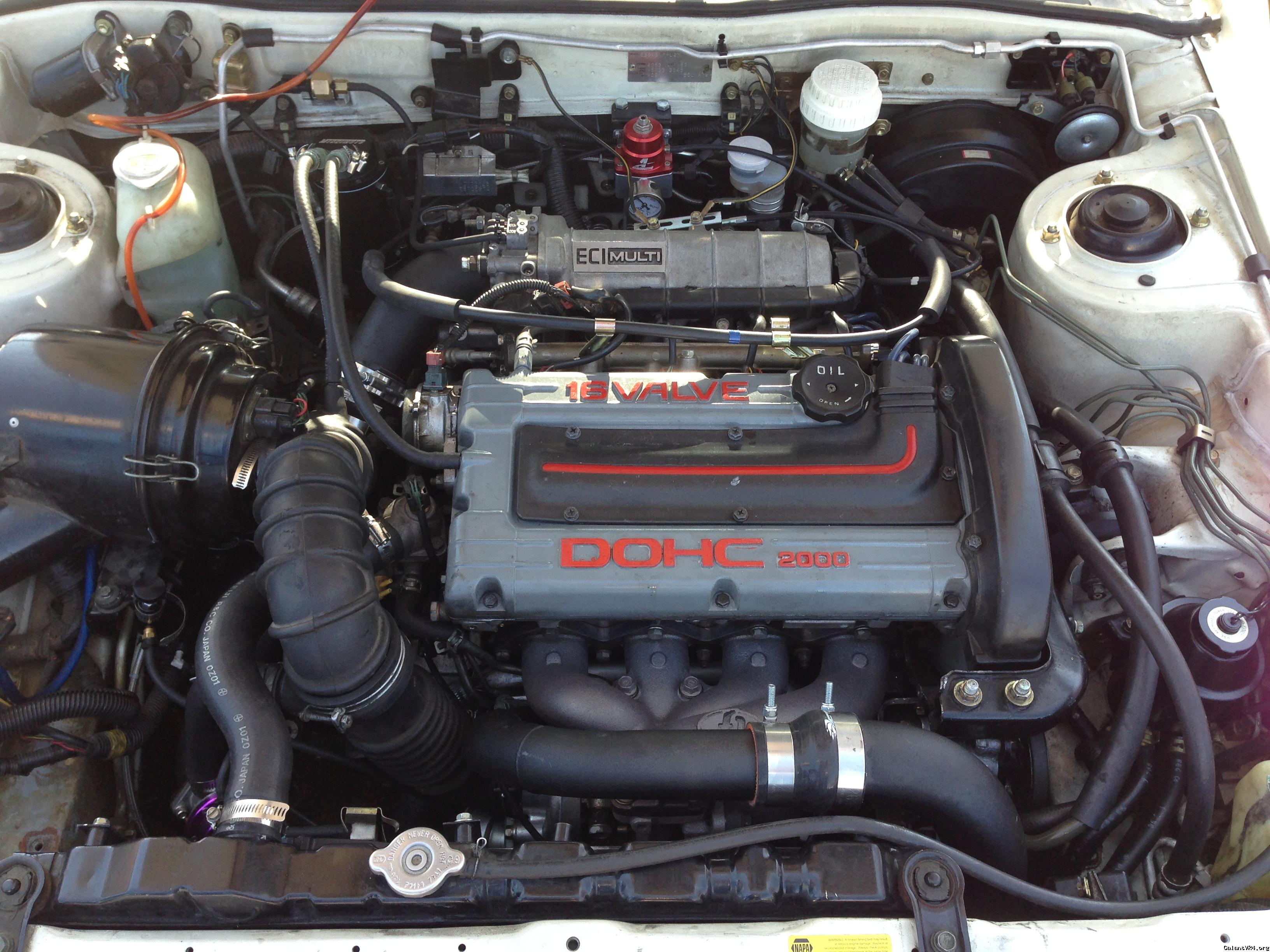

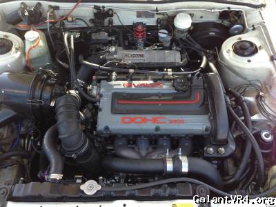

Does anyone have pictures of this kit installed on their vehicle / engine bay with stock air box?
Thanks for all of your help in advance guys!
manikbastrd
Nov 19, 2009
660
I may have some pictures I will look, however, I can guarantee it fits with stock filter and location. Also, a far as cutting, you have to cut the crash bar (metal bit under the bumper cover), as well as remove a plate that is next to the radiator where the stock pipe goes through. A/C is not affected with this kit. The only thing you need to worry about with this kit is bolting it in, and you may have to get some shorter bolts for your throttle body elbow.
