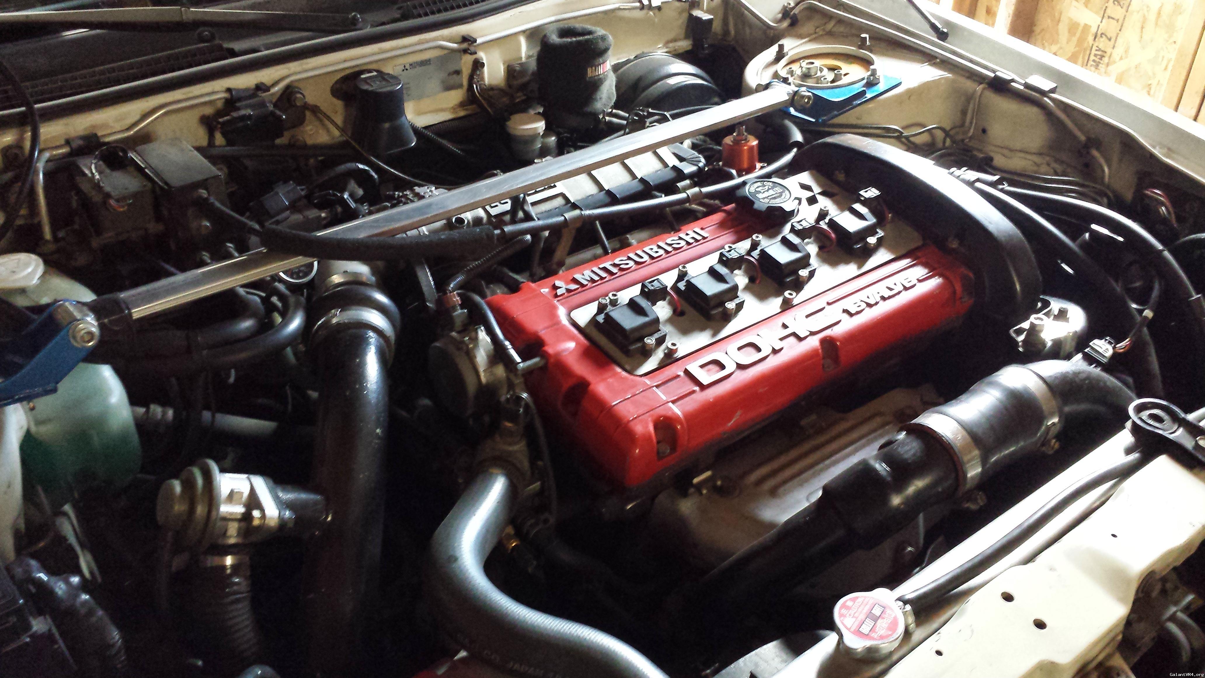

Engine:
ECMlink Full V.3 w/ Custom tune "15 psi" - Harvey @ The Boost creep LTD. in Longmont, CO
Stock long block
272/272 Crower Cams
3g lifters
Autometer Fuel pressure gauge
Buscher AFPR
Walbro 255 fuel pump (re-wired)
660cc injectors
C&amp;R E39A specific Aluminum Radiator
2g "609" MAF &amp; plug adaper
2g throttle body elbow
Hard intercooler piping 2-1/4"
Front mount - unidentified OEM MMC
B16g (ported and clipped)

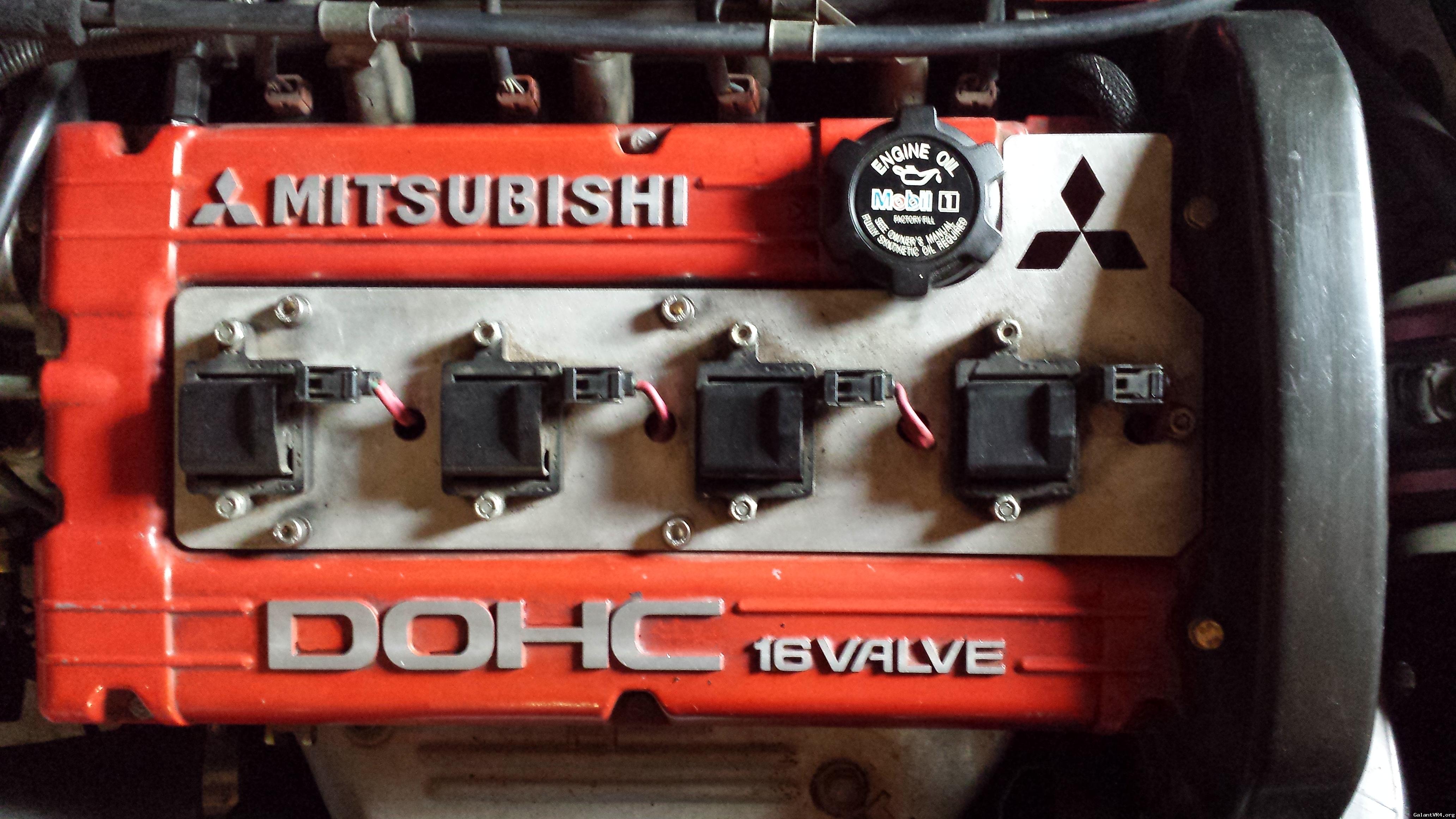

Curtisco COP setup
Balance shafts removed
Evo III ported Manifold &amp; O2 Housing
2G heat shields
Greddy Cast 2g/Evo III Intake Pipe
K&amp;N cone filter
CMPE 3" Mandrel SS Dual tip Cat Back
1g 90' oil filter housing
Genuine RALLI///ART Radiator Cap &amp; reservoir cover
Evo 8 "Mobil1" Oil Cap

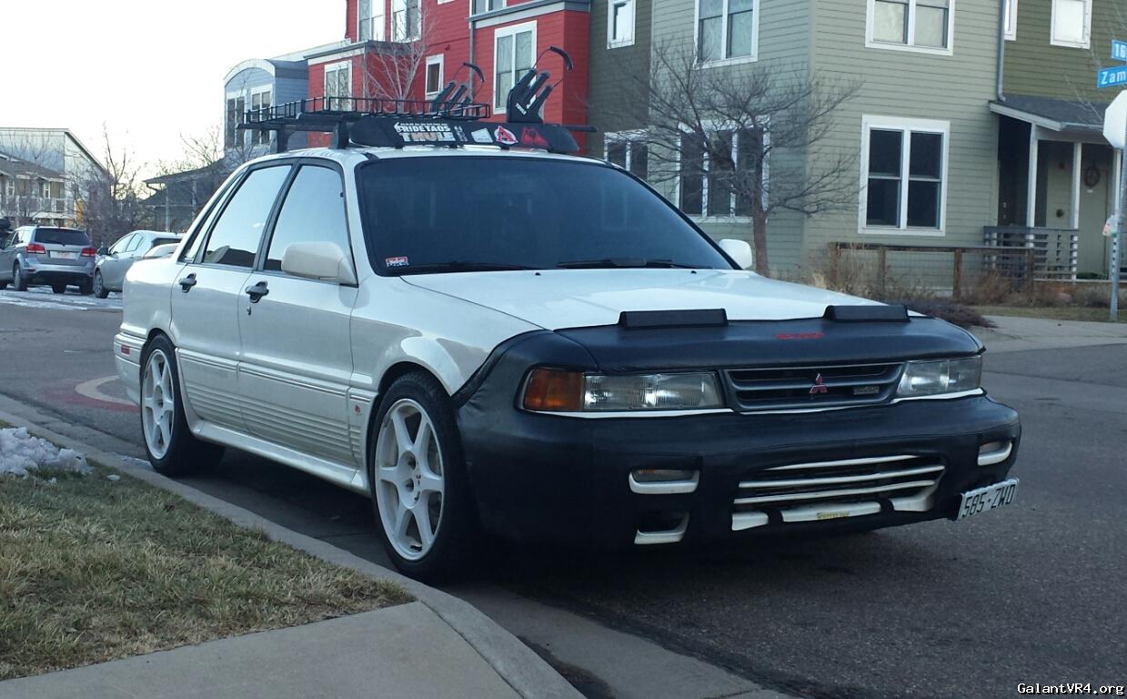

Exterior:
Genuine JDM side decals
Manual Antenna conversion w/ pepboys "Stubby"
removed fog lights/brackets
JDM fuel Door

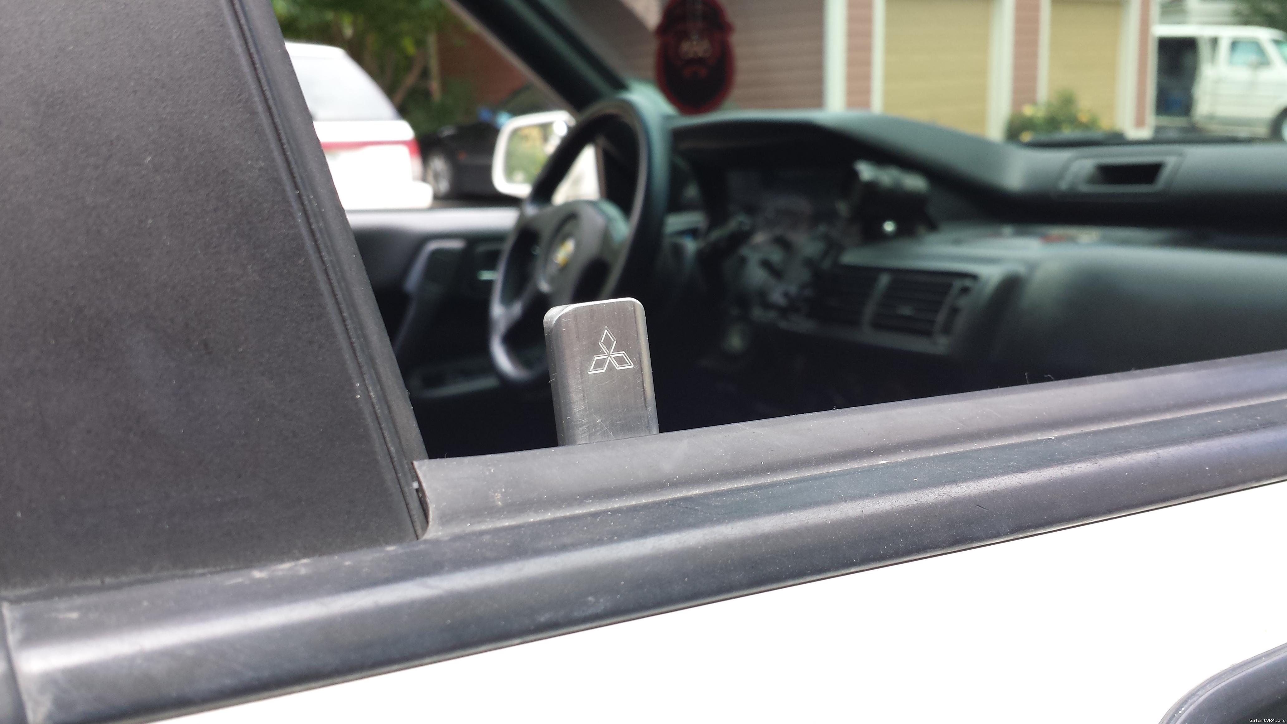

JDM Door Handle protectors
AMG Corner lights
Eterna "Fulltime 4WD" Grille
Mitsubishi accessories "NOS" USDM full Bra
JDM OEM GTO/3000gt rear MMC decal
2007 OEM Galant Ralliart decal
Thule Roof Rack
OEM rear mudflaps

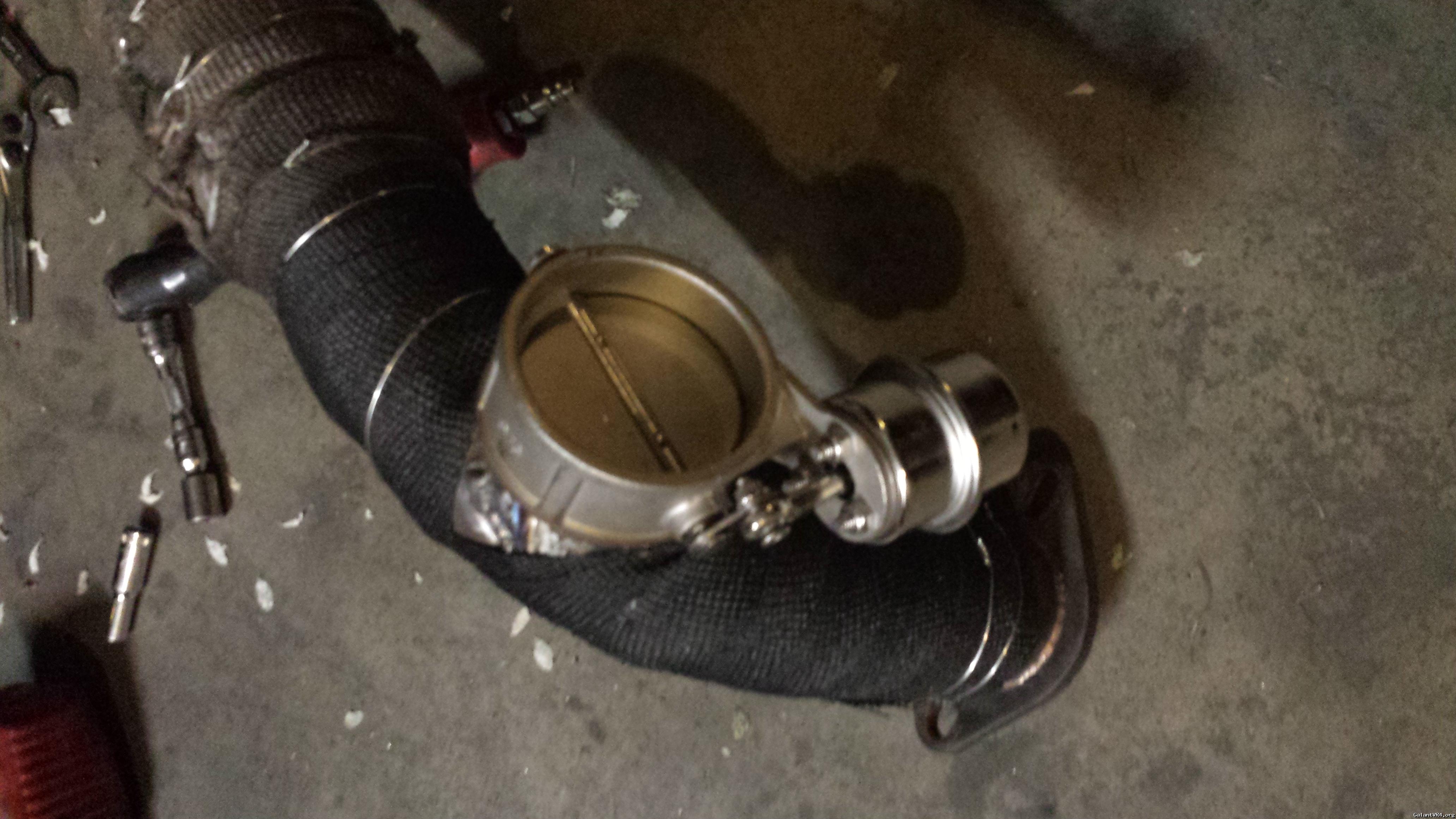

3" Boost activated dump valve (~6psi fully open)

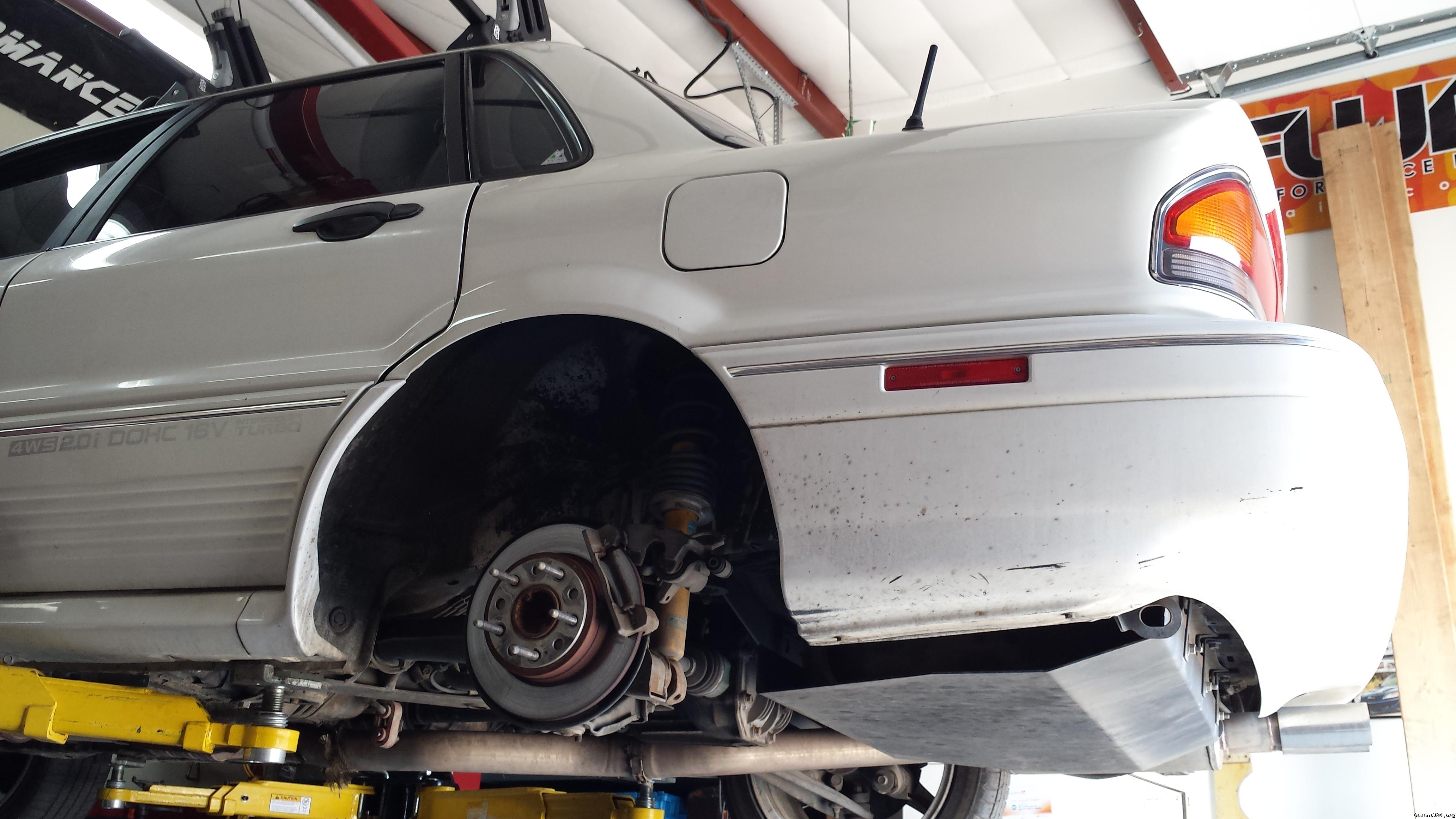

B2autodesigns FR&RR Skid plates - powder coated black

Allstar Performance catch can
Zaklee clear cam cover
