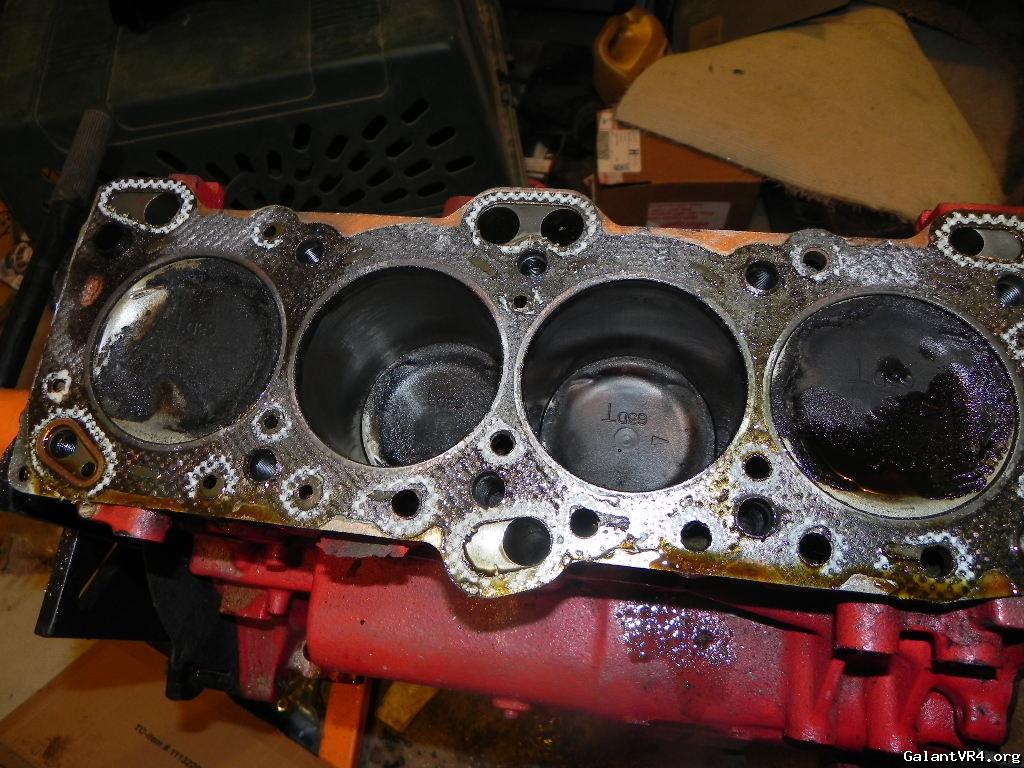

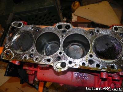

I took it apart tonight and here is a picture of the top of the pistons. This is after about 5000 miles. I know carbon build is normal but that seems like a lot. I am running e85 and I did notice the typical goo on the injectors but not as bad as I've seen. Many of the bolts were awefully easy to untighten I think do to the excessive vibration. Any thoughts on this picture?
