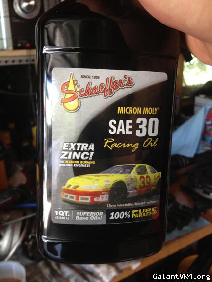

Machine shop recommended using this for a break in oil.
They also recommend moderate driving for the first 500 miles with varying rpm on low boost. 5 lbs. Then change oil and drive regularly.

There are a million different opinions on how to break in a new engine. Personally, I have broken them in slow (500 miles, varying rpm, no long, steady runs), fast (car needs to be on-track tomorrow), 200 miles of highway driving in one trip hours after re-assembly, etc. I really think that after the first 30-60 minutes of running, all the new bits are familiar enough with each other, so I generally break it in how I am going to run it. I do like to change the oil after the first 500, and for that reason I don't use expensive oil right off. My suggestion is to do what you think seems reasonable and logical, there really is no wrong answer.

This has been recommended as well. I will be using some off the shelf dino oil for break in as I plan on changing the oil at 200-400-600.

I like to use rotella oil. It's cheap as hell, works great and has a good amount of zddp in it. Did I mention it's cheap? I don't even bother with the synthetic stuff. I've seen it used in plenty of high power builds and never seen an oiling failure with it.

Thanks for the info guys. As far as synthetic, the one thing that is common across all ways I have seen is they all say not to use synthetic to break in.

Yea, no Synthetic (or even a blend) until 1k miles at least. I usually do a change (+1 about Rotella is good oil) after a few minutes, a hundred miles, 500 miles, then my final swap to whatever I want to run at 1k miles.
