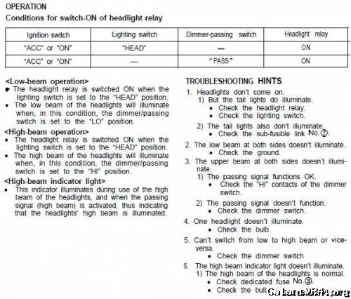

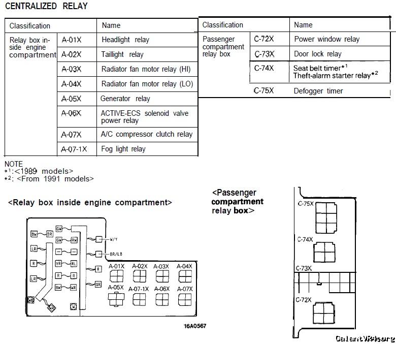

I see the diagram, but where is the headlight relay and other components located? only relay in the engine fuse box is tail lamp relay and it test fine. I can send 12v to the green/white parking light wire and they come on, they just dont come on with the switch

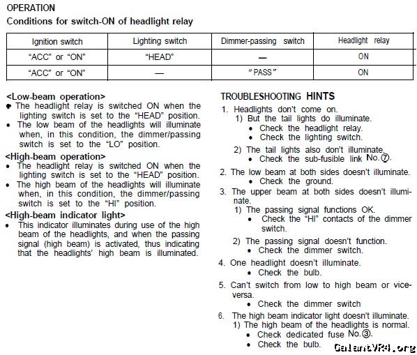

click to enlarge the images...
A01X is the headlight relay in the relay box behind the battery...
troubleshooting...
