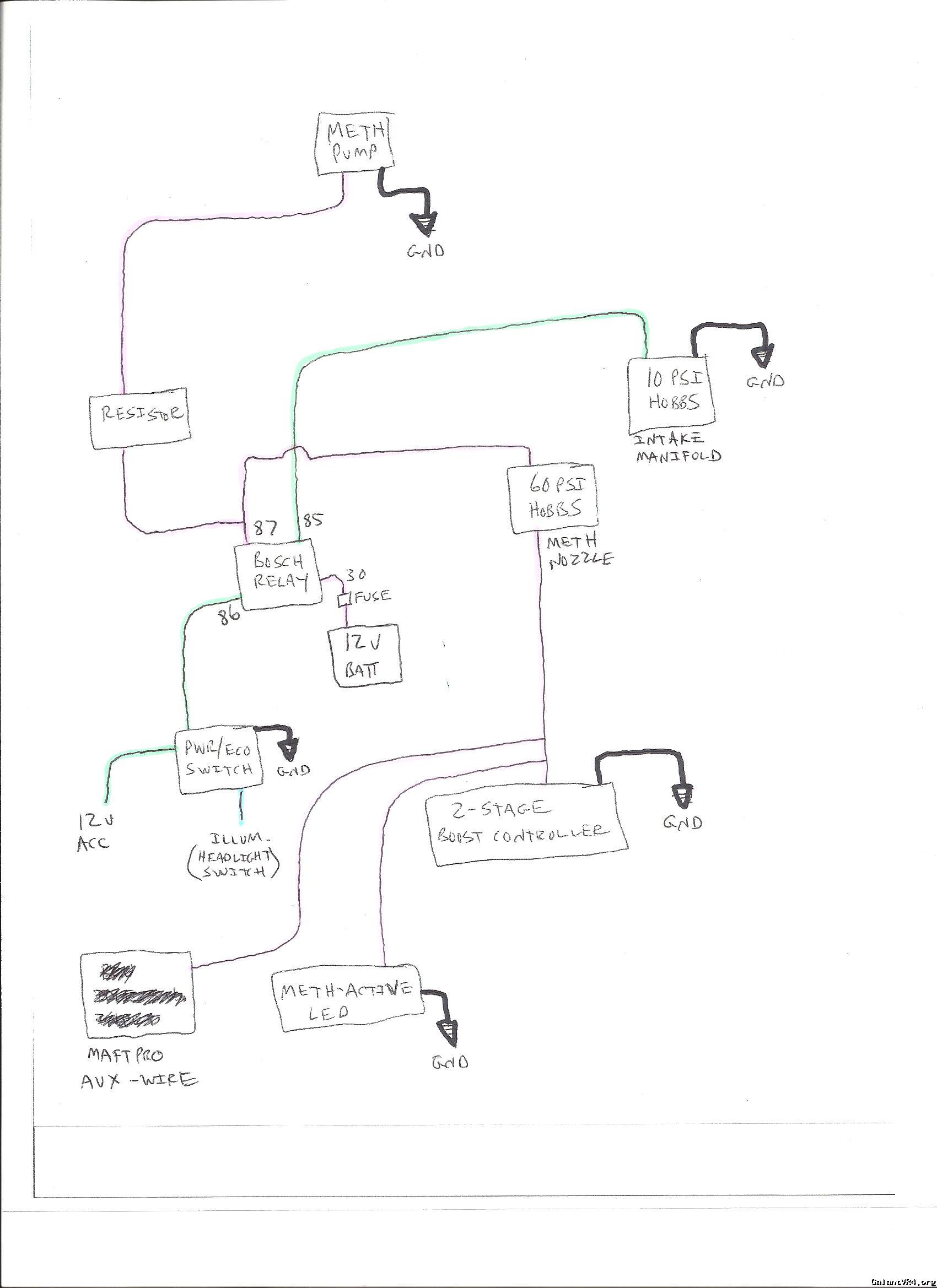

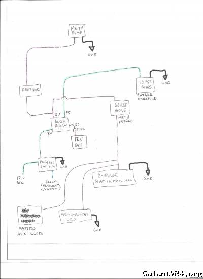

This is a pieced together English Racing meth kit. If you're wondering, the resistor is so that the pump doesn't see full 12v. I guess it's not good for the pump to see that much voltage over time and it's not required anyway, as per Lucas' directions. Or it was too much pressure output. I can't remember. Whatever it was, using the resistor was his tried and true method to this setup so there it is. The 10psi Hobbs switch completes the Pwr/Eco switch circuit, allowing power to flow through the relay to power the meth pump and also sends 12v to the 60psi Hobbs switch. Once that switch sees 60psi meth pressure, it allows 12v to flow the two-stage boost controller to raise boost, as well as to the Maftpro to switch to the secondary fuel/timing map and sends power to the LED to let me know meth is spraying. If that 60psi Hobbs doesn't see meth pressure due to a clog or empty tank, everything reverts back to lower boost and regular fuel/timing maps, hopefully saving me from ending up with a hole in the engine block.
Old setup:
New setup (I think):

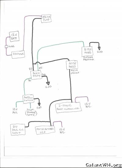

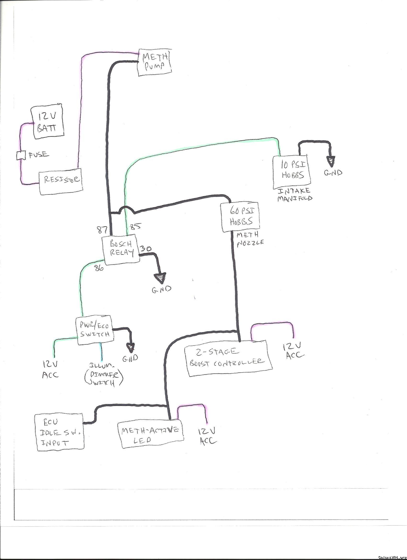

Did I correctly draw the new diagram? Thanks!
3,473
Looks straight to me. The only thing I see is that the line between terminal 85 and the 10PSI Hobbs switch would actually be a ground circuit instead of a power circuit like you drew on your diagram. Does't really matter though, because it will still work; it's just drawn wrong.
-Eco/Power switch acts as an arming switch and provides 12v to 86; coil of Bosch relay.
-When manifold sees 10PSI boost pressure the 10PSI Hobbs switch completes the Bosch relay's coil path to ground, activating the Bosch relay and meth pump.
-Meth pump pumps, and when 60PSI Hobbs switch sees 60PSI, it then completes the path to ground for the 2 stage boost controller, meth LED, and ECU; all of which have to go to ground back through the Bosch relay. The boost controller, meth LED, and ECU would be ground side switched, ultimately reaching your goal by providing your ECU's idle switch circuit with the ground signal it is looking for.
Hopefully what I said sounds right, and mirrors pretty much what you explained. Just wanted to bounce my understanding off you to double check what you already know. The circuit looks sound to me. I can't think of a more simple way to make this work given the safety features this circuit provides. Honestly, I'm probably going to use this myself when I install the snow performance meth kit I picked up. Are you using any kind of progression for your meth injection, or is it fixed? I'm interested in how you have the vacuum routing set up for your 2 stake BC, and at what boost levels you are tuning your meth injection to. Some more info on what kind of meth pressures, boost pressures and nozzle sizes you are using would be cool when you have time. Also, do you know about how much voltage is getting to the pump with the resistor in line? Hope this helps man.

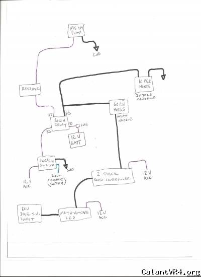

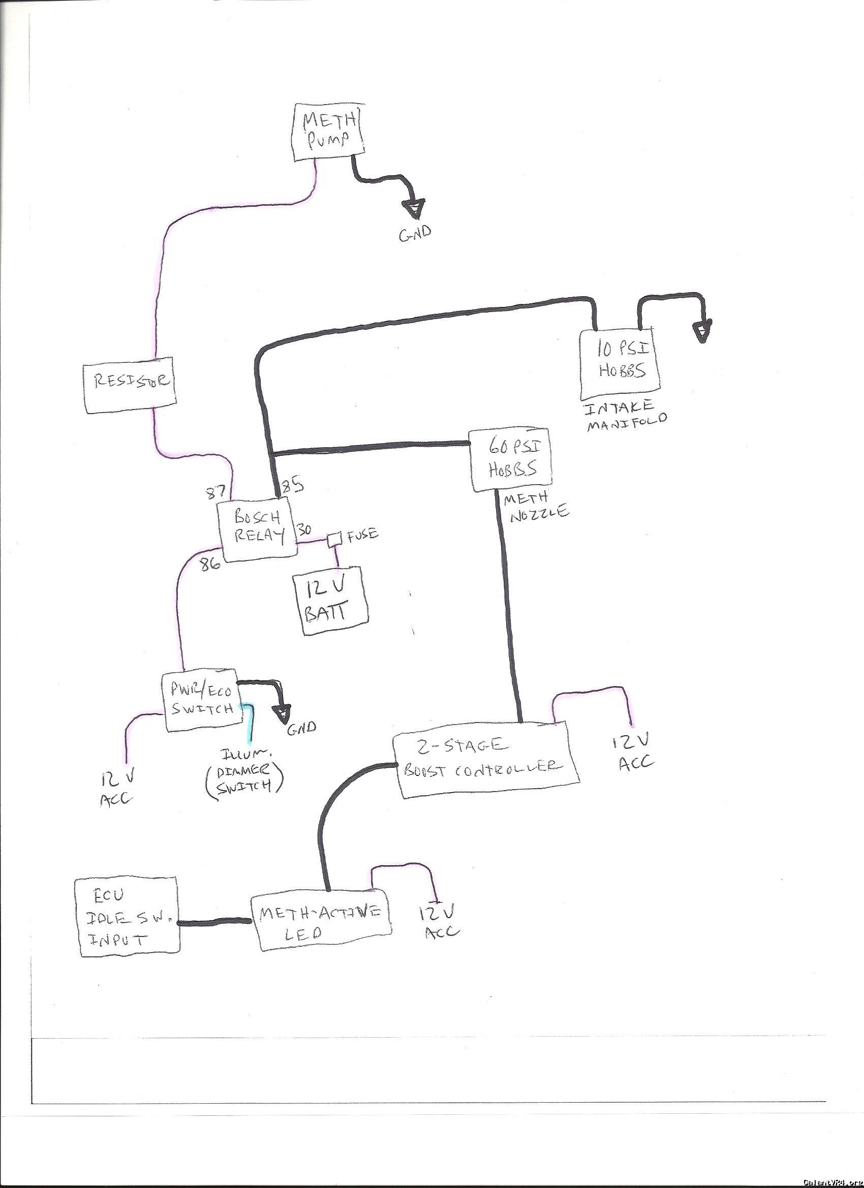

After looking over this again and having GST correct my original diagram's terminal 85 being a ground, I think I found an easier way. I can just pull the ground from that and keep my pump wiring the way it is. Even though the ground circuit won't be run through the relay, the safety still works because if the 60psi Hobbs switch doesn't see 60psi meth pressure, it won't flow the ground signal to the boost controller, LED, or ECU. This means I only have to change a couple of things. /ubbthreads/images/graemlins/smile.gif
Here is the new diagram:
I think this will be the easiest way. Anybody else see a problem with it?
3,473
Yep, still looks legit to me man. I'm not really fimiliar with the actual physical wiring configuration you got going on, but I does seem like less changes would have to be made with the last diagram you drew. Essentially, the only thing you are changing is where in the circuit the 60PSI Hobbs switch is going to ground. Whichever point is easier to T into would be where I would make the connection. Either way, the 60PSI Hobbs switch can't go to ground until the 10PSI switch is activated in both diagrams you drew. So you are still good to go with the last diagram from everything I can see.
