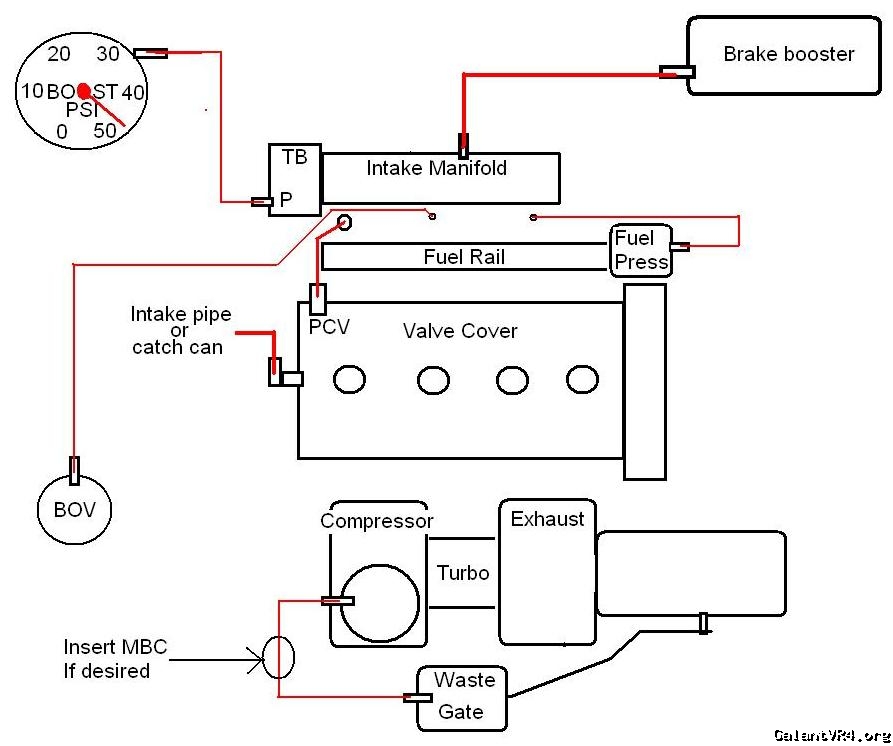

You only need:
PCV to intake (stock)
AFPR to intake
BOV to intake
WG to intake or output of turbo.
Boost gauge to "P" port.

On mine i have manifold -> afpr, manifold -> brake booster, and manifold -> wg/bov/mbc. You'd probably want a boost gauge in there as well, just don't tap it on the afpr line.
