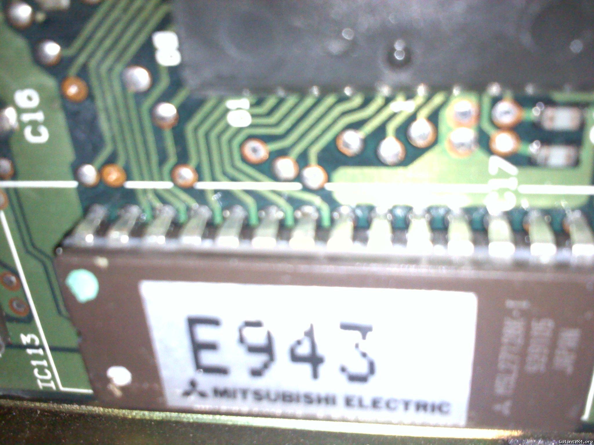

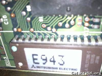

1. THIS is normal eprom right not socket ?

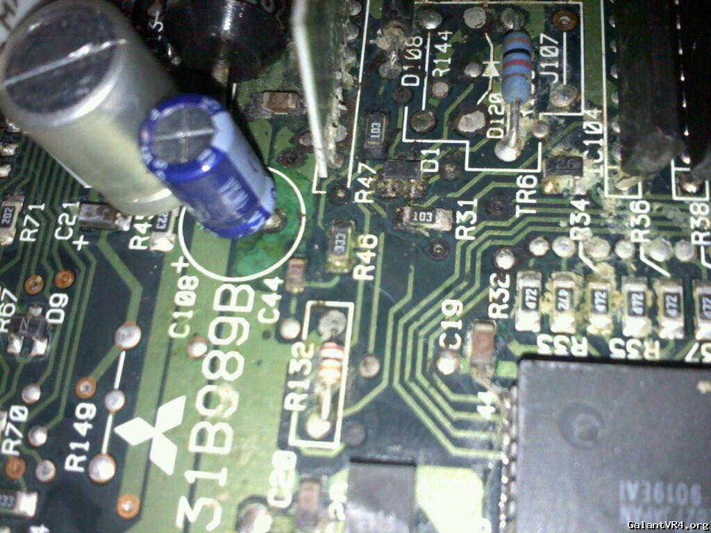

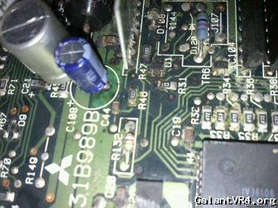

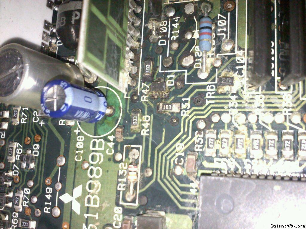

2. THIS is damaged ? it looks dirty and like something leaking middle right?

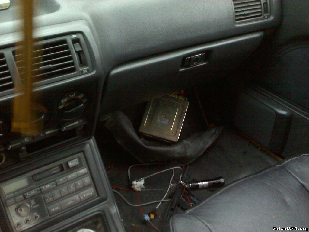

3. this is not stock location for ecu right

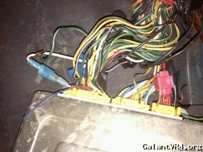

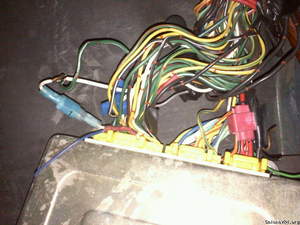

4. the wires from the back of ecu ,looked hacked up RIGHT?

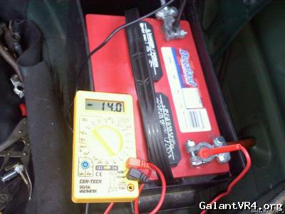

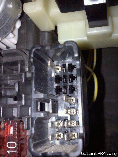

5. diagnostics connector right next to fuse box under dash , looks broken (missing pins)

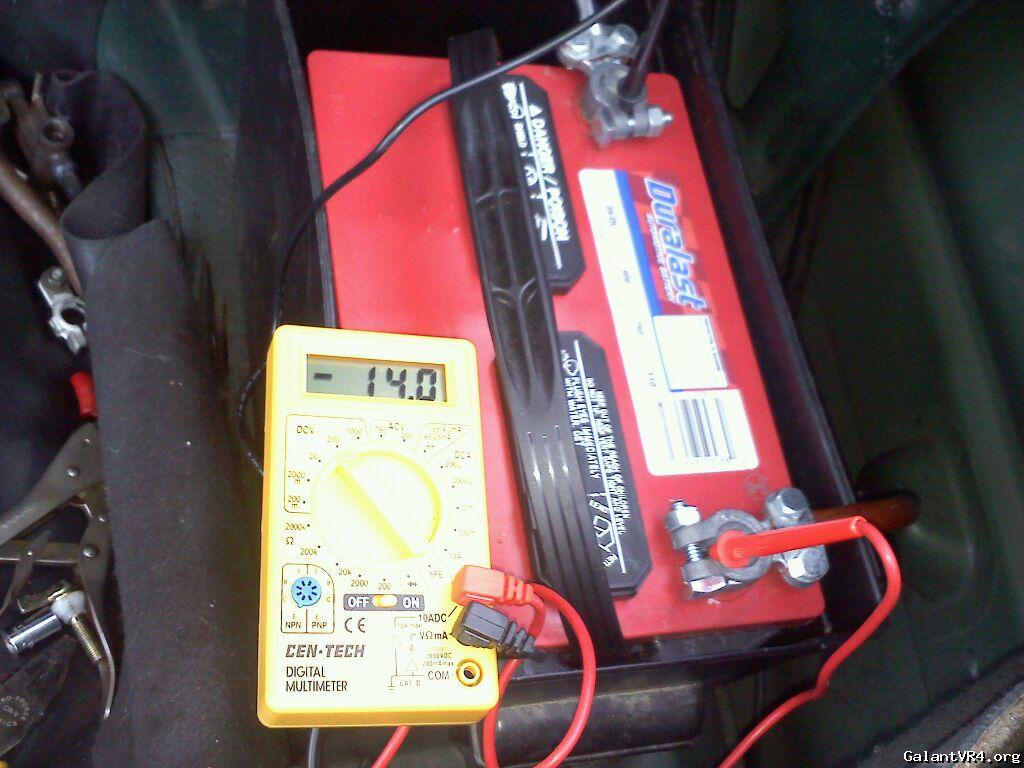

6. battery at 14v when car is running

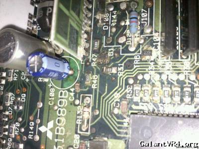

7. another pic of possibly damaged ECU

Non socketed Eprom - yes.
Damaged board - yes.
Stock location - yes.
Hacked wiring - yes.
OBD port looks fine, it doesnt use all the pin slots.
14 volts while car is running is good. Range is usually 13.6-14.4

could hacked wiring point to it had some kind tuning equipment and PO stripped it of everything and it lost tune

stock ECU is bolted to the A pillar to the right of the glovebox.
It looks like that capacitor has been replaced before, perhaps the leaking fluid on the board wasn't enough to damage the ECU, however it could indeed be a damaged ECU. I would try another ECU to eliminate the possibility of being an ECU.

The ECU needs to be cleaned really well to get all the old acid off it. Otherwise. it will continue to eat the board.
Send it to me and I will socket and clean it. Also will replace any bad caps if needed.

The ECU slides up into a slot beside the glove box. The two black rubber feet go up into holders and the two bolt holes line up with a stud and bolt hole and are fastened with 12mm nut and bolt.

Good running voltage, proper diagnostic plug, hacked wiring but as long as it was put back together properly, it should run as stock.
With a socket, you can get a chip to allow you to run bigger injectors, better MAS, remove fuel cut, etc...

A non-eprom ECU will do exactly the same thing as an eprom ECU except you can't easily swap in a new chip to change the parameters of things like injector size, larger MAS, knock gauge feature, AC cutout, improved highway mileage, etc...

Good Luck with the ECU...I am new to the VR4 game but not circuits...family business is TV repair shop and we do all in house trouble shooting of boards so I've seen PLENTY of caps go.
The board will be fine...but the cost to repair the parts is what might get you. There seems to be a lot of damage over a widespread area...which I don't believe that cap on there could have done. Maybe an originally failed horribly, which is when they tend to explode (not violently but acid does get a little more spread out or with time) I would investigate to see if other components went, or where else on the board there is damage. I'm sure whoever is willing to fix it will know once seeing it real fast.
I noticed a few smaller transistors that look like they are in pretty bad shape..maybe a good cleaning will fix any shorts.

That's pretty significant corrosion damage from the original capacitors leaking. The board needs to be stripped down, cleaned to bare copper everywhere it's corroded before replacing the damaged SMD parts and new capacitors for the power supply.
That could easily take the good part of a day to do well. I've fixed worse when I was repairing ECUs so this one should be repairable and work good as new after but it's going to need quite a bit of attention.
The wiring harness looks like the OP might have had a SAFC installed before. The vampire taps should be removed and the wires inspected/spliced if they are damaged.

The hacked wire on your ECU cables could be from someone that wanted to harness into the ecu with their tuner like (SAFC,SAFCII,AFC...etcetc)
Replace your ecu or its toast... if it turned over your lucky, that's a good amount of acid on that board.
