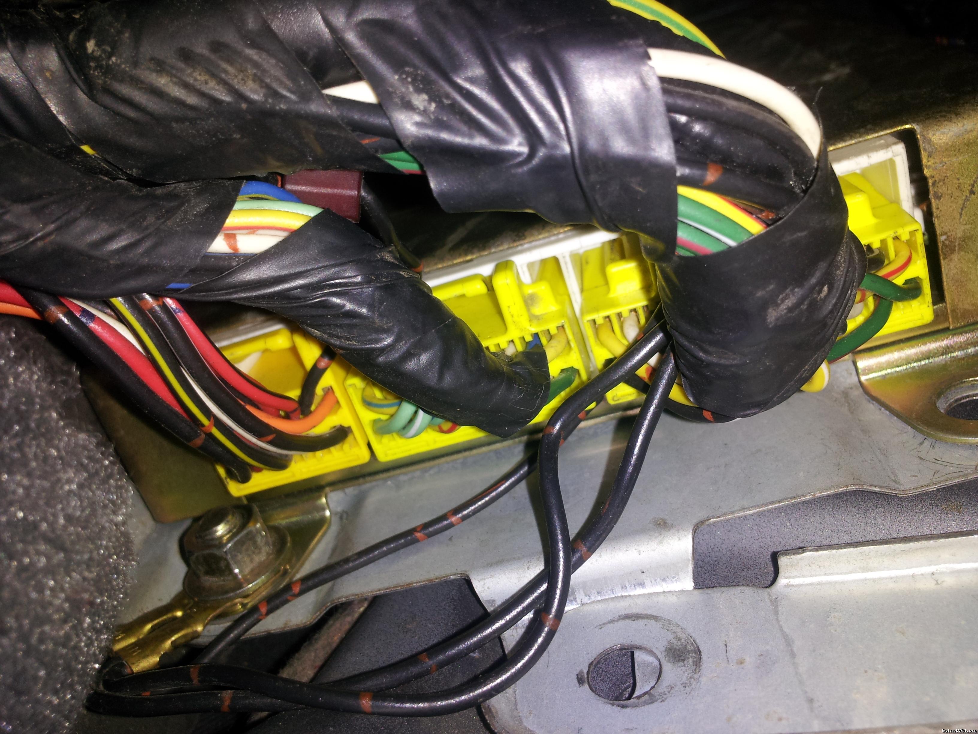

I'm bringing this question back guys. This problem went away but it came back with a mean ass vengeance.
This problem has gotten to the point where the car is basically not drivable, almost every bump in the road causes my ears to hear the wretched clicking noise and those same bumps cause the CEL to flash along with the anti-lock light now. I took the ecu out today and looked at the board. Nothing changed from the last time I checked it.
Here is what the set up looks like. That wire is grounded via that bolt on the left. Someone please tell me this is something silly and a super easy fix, if not, I guess I'll take a look at the parts toybreaker told me to in the first place. /ubbthreads/images/graemlins/banghead.gif The mods know all.

Apart from the grounds, i would check 12+ voltage too at the ecu pinouts. You lost your radio stations without unhooking the battery means the 12+ voltage to the radio was restarted. Perhaps its not getting good voltage. Same could be for your ecu if the voltage source is the same. So i would also check 12+ volts to the ecu.

ill second battery terminal, i had bought new battery terminals for my car but they sat a little higher than the stock ones, becasue of this they would hit the hood sometimes on a hard turn or bump and would short the system out and casue the same clicking sound your hearing(would also restart my radio), just my experience(may not be right but just trying to give back to the community that has made owning a gvr4 a reality so thanks everybody)

Well, just like the last three postings suggest, it was battery related. As I was imitating a contortionist while playing under the passenger side dash, my dad came to help me and the first thing he does is ask if the battery is ok. I say, yeah I just got a few months ago from Sam. (Sam is my brother, works at NAPA.) We open the hood and low and behold, the positive terminal is finger loose. /ubbthreads/images/graemlins/banghead.gif
