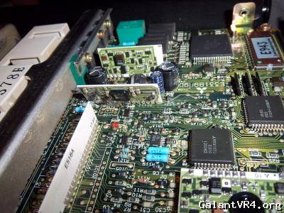

Okay got the ECU out and didn't get run over (Big plus because I was on the road side of a one way street DT Denver) Got a couple of strange looks, I'm assuming because of my Black hoodie and flashlight...
Here are a few pics...

Ecu looks to be in really good condition, if you have it repaired (caps replaced) you should be good to go.

Plan to keep it looking good, also looking into getting it socketed for ecmlink v3...

Some clean up, a new set of caps, and a socket...and you'll be good to go /ubbthreads/images/graemlins/cool.gif If anyone needs ECU work done, hit me up!

You got lucky the corrosion isn't heavier. Get the acid neutralized and CAPs replaced stat.
Then life will get a little better.
