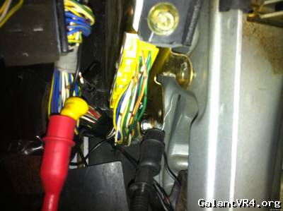

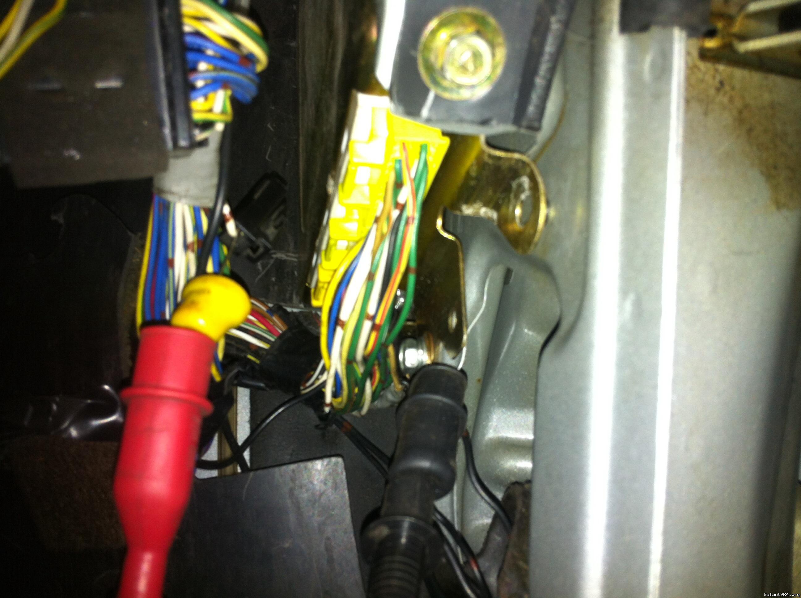

Got some trim out on the way, in the cabin near the rf lower kick panel, and going the 02 sensor test plug.
Jammed a thin probe inside and attached my multimeter (set to AC volts), and proceeded to start the car.
Sensor voltage came up slowly within a few seconds and "stabilized", at 0.020v. So, hard wire condition confirmed.

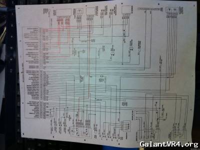

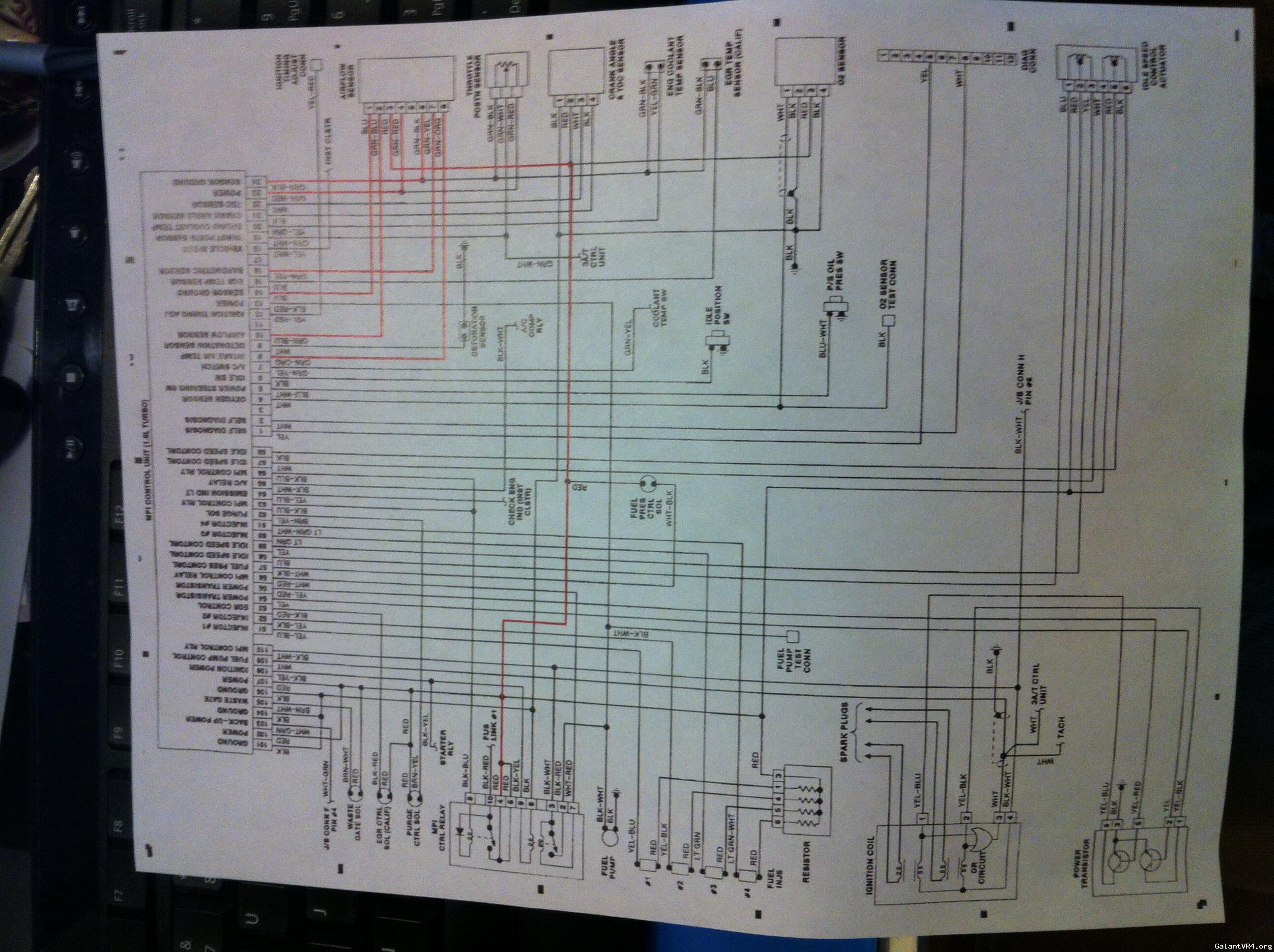

Here are the shared sensors for each wire color and function:
Red PIN 3 - 02, MAF, CAS, FPR, 2 pins MPI, INJ resistor, 2 pins on ISC, Purge CTRL sol.
