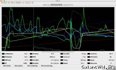

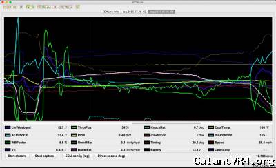

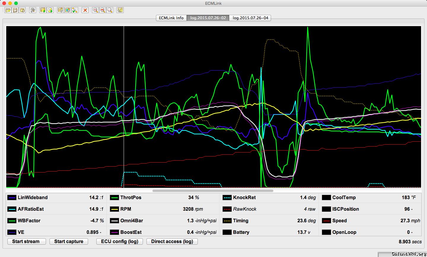

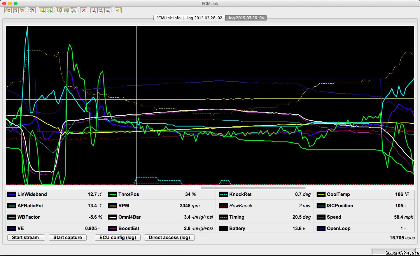

I turned down my knock control thresholds to 2750 RPM's/30% TP to do a bit of low RPM tuning and I'm seeing some knock at about the same RPM range and TP on each log. The timing doesn't seem nuts, and the knock isn't huge, but it's so replicatible that I can't figure it....
So, PK due to vibration at a certain RPM, or real knock?
(link to logs after the pics)

Chevron 92. Looks like PK to me, as well. I'm not running aggressive timing on the low-end.
Thanks for the feedback.
