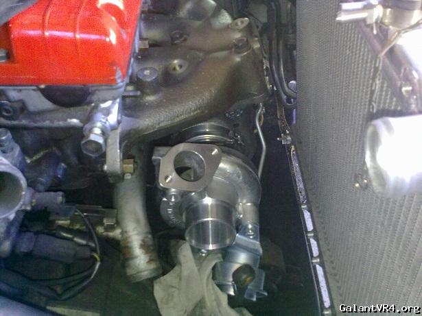

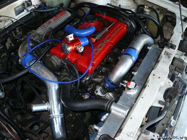

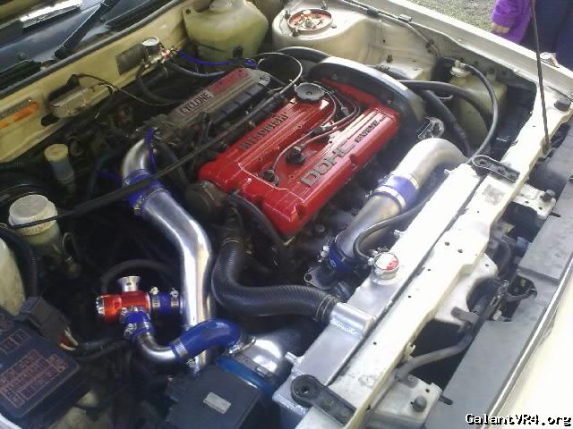

I started with the turbo and manifold as it was suspected to have crack through out. This being an early RS still only had a TD05 14b on it, so I replaced with EVO 3 turbo, EVO 3 manifold & EVO 3 dump. Had to take the car to a mate for a 3" down pipe & highflow cat. HE did a fantastic job.
Next was the radiator as the stock had perished so much the top tank was almost see through. I got a EVO 3 alloy unit & spaced with rubber grommets top & bottom to reuse the stock brackets. All the pins were in the same spot , just 40mm lower on the top. I used a 5mm rubber on the bottom pin & 10mm on the top. I had to also fit a slim fan as the stock is so big & ugly. I got a alloy boss welded in the bottom tank for the fan switch.

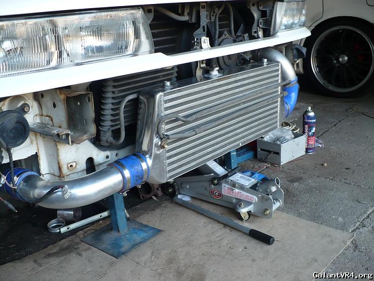

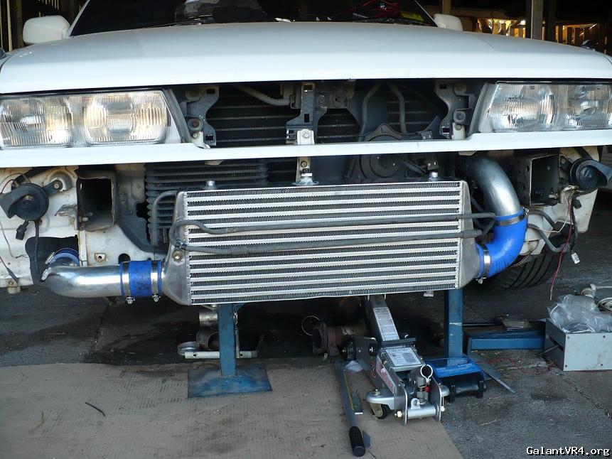

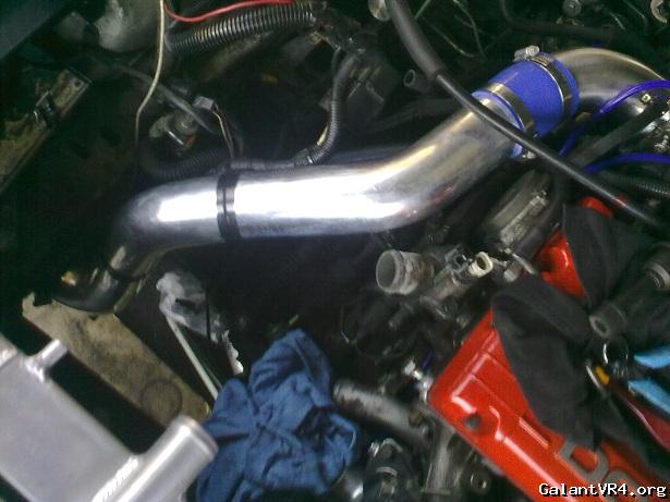

Next he wanted to upgrade the cooler & piping and no-one in AUS makes a kit anymore so I had to buy some 2.5" alloy bends, I cut the pipes until all pieces mated up. I then had to take to a mate to weld for me. The TB elbow I just got from DSM Parts as they sell at a great price. I fitted a 500x240x75 cooler where the old on sat.
Next was fuelling, I fitted some 660cc injectors , a 2g MAF & BOMZ (INJEN copy)intake pipe with 3" K&N filter. The ecu could not be chipped , so I sourced a ecu & chip from NZ ( thanks RAZZA ) . I swap the pump for a walbro 255 & SARD FPR.

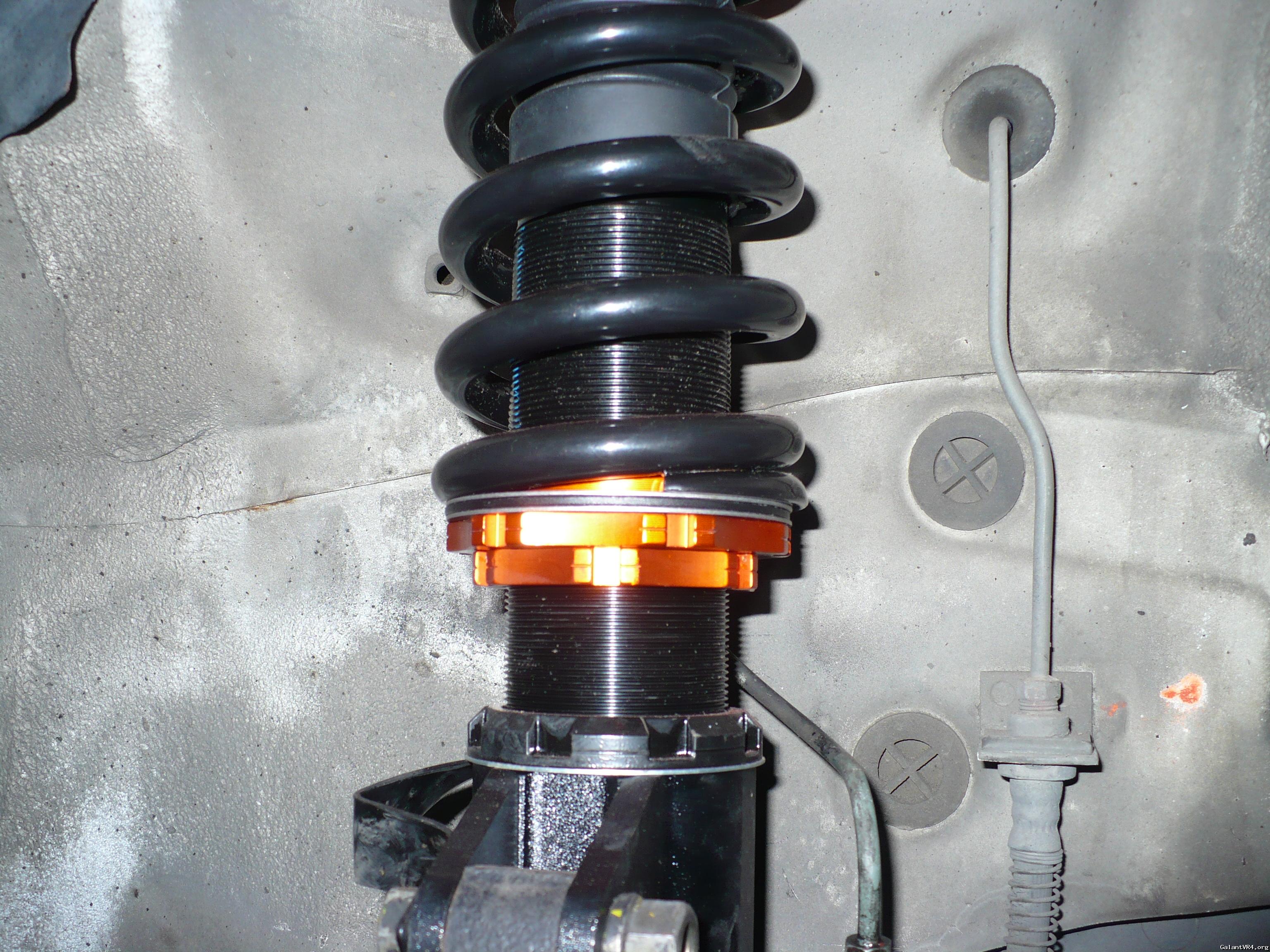

Next he wanted new suspension so a set of K-Sport coilovers went in with a set of Ingalls 1g adjustable rear arms to get the camber right.
It was quite a job that took a month worth of spare time, but worked out . Everything went together very nicely & without dramas.
The car has now been picked up & will be getting a boost controller in the next couple weeks before the trip to the dyno.
My mate was so happy with the outcome even on 12psi, but we are hoping to get 18psi soon.
