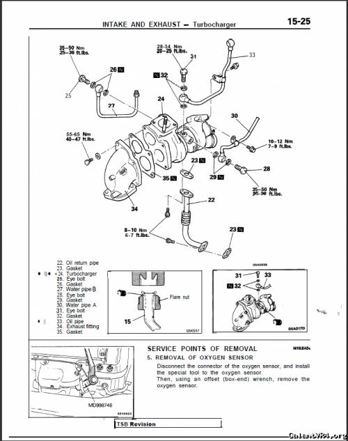

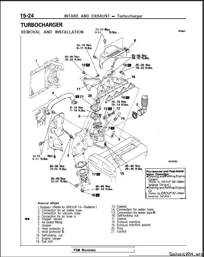

Got the e316g from ForcedPerformance as well as porting for $614 shipped. I got about a week and a half to two weeks wait and then the fun begins. I suppose I could start tearing out the old now. What's involved? /ubbthreads/images/graemlins/dunno.gif LOL Scary right? :p
I usually just dropped the downpipe, removed the oil drain tube (you need new gaskets for this), removed the oil and coolant lines from the turbo, and removed the whole exhaust manifold and turbo as an assembly. I custom bent a 12mm wrench to be able to get to a couple of the exhaust manifold nuts that are a pain. Don't be surprised if you break off a few of the studs, so get some spares. I bought a complete set of new studs and nuts to do the job right.
Should I drain engine oil first or will it not make a difference? When I pull oil lines off will the spill oil everywhere? I am assuming I have to pull at least the radiator fan off before the turbo and manifold will come out right? Where can I get replacement studs? I believe I am going to buy a gasket kit from FP as well. Do they have a studs kit? :p Thanks for tolerating my q's Jeff ^^

Do yourself a big big favor:
drain the oil
drain the coolant
remove the radiator with the fans and the main radiator hoses together.
If you haven't been doing turbo swaps on these cars before, you will be much much much better off with some additional room to work. Sometimes getting the turbo out is a pita and getting the water and oil line banjo bolts on the new turbo can be a hassle. Take 15 minutes to get the radiator out of the way, not to mention it will keep you from swinging a ratchet and poking a hole in the radiator too.
Nate's right. And it will still make a mess when you pull the lines off the turbo. Then again, I can't ever remember working on a DSM and coming home clean /ubbthreads/images/graemlins/wink.gif
Also, inspect the drain tube for cracks in the flex section, as this is a common area for oil leaks, especially in high-mileage vehicles. If the budget permits, opt for a push-loc hose with -AN fittings, and you'll make life easier in the future as well.

Drain the oil, why? I never drained any fluids during the 6 turbo swaps I did in 1788. I liked to pull the exhaust manifold by itself. That gives lots of room to disconnect oil and coolant lines from the turbo and pull it separately.

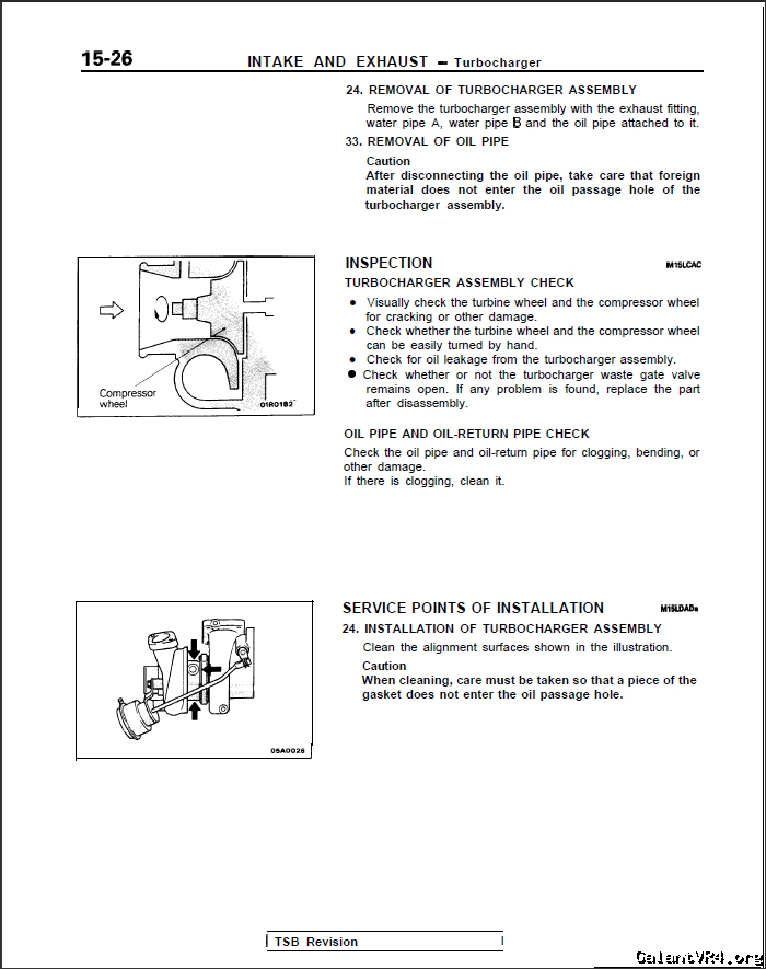

Don't forget to prime the new turbo with oil.

I got the upper heat shield off without too much problems and removed the oil dipstick. How in the world do I remove the tube? I couldn't find a bolt or anything holding it in place. Does it just pull out?

From memory the dipstick tube has two 10mm? bolts attached to the oil pan and one holding a bracket to the block?
You *can* take the turbo off without removing it - At least on a JDM. Last time I just removed the radiator (A/C is long gone, and probably a few other parts that you may still have) and shifted the power steering pump.
It's probably much better to follow the steps outline in the VFAQ article so you don't forget anything the first couple times.
