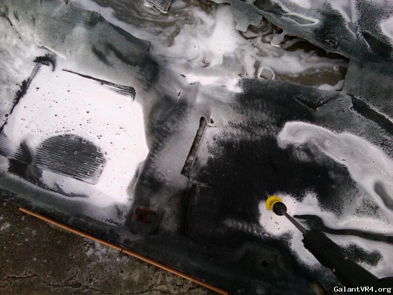

The first thing you will need to do is pull the carpet out of the car, so you are able to clean it. I recommend cleaning it with a pressure washer. Pressure wash the carpet until the water that comes off the carpet is clear and clean.

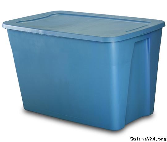

Once its clean you will need a big enough container to fit your carpet in. I bought a 30 gallon plastic tote from Wall-Mart for $10.00.

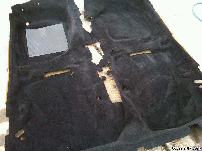

After a few hours, pull the carpet out of the dye and unfold it to let it dry. If you do not let it dry completely, dye can and will rub off on your feet and/or hands.
This is what it should look like depending on the color you chose, and how long you let it soak.
