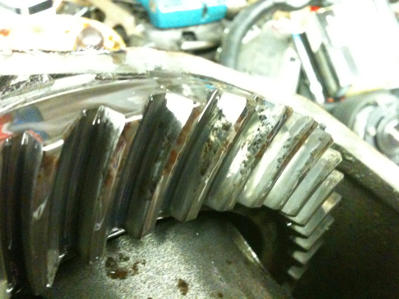

I've been chasing down this strange intermittent vibration for a while now.
This vibration would happen while cruising at part throttle (think maintaining speed on a highway 55mph) and when i'd let off the throttle i'd get a pulsing vibration in the drivetrain, very faint, but strong enough to annoy the hell out of me. often while cruising it would a 2 pulse vibration whenever the slightest downgrade in the road began, meaning load was taken off the drive train. This was driving me bonkers.
I started with a tear down of the driveshaft, after replacing the lobre joint the car was smoother, but the intermittent vibration still existed
Swapped out transfer cases, no fix
swapped in my spare transmission, no fix
New front axles, no fix
Finally, swapped out my rear diff, suspecting a pinion bearing that might be wore, despite feeling no initial play in the pinion.
Swapping the diff fixed the problem, smooth as butter. However upon opening the old diff, this is the wear I found that was causing the vibration, it's only in this one spot, almost looks like pits from rust, or it chewed something up, or... i dont know, thoughts? /ubbthreads/images/graemlins/dunno.gif
