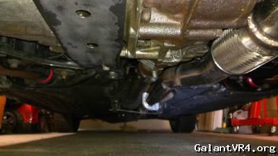

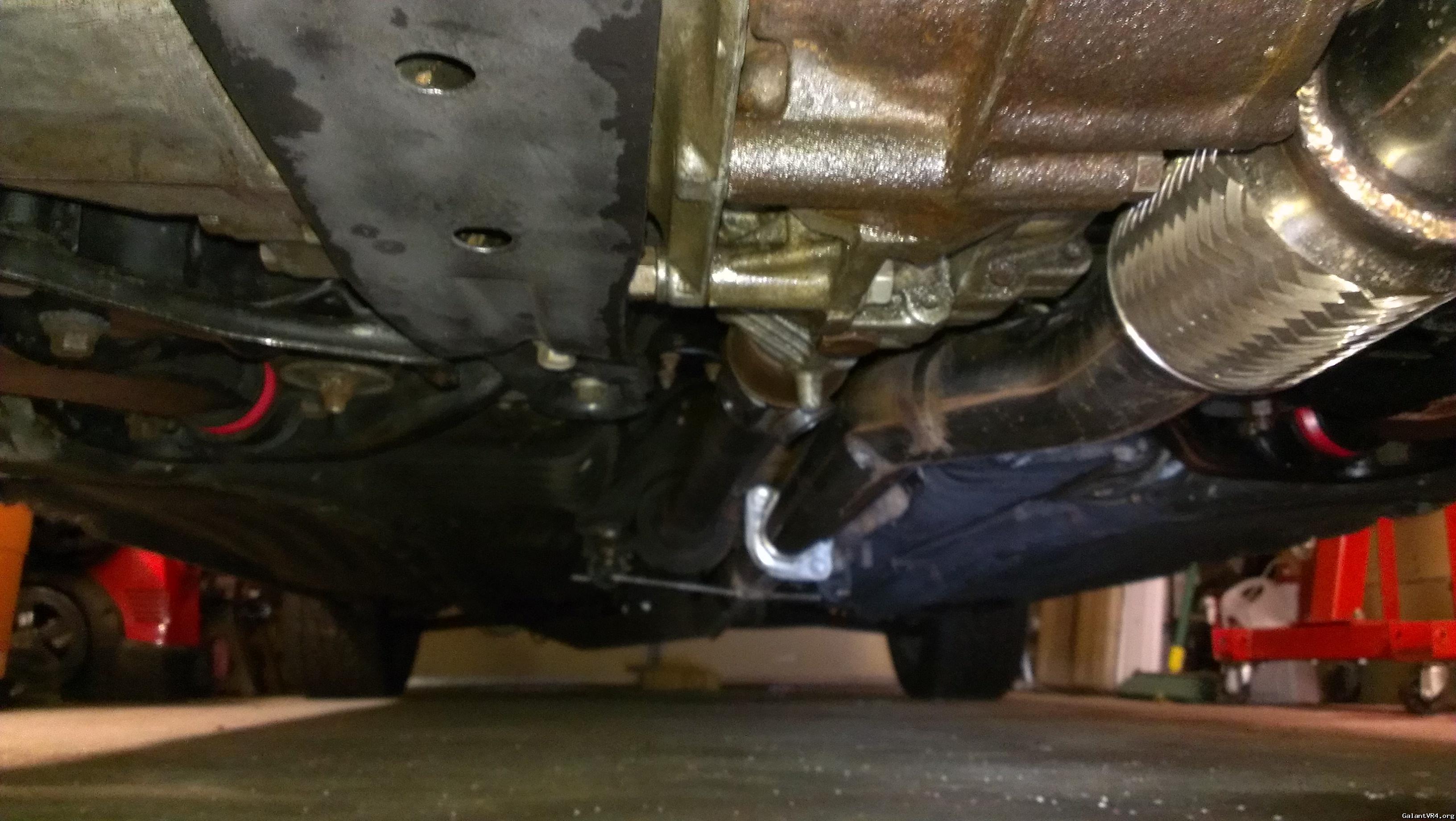

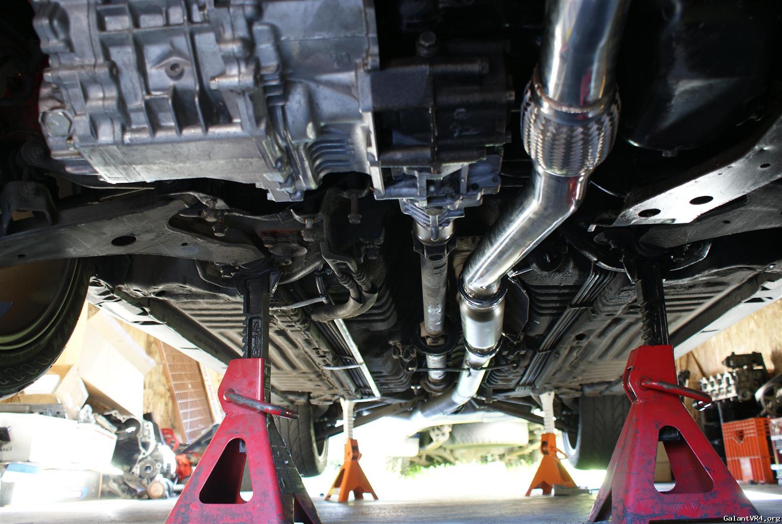

Can you get under the car and post a couple pictures? Aside from the mounts and actual unibody as you mentioned, there isn't really much else I could think of unless there is a problem with the driveshaft itself.

I will say that the drive shaft does not sit exactly straight from transfer case to rear differential. It comes out the transfer case slightly towards the passenger side, then after the first carrier bearing it shoots straight to the rear differential.

Exactly. It's got a weird angle in it factory. I don't think you have some crazy chassis problem. Sounds more like a driveshaft or T-case/differential problem. This is why pictures can help. It might look completely normal to some of us that have been under these things for years.

The shaft doesn't go perfectly straight from t case to rear diff. It does "curve" some towards the passenger side around where the stock cat convertor would be.

I looked for a picture but couldn't find a decent one. I'd have to jack it up to show what I'm talking about. There is a good sized dent in the floor near the first mount though.

Ill get a pic tonight when its cool out. Wait no going out tonight... Tomorrow maybe. Its not a ridiculous angle but its not as straight as it could be.

You don't want a driveshaft perfectly straight in all planes actually. There needs to be offset for the u joints to work properly and not transmit vibration and noise.
