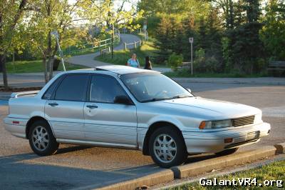

yep that my car in that pi. just no front badge, sun roof and diff rims. i think i kno the parts that would have to be replaced and change, just want to kno real if anyone kno of a goal suppler of full under hood swap packages. a limited slip diff i can fine later. dose anyone kno the web site that have all the galant models and their gear raito's. i had it once put had to wipe my computer /ubbthreads/images/graemlins/banghead.gif. thanks for the help. anyone with some good ideas feel free to post.

Yes that is just like the Galant GSX - is your spoiler soft and squishy as well? Good looking gal. Are those the stock rims, because they look similar to one type of stock VR4 rims.

it is the Canadian, eagle variant of the GGSX. Your n00bness is showing /ubbthreads/images/graemlins/wink.gif

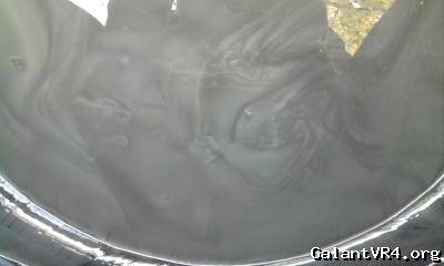

yes the stock rear end is still in the car. it is a four bolt rear end dont think it is an lsd diff tho as to y i want to replace it with one. the car still moves, just there is, like a binding feeling in the drive line and when i lift off the gas, u feel resistence in noise out of the tranny.
this is the gear oil that came out of it /ubbthreads/images/graemlins/jawdrop.gif no good
