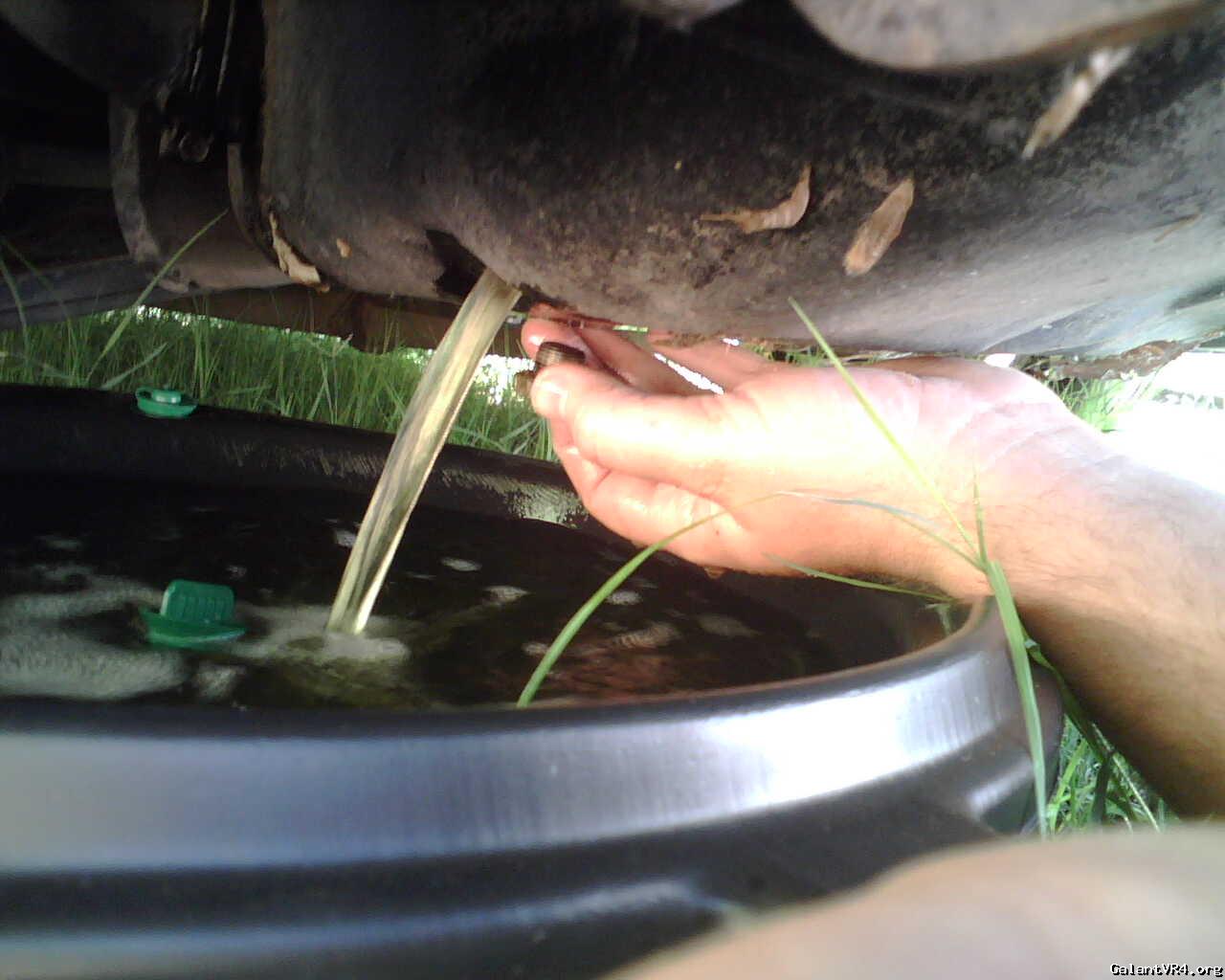

Crawl under the car, driver's side. There's a larger drain bolt in the bottom of the fuel tank. Pretty straight forward.
If you've got bad gas in there, consider pulling the fuel pump out and then pouring the fuel you just drained out back into the tank through there to flush anything out from sitting too long. (Just put a second catch pan under the drain.)
EDIT: Remembered I had a picture from when I did this last summer on Tarmac-and-Gravel.com
