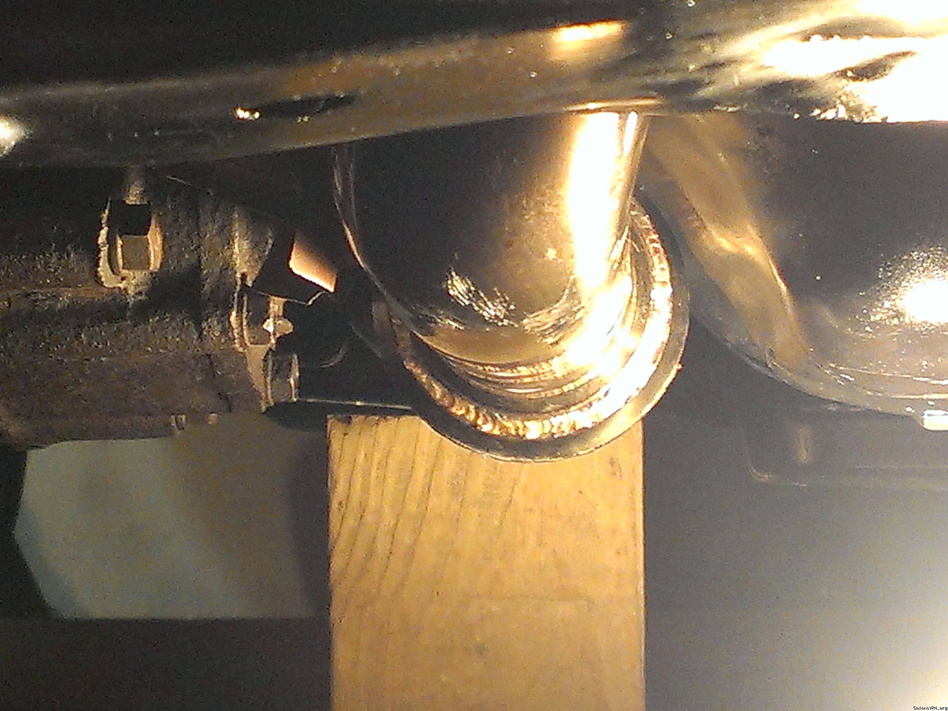

down pipe hits front subframe?
tektic
Dec 19, 2012
1,497
ronkonkoma, ny

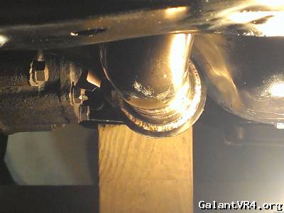

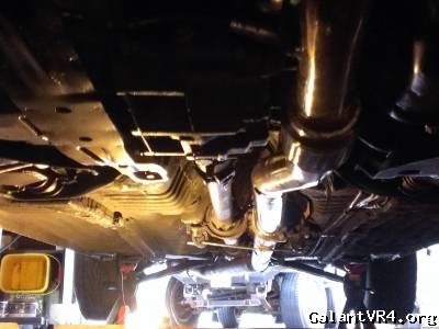

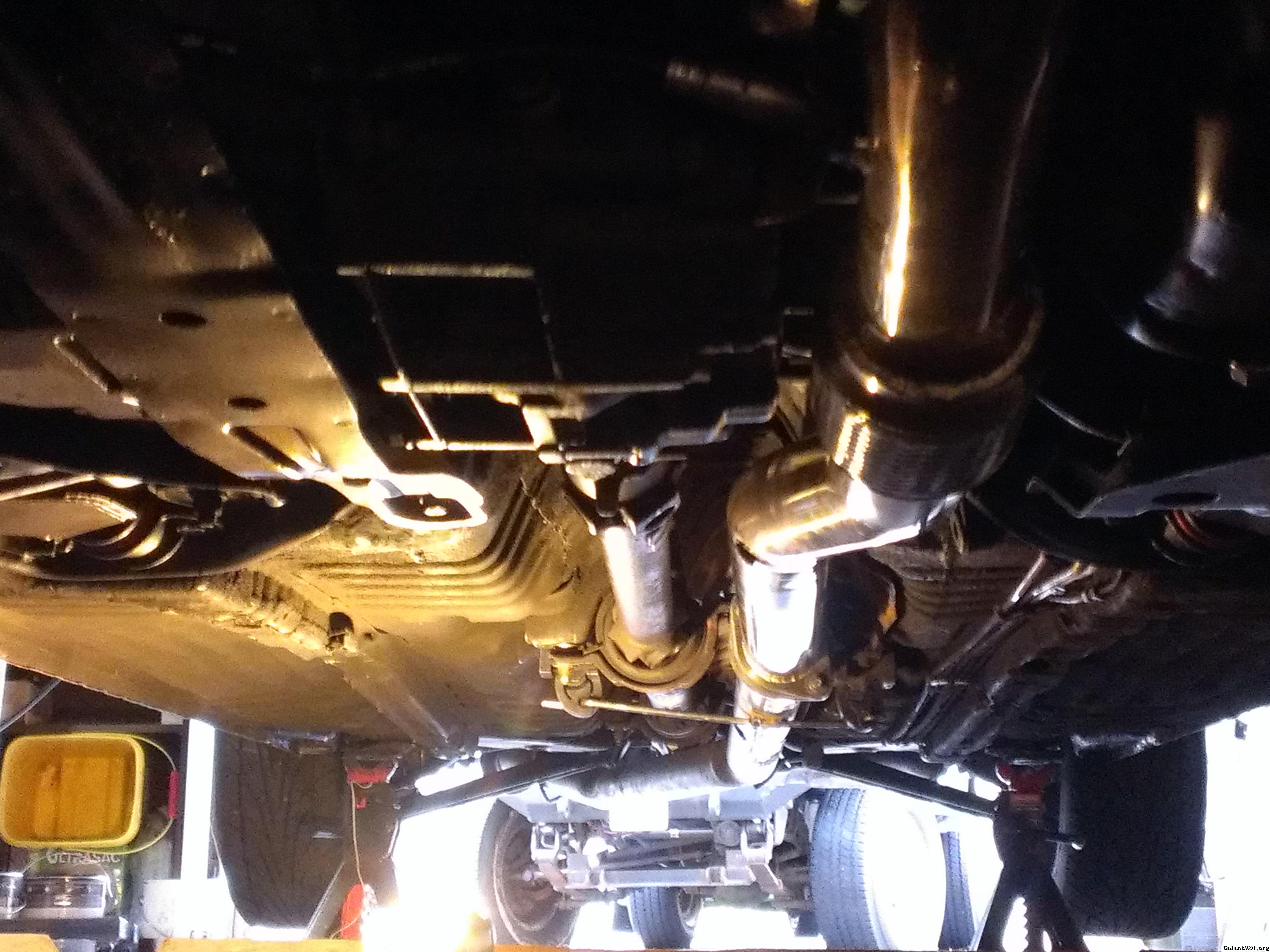

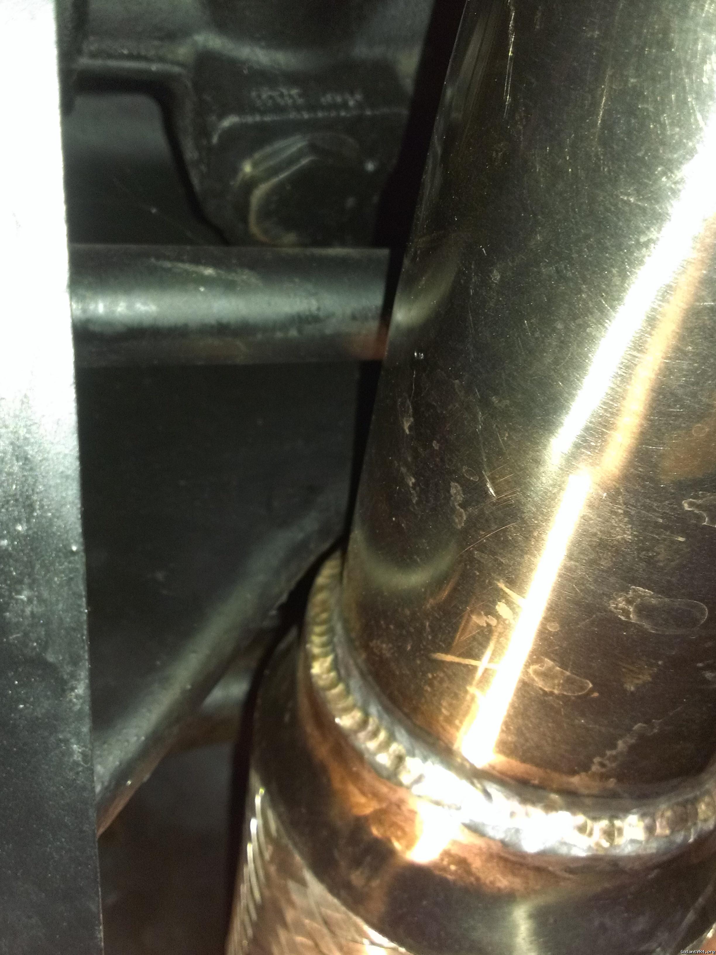

Ok so I just installed 344/195 engine brackets and now my eBay down pipe is hitting the front sub frame by the control arm . I searched for down pipe fitment and found some people hitting their transfer case, but not the sub frame. I have a 95 o2 stock body turbo and 95 manifold.
I was under the impression that these downpipes fit well.
Will an e3 o2 housing put me closer to the transfer case?
tektic
Dec 19, 2012
1,497
ronkonkoma, ny

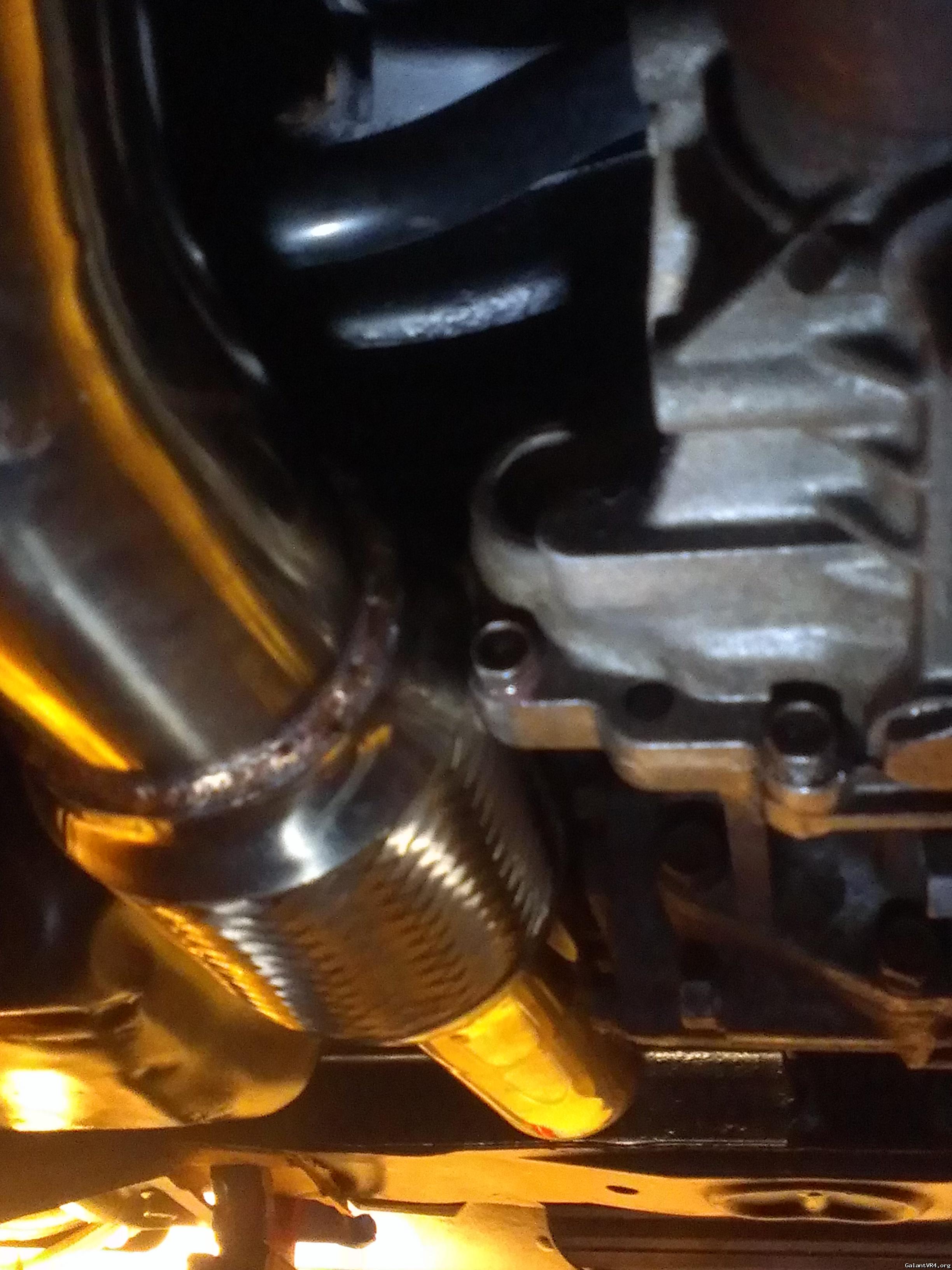

Well it was worth a shot...
But Epic Fail!

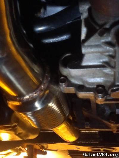

Now it hits the transfer case and as predicted my o2 bung is rendered useless because the sensor would contact the oil pan. Over all it is in a more manageable position with the evo 3 housing.
I think its time to get out the bfh. It sucks that its the end ring of the flex section that's making contact. I'm like 60% sure I'm going to destroy it. Maybe then I can get one that fits. Or just waste more money. Who knows.

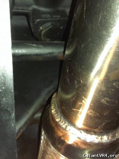

tektic
Dec 19, 2012
1,497
ronkonkoma, ny
I sliced the pipe 90 percent of the way around. Spred the gap 12mm at the widest point and then droped it off to get welded. It cost $75 to have it done. But it fits well now.
