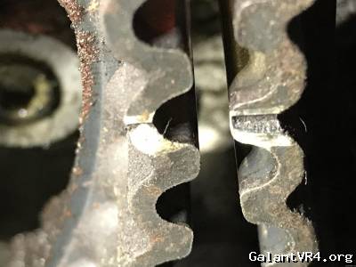

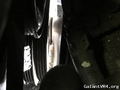

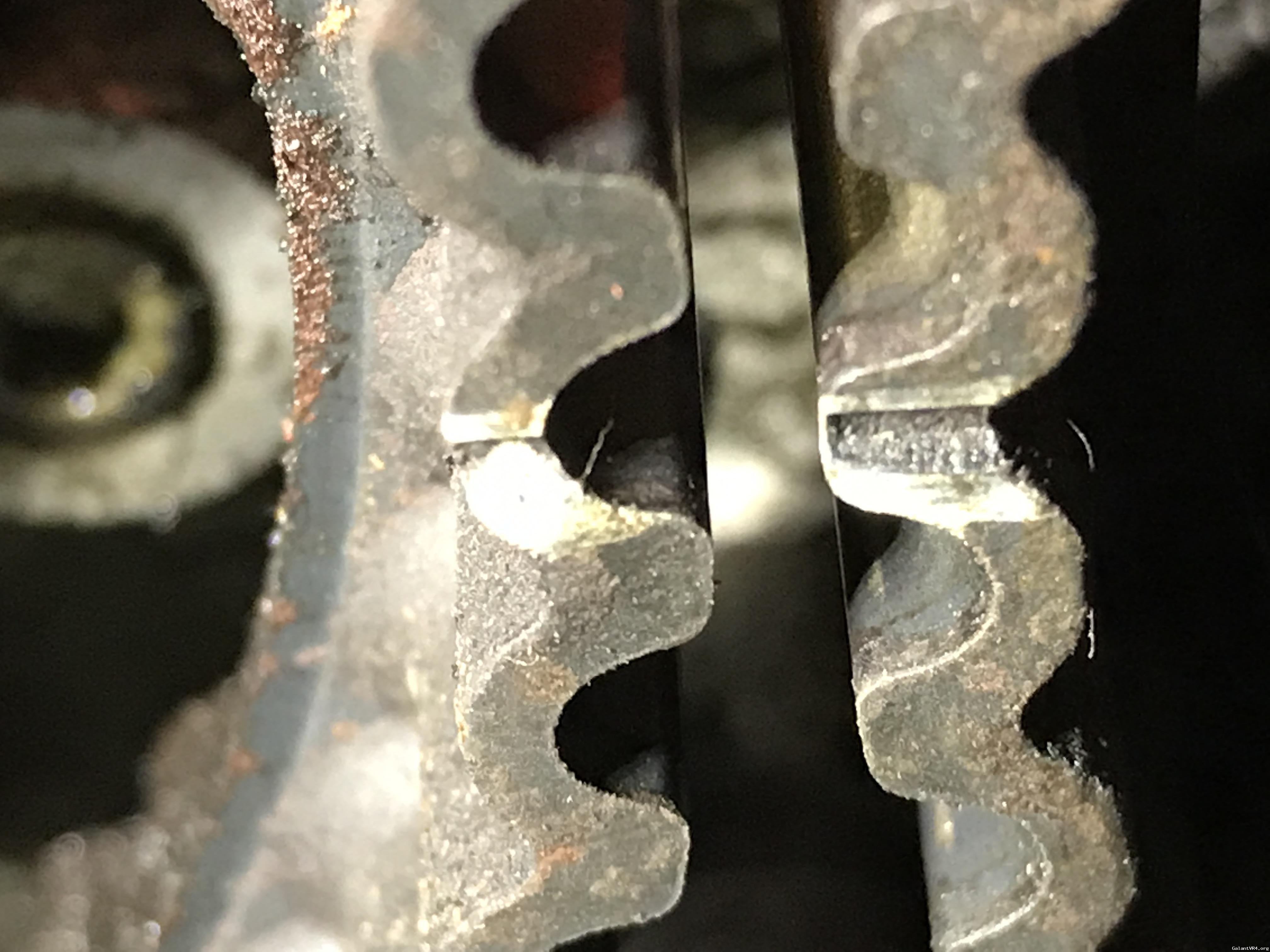

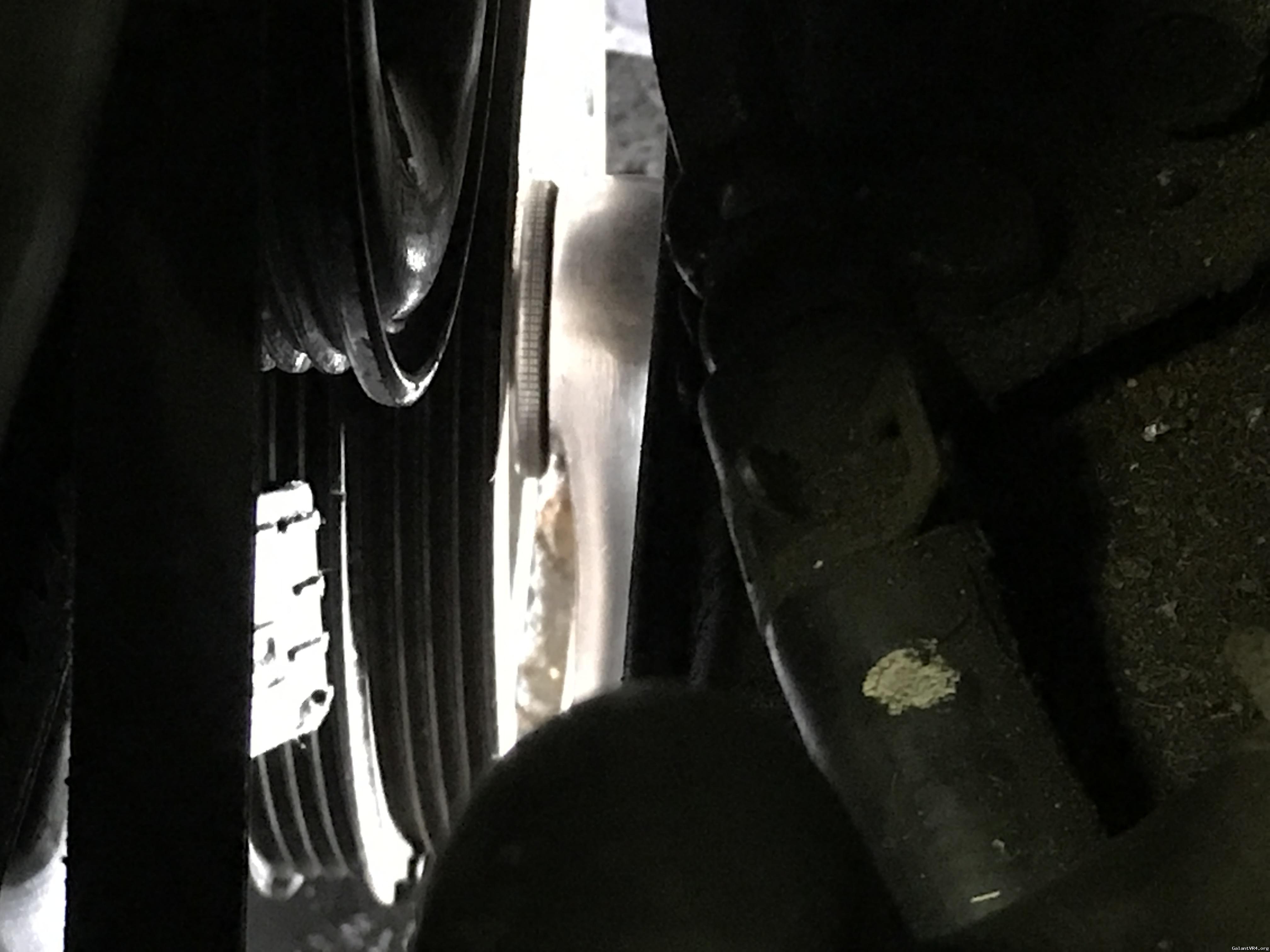

I tried to get the best pictures I could. But does this look correct or is it off just slightly. The car runs a hair lumpy at idle but I feel like it’s more of a vacuum leak than anything else. I’ve gone through the fuel system and that is fine. The ignition is also working well. So it’s either just off timing or sucking in air somewhere. Or the tune is crap.

You need to pull the cover and check the actual timing gear mark, also if the car has balanace shafts the belt could be loose or that could be off a tooth.
Edit - gears look on point, harmonic balancer looks a bit off, but that could be from the angle the picture was taken.

Your cam gears are lined up so the question is whether the crank is sitting at TDC. If you draw a line from the center of the harmonic balancer (in the middle of where your wrench head is) to the '0' tick on the timing cover, it looks like it passes right through the notch on the edge of the balancer wheel. To me that indicates that your timing is good. If it's vibrating a lot you could have your rear balance shaft out by 180*. If it's just idling poorly check your ignition timing and fuel/vacuum/etc.
