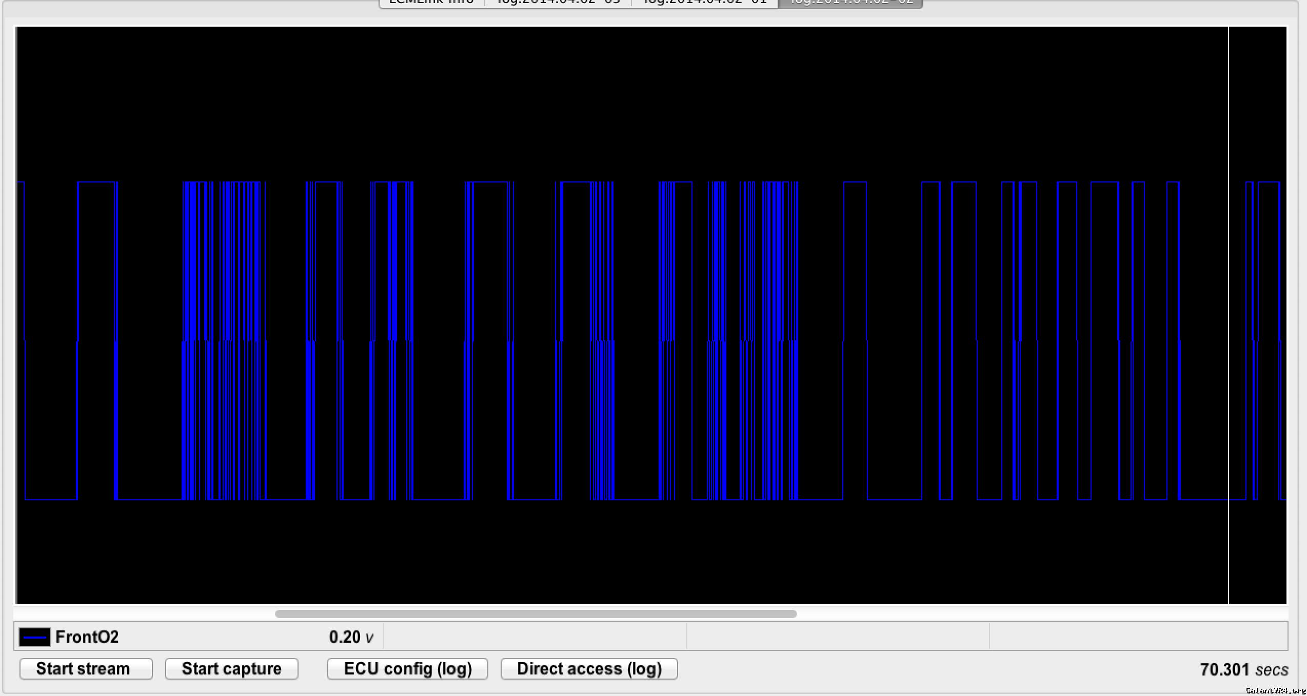

I was troubleshooting a temp issue (resolved as a loose wire) and while checking my v3 logs, I noticed my narrowband output looked a little weird. Before installing my Innovate WB, I had an Autometer NB and am quite familiar with the useless, bouncing needle. Now what I'm seeing in v3 is some oscillation, but also periods when it "sticks" at 0.2v and 0.8v. It never goes below/above those values, and it seems rather consistent in its behavior (cold/hot/whatever).
I've got a new motor and transmission, and my mechanic (EHMotorsports) took great care to make sure it all went back together with no leaks and such. That, and it's running great (although it won't reach its full potential until I can get it on the AWD dyno up at English Racing later this month).
So yeah, not trying to track down a problem per se', but an opinion would be great.
Thanks!
(since I don't know how to upload a log here, I'll just give you a screenshot)

Thanks. I recall it bouncing a it more than that at idle, but I wasn't logging, and narrowband gauges are not much good beyond filling that second gauge pod so it isn't empty once the boost gauge goes in.

why not? If the O2 sensor starts to go tits, I would want to know, right? I'm not logging it for tuning, just for information.

Well I have not complaints. The issue that got me looking at the log in the first place was a high-idle while coasting. Turns out my temp sender for the ECU had a loose connection. I tracked it down because the log was just showing a flat 175 degrees for temp, even though the gauge on the dash looked normal. Engine thought it was cold, so it ran in closed loop and had a high idle. Fixed the connector and fixed the problem.
The consensus has been that the output looks ok, and I'm not having any issues driving around. I'll just have English look when I take it for it's dyno tune in a few weeks.
