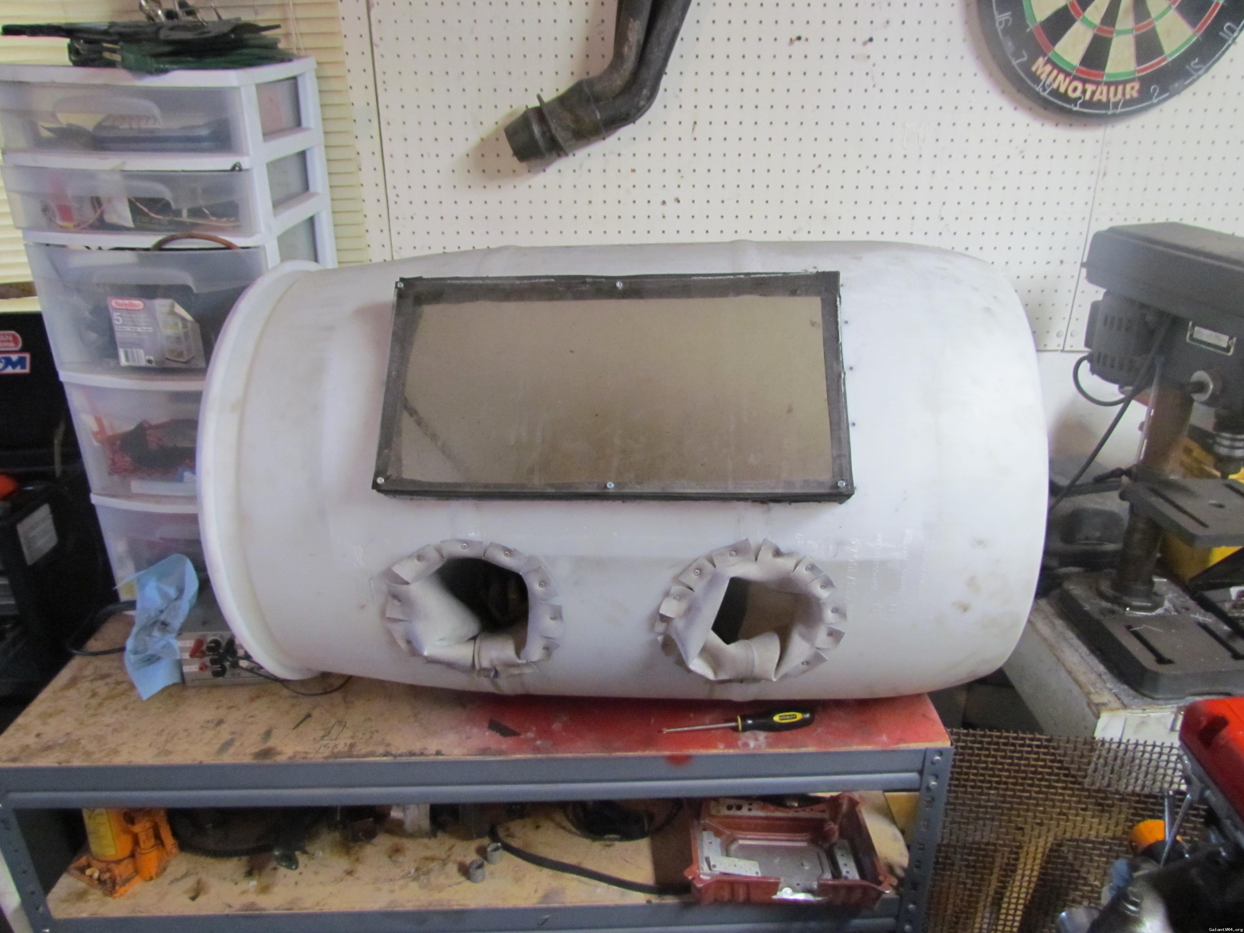

1.mark out with some tape a good size window and use the jig saw to cut it out
2.use some particle board to make a bracket for the glass to set on, or you might just be able to fold the glass over and rivet it on.

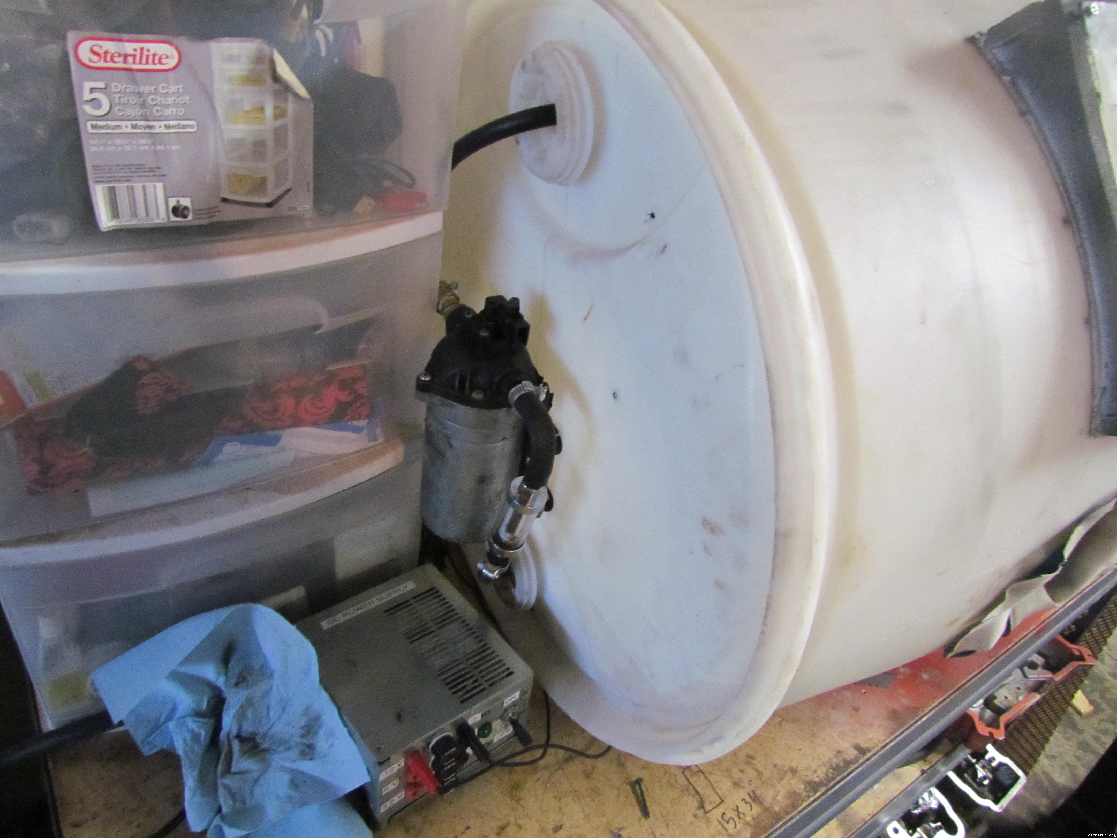

3 mount the punp on the side with screws
4.pluming:
tank==>hose===>filter===>(in) pump (out) >===scrub brush i drilled a hole through the midle and zip tied the hose to==>tank

6.use a compass to mark a 7" diameter for glove holes and cut out with jig saw
7. drill and rivet gloves in
