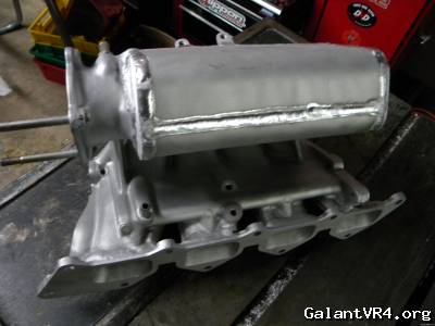

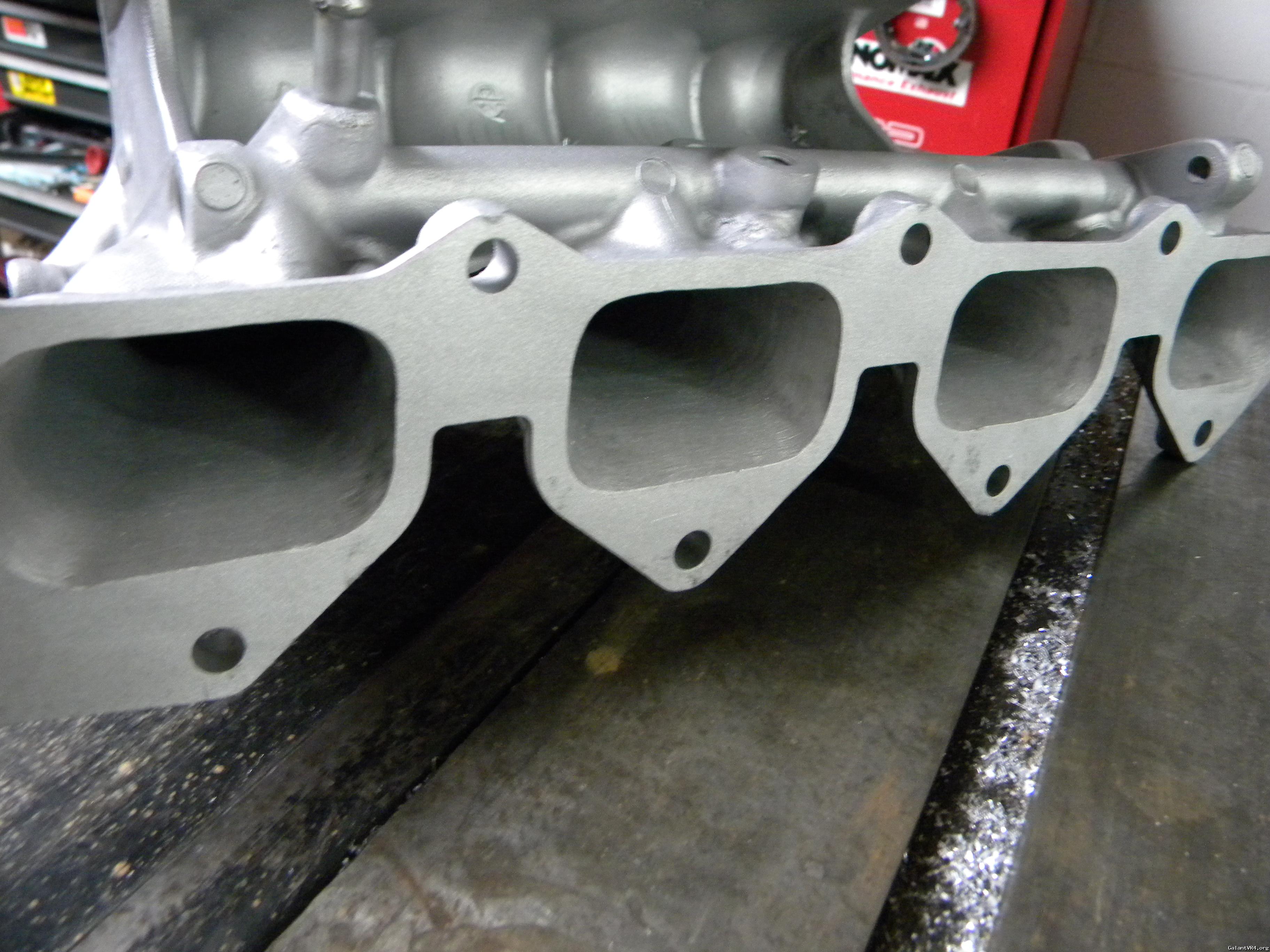

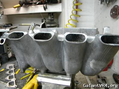

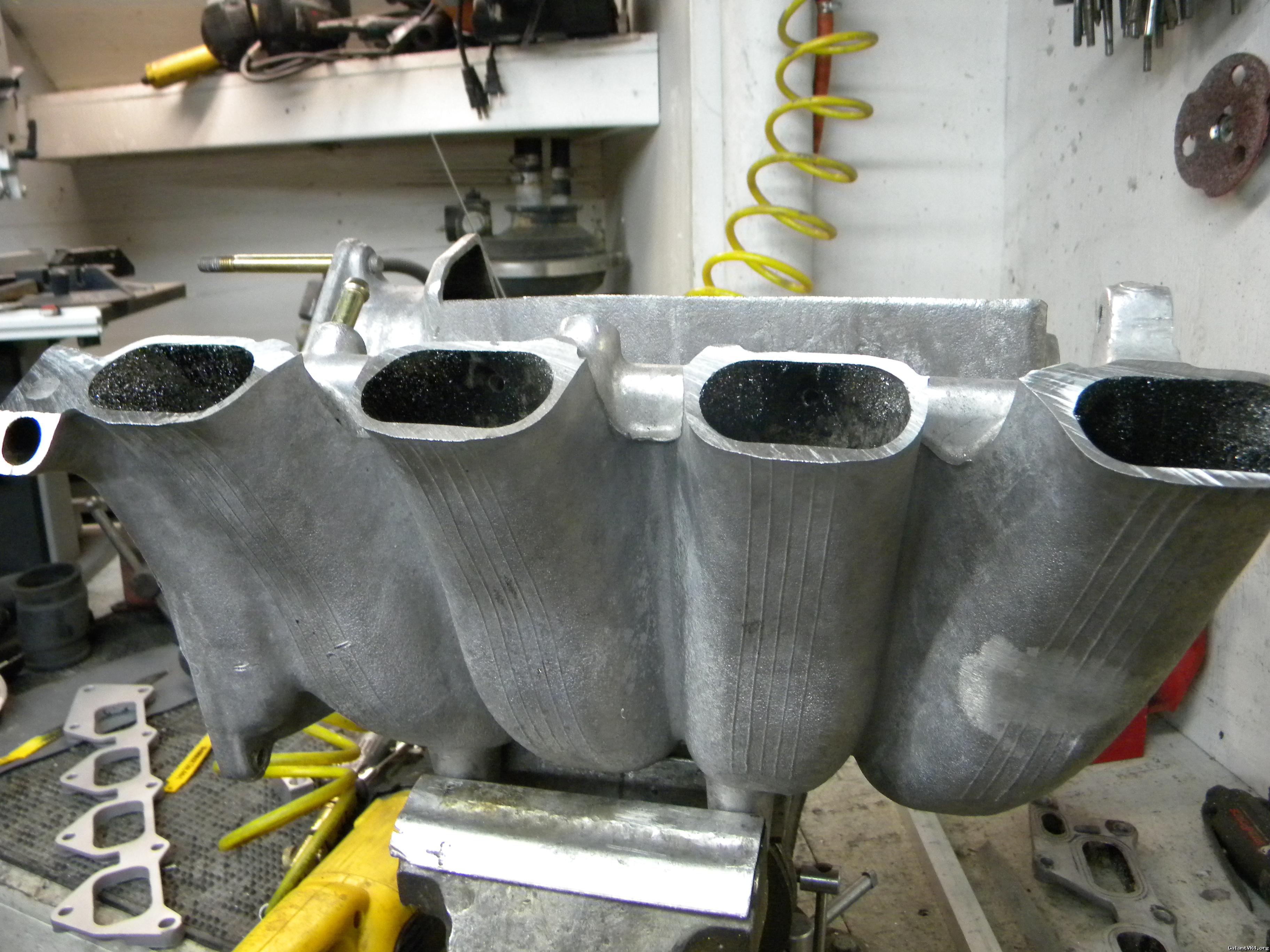

Now as for porting a 2g to a 1g port its alot of work. Its way easier to cut the bottoms out of the runners and weld in a shaped plate of 1/8 inch to the bottom to make a long transition from the last bend from big to small at a 5 or 8 degree angle than try to port out the head and end up porting into the wrong area and losing VE of the head port. Rapid change from big to small makes a hell of alot of turbulance and to cut the head correctly you at the short turn area coming all the way out. If you a have bridgeport or large knee mill thats fine but with a cutter and die grinder its a 2 day operation. I have pictures some where of a 2G I did this way years ago and refuse to do another one.
belize1334
Nov 18, 2003
3,317
Bozeman, MT
So you think it's feasible to cut the flange off of a cyclone, cut the floor out of the last runner section and then weld in a shaped piece and a 2g flange to mate to a 2G head?
May 4, 2003
11,892
Clarksville TN

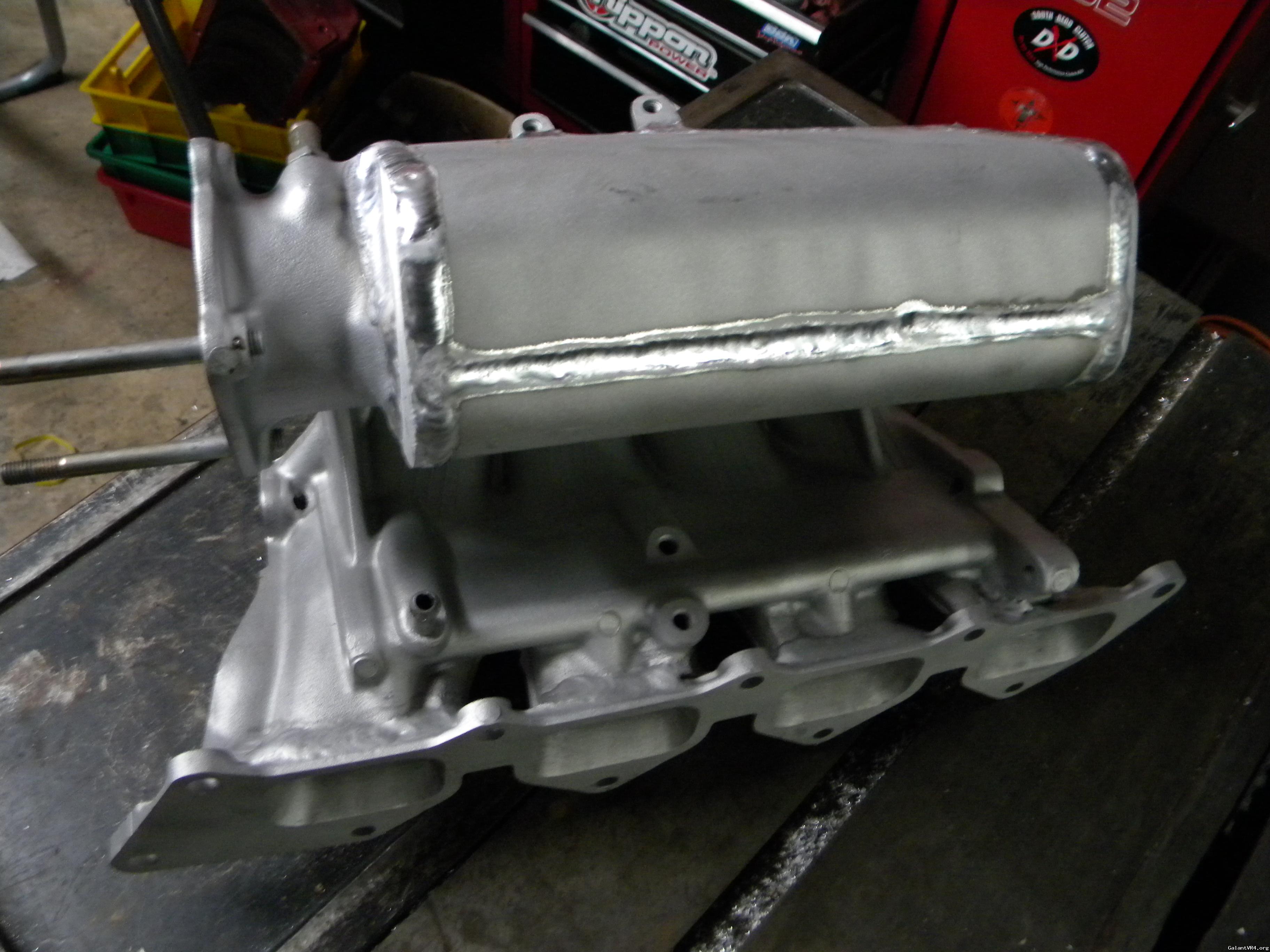

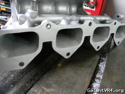

yes feasible but alot of work. I built a 2g intake this summer for a board member that I welded a 1G flange to and ported out to match a 1G head. Car is an NA and he was hoping to benefit from the added VE then a bigger plenum for top end. If you look close at my nasty work bench the 1G cyclone flange I used is laying there as well as the 2G I just cut off.
Proof it can be done.
