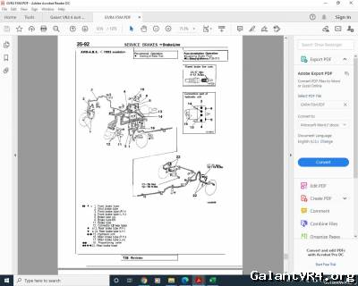

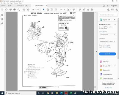

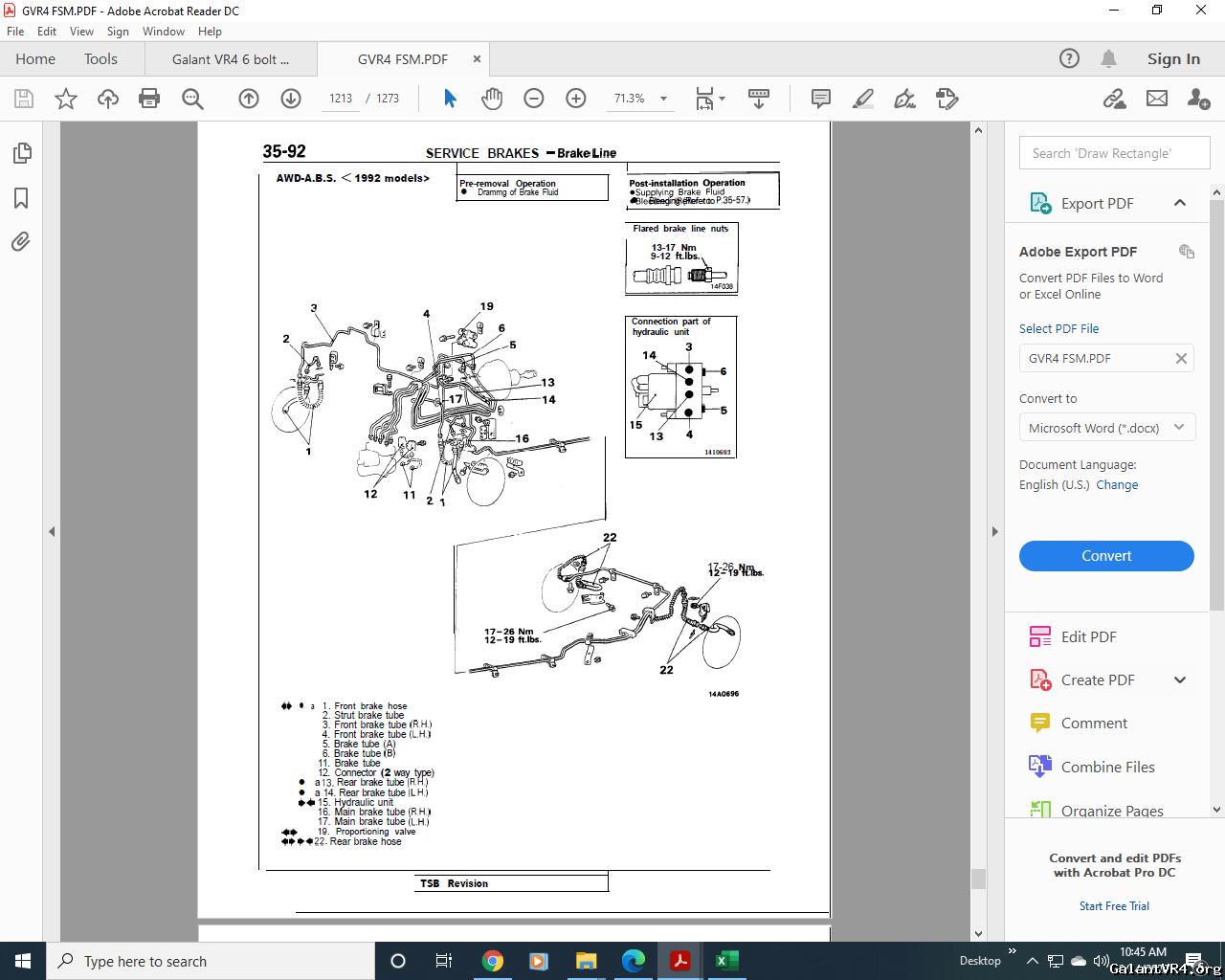

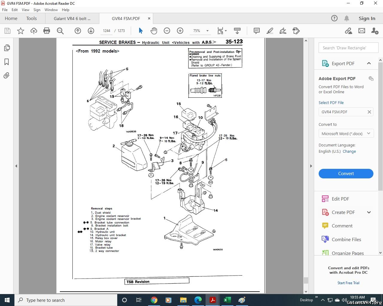

It's not exactly clear if you did it, but do you know there's a bleeder valve on the ABS unit??
mk2davis
Mar 1, 2015
195
Ventura, CA
I've read that, but either I'm not looking at the ABS unit or what the FSM calls the hydraulic unit doesn't have bleed nipples.
I see bleed nipples on 91's, but not 92's?
If someone can point me in the right direction, I'd be much obliged.
