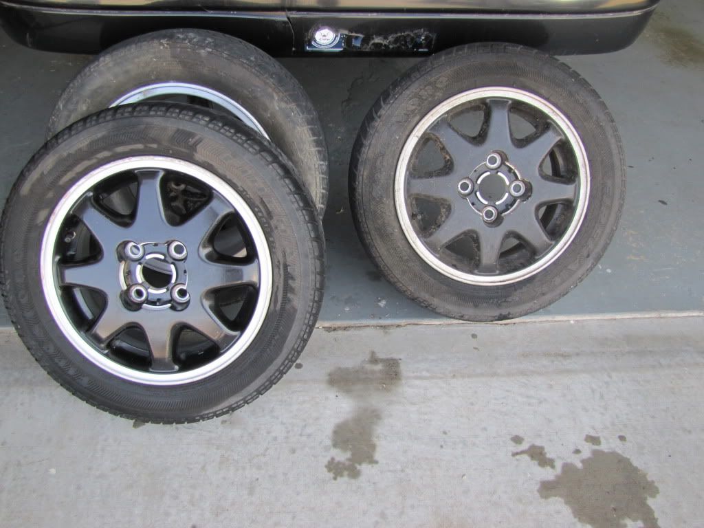

Let me start with, the tires are being replaced tomorrow. Also remember this is the car that sat for 6 years before I got it. I will list my details below.

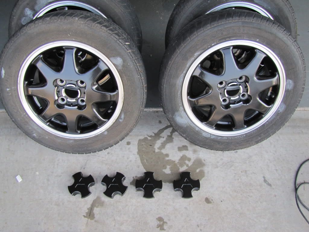

I used a two bucket method to clean the wheels. I used 400 grit wet sand paper to clean the inside of the wheel and the outside lip of the wheel. The wet sanding did not get it perfect but at least knocked off the surface corrosion, and made it smooth to the touch. I then used a poweball with Poorboys SSR1 polish, on the painted areas of the wheels and caps. I then used Poorboys wheel wax on the inside and outside of the wheels and caps. I think they turned out okay for 20 year old wheels.

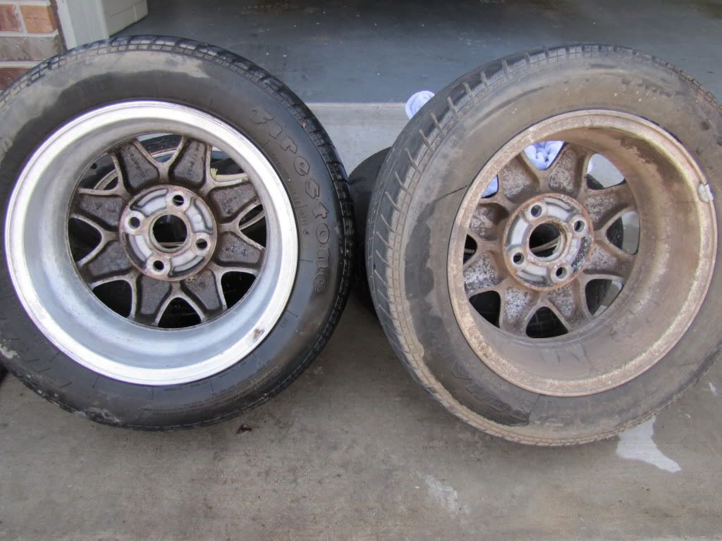

Here is how they looked when I started.
Up close of the front.
Up close of the back.

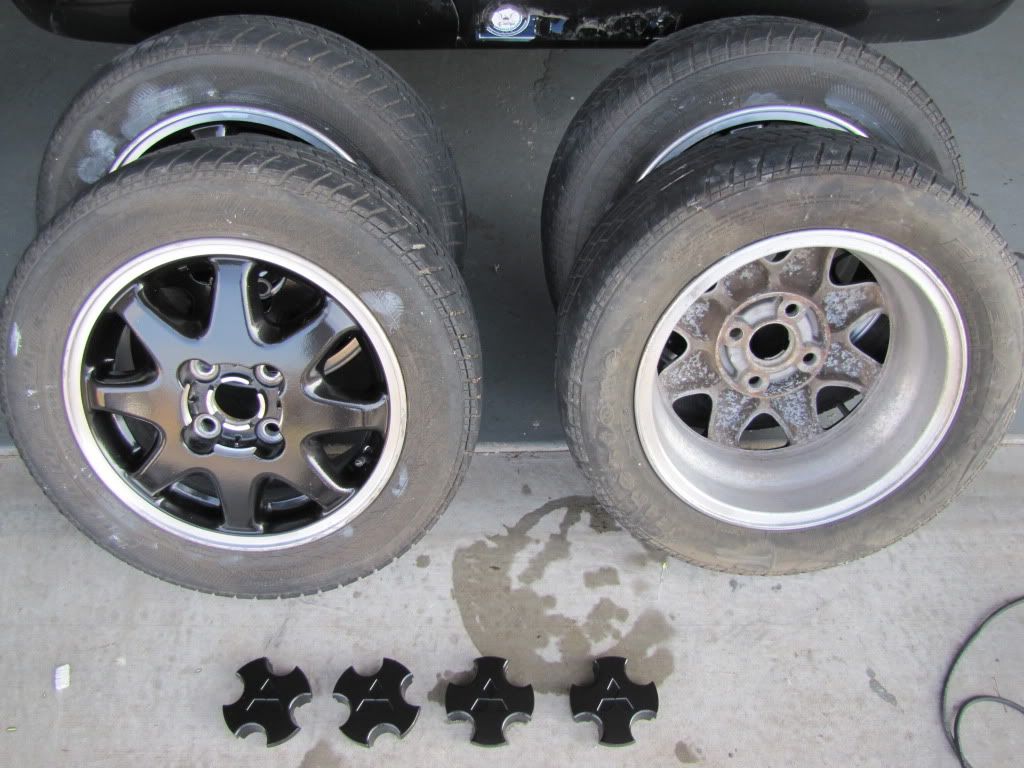

Here is a pic of the front washed versus unwashed.

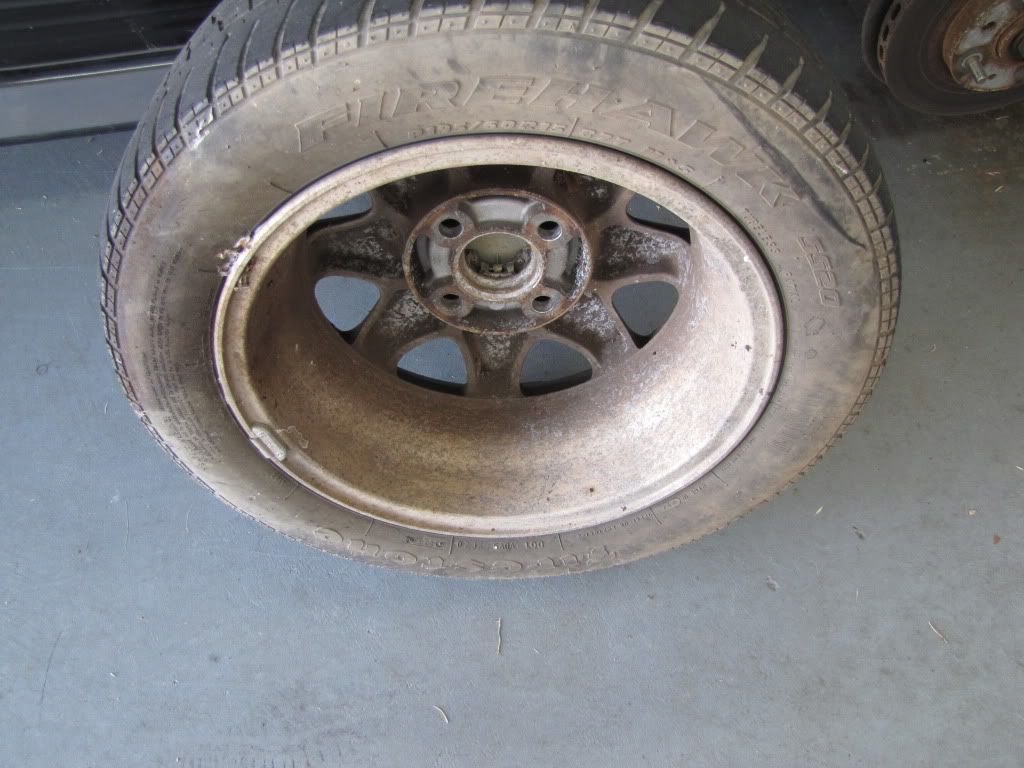

Here is a pic of the rear wet sanded versus unwashed.

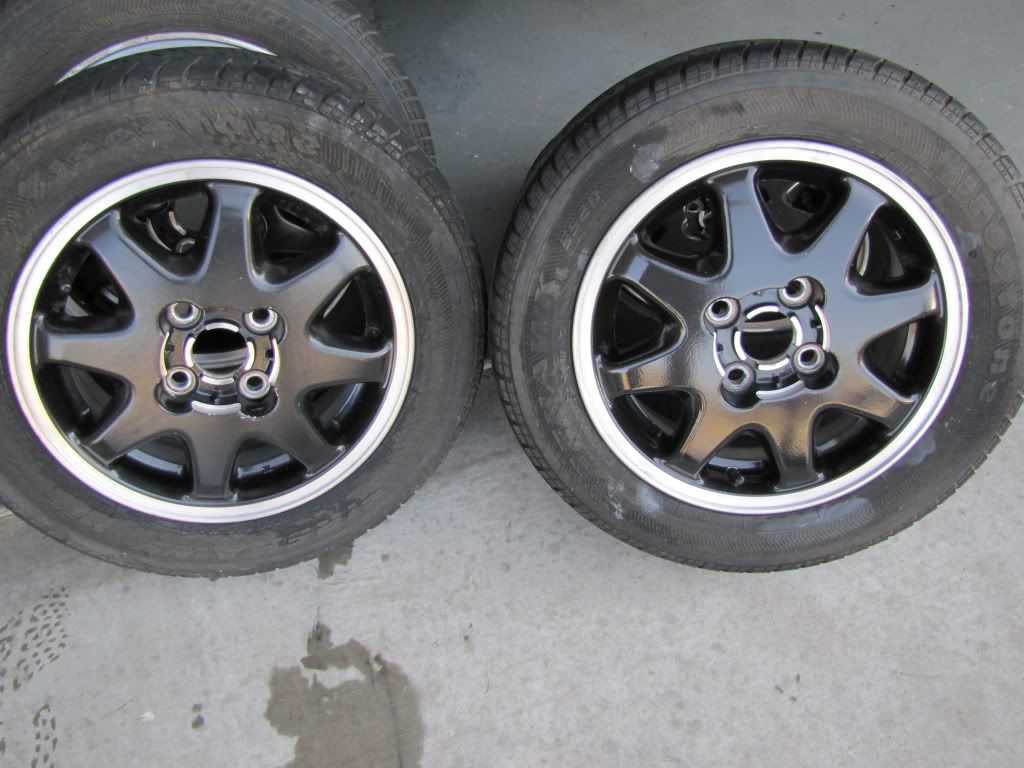

Here is a pic of polished versus unpolished.

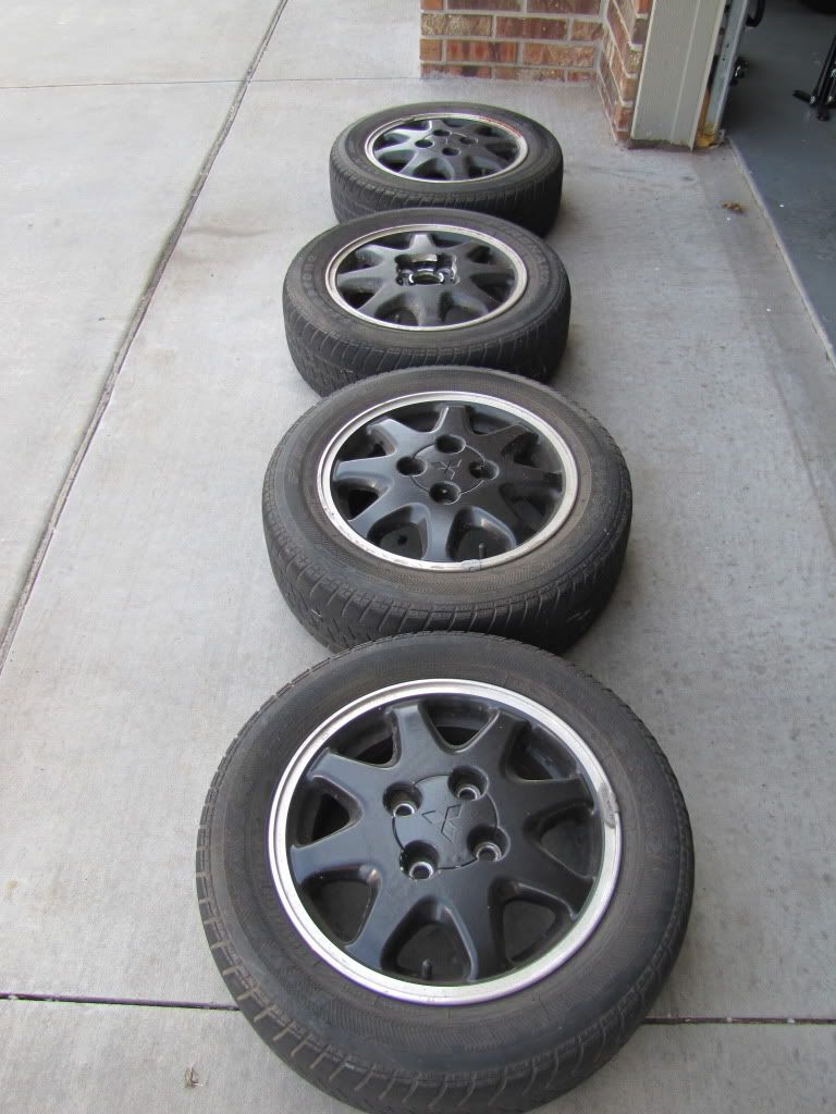

Here is a picture of the set done and waxed.

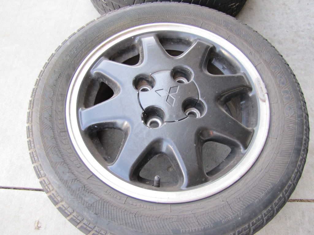

Here is a picture of the set done and waxed showing one of the rears.
