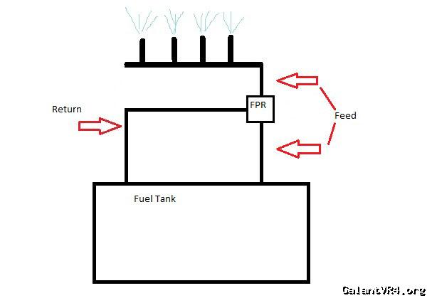

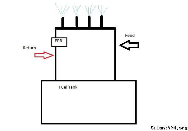

Anybody run this setup? I'm building a fuel system currently and strongly considering a deadhead setup. For those that are unfamiliar, its basically where the fpr is located before the fuel rail. There is only one line feeding the rail. Here is some crudely made diagrams.
Traditional:
Deadhead:
Research indicated some potential pros and cons, although there is conflicting information out there.
Pros:
Fuel isn't heating up passing through the hot rail multiple times
Shorter distance for fuel to circulate
Less fittings and line required
Cleaner
Cons: (potential)
Rail needs to prime and displace air on start up
Vapor lock on hot start
Starve injectors further from feed
Requires 3 port FPR (most aftermarket are though)
Discuss

Your (pros) list says shorter fuel line. By how much, maybe a foot? And tells of less fittings. No it is not, there are the exact same amount. Not counting the fittings at the tank or filter, there are still 4. You also talk about heat, the fuel cycling back to the tank, mixing with the large resevoir really should not be an issue. In the "deadhead" setup you propose, the fuel that is pumped into the rail can't leave any other way than through the injectors, that to me would keep the fuel in the rail longer heating it up more than the extra fuel being pushed out and cooled by the lines and tank.
Your "cons" list says it all. Start-up issues and higher possibility of leaning out half your engine?
Unless your planning more than 500whp, leave it alone, upgrade the pump and install a good AFPR and call I good.

My cons list is potential, not concrete. That's kind of what I'm wondering. Also you say shorter by one foot, but whats stopping someone from mounting the fpr right near the sending unit.

No its not. The further away you mount a vac/boost device the slower it responds. Same goes for the pressure in the fuel line. You do not want to starve the cylinders of fuel even for a second.
That is why they say to install the boost controller as close to the turbine as possible and make the vac/boost line to the waste gate as direct as possible.
And if you install the AFPR back at the tank, good luck purging your fuel system of air and keeping bubbles out.
