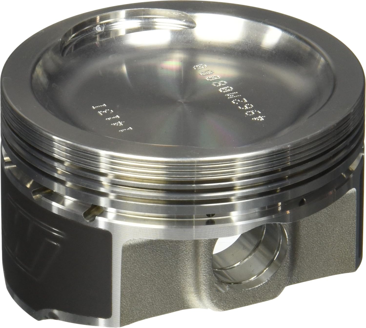

Polishing the chambers eliminates any risers that could turn to hotspots and cause pre-ignition. I also polish the tops of my pistons even though some people think I'm crazy for doing it.
Markings like these on the tops drive me crazy and are just asking for trouble. And those sharp edges from the valve relief machining? Gross!
Clean up the casting flash on the topside of the head and port the oil drain backs to help oil get back to the pan as fast as possible.
