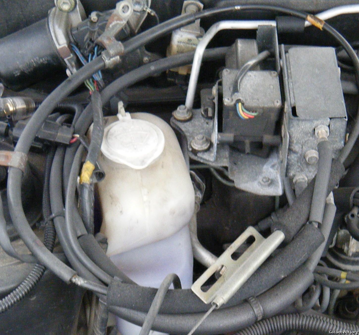

I had the cruise control removed from my car when I bought it. I am not certain where one part connects. I can see where the main part bolts on the firewall and where the throttle linkage goes, just the other part. The vacuum actuator I believe.

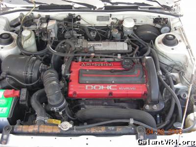

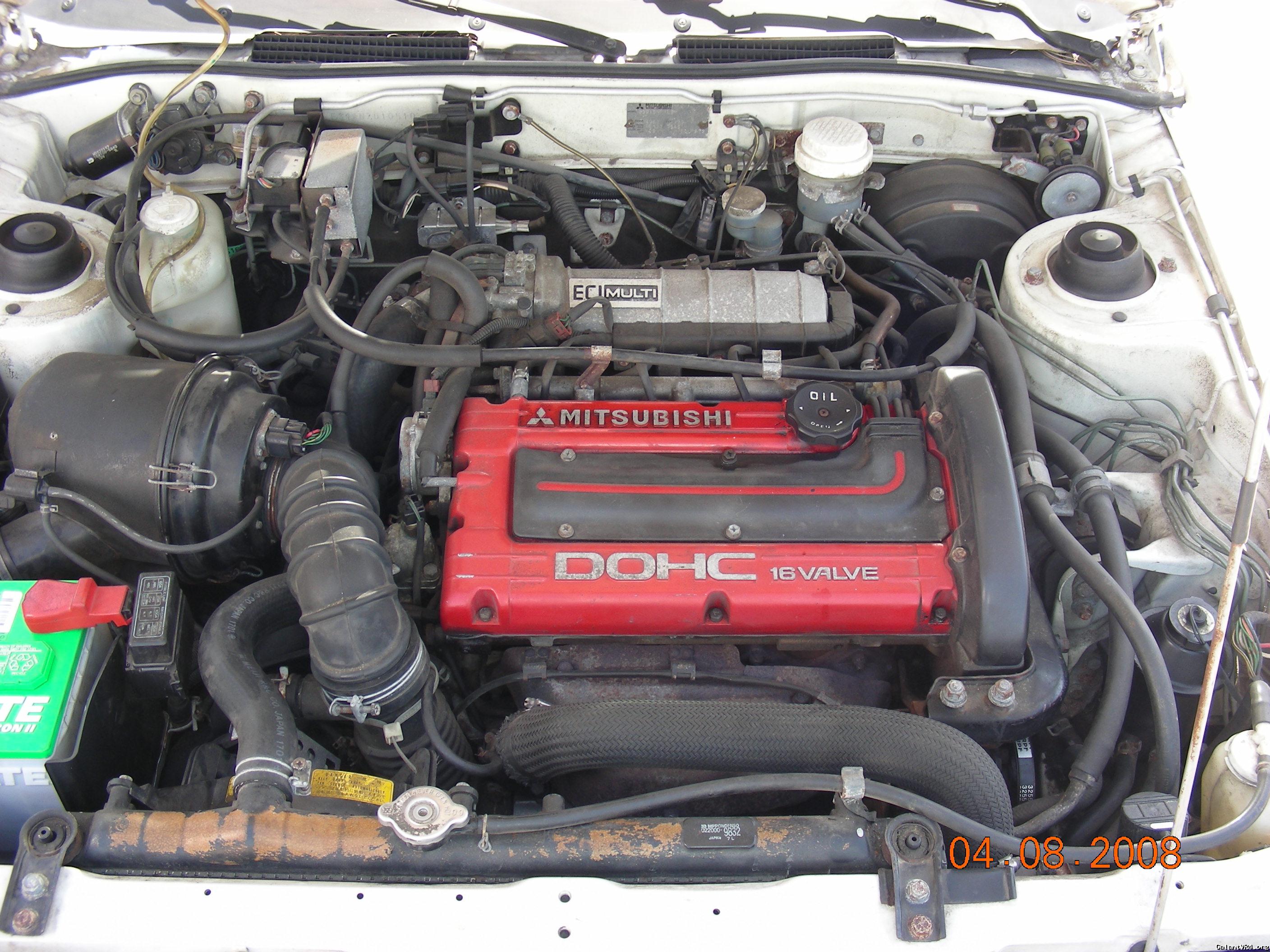

Anyone have a picture of the "other half" of where the CC goes? I could tell where the unit bolted to the wall. And I am 90% sure I can route the cables. It's just the other part that I don't know where it should mount.
ktmrider
Sep 10, 2007
3,128
Tempe, AZ
If you're asking about the vac canister it goes all the way to the left/rear corner behind the PS strut tower. I'll try to find a pic but you can just see the two bolt holes on the back of the tower.
Edit, look in the far upper-left of the pic, you can just make out the vac can below the wiper motor and behind the strut tower.
