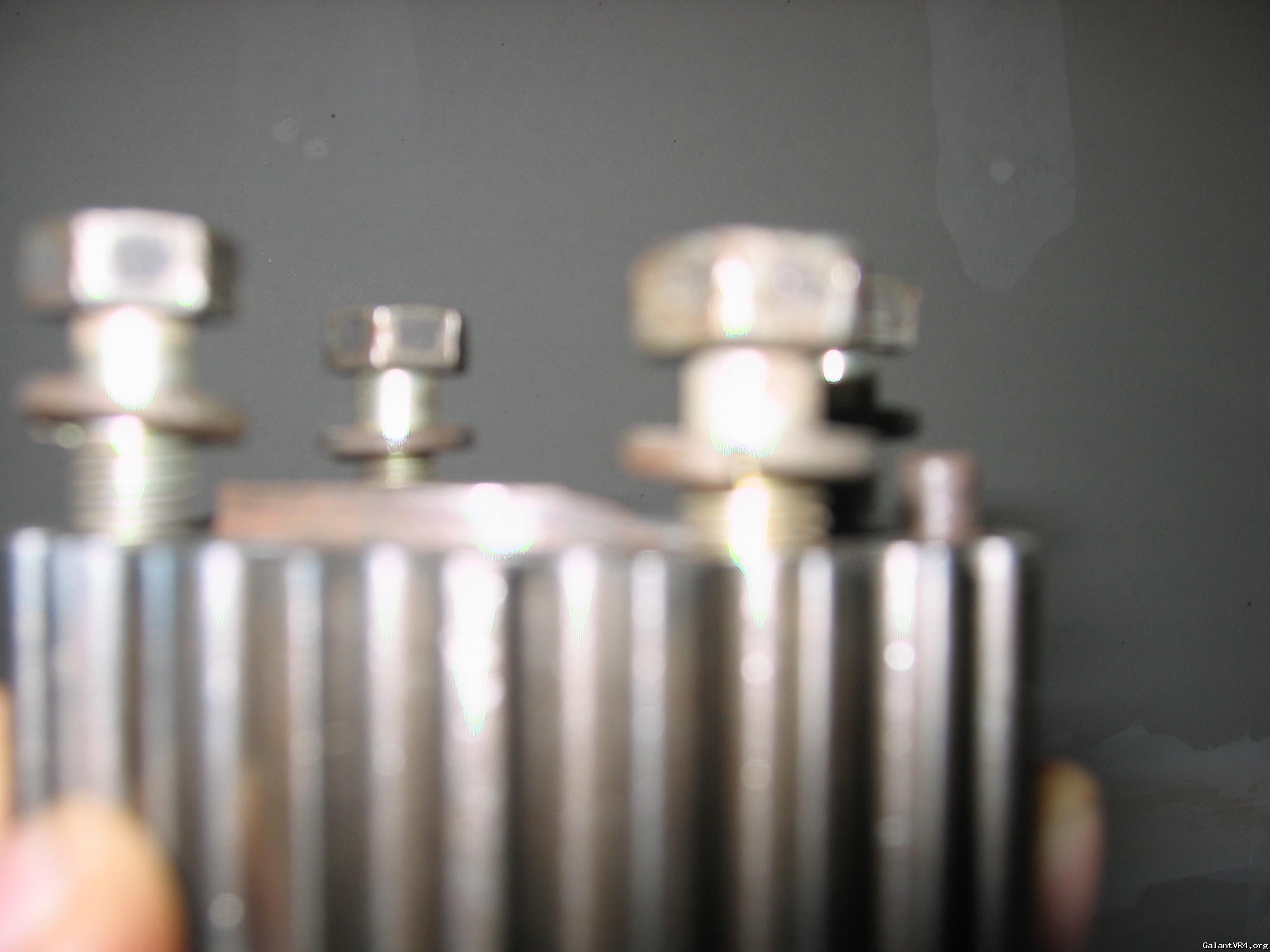

After tearing down my engine (for the second time) I noticed that the lip on mine got partially sheared off. Does anyone have a part number? Or know where to get one other than the dealership?

MD326852 - Engine - Camshaft & timing - Camshaft & timing - Timing gear set
They are about $40 list price, less if you can get a discount (or buy from JNZ).
I'm sure somebody has a used one around you could get for cheap, though.

Thanks! I found it for $30 new, so I'm going to go w/ that.
If not, I might take you up on the offer. I appreciate it.
