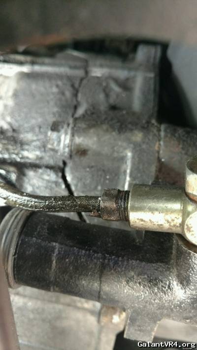

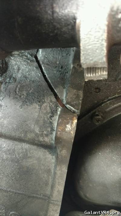

Well I have been having odd issues with the clutch in our Galant VR-4. I eventually notice one of the clutch slave cylinder mounting holes has broken clean off. I then notice a massive crack running all the way from the slave cyclinder up to the top of what I believe to be the bell housing. I have spent the last hour reading all the various posts about this particular issue and some deal with this by welding up the bell housing but looking at the 10 - 12 inch split I do not think this is something that can be welded. (I'm not even sure I it is the bell housing I am looking at... I think it is... The clutch slave cyl mounts to it...) So I am looking for some advice... hate to trash the car because it is a really nice specimen. It's worth saving. Is my best course of action to buy a replacement transmission? If so, where is a good source? Any advice appreciated.

Buying a replacement transmission is probably the easiest solution, unless you or a friend can tear the transmission down to replace just the bellhousing. It could be welded though, if you have anyone nearby good with cast aluminum. Needs to be removed from the car either way.
