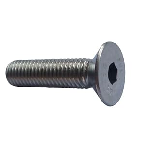

I was thinking of welding it shut and some body work, i was also thinking of this
or get a rubber or silicone washer with this
your thoughts?

I'm gonna have to try those plastic hole covers, for now untill I weld them shut. I love the wingless look! But do you get any water that comes thru the plug? Or did you seal it before you popped them in. Thanks...
BTW, the bolts on the trunk spoiler hole is called the NRG fender washer.
