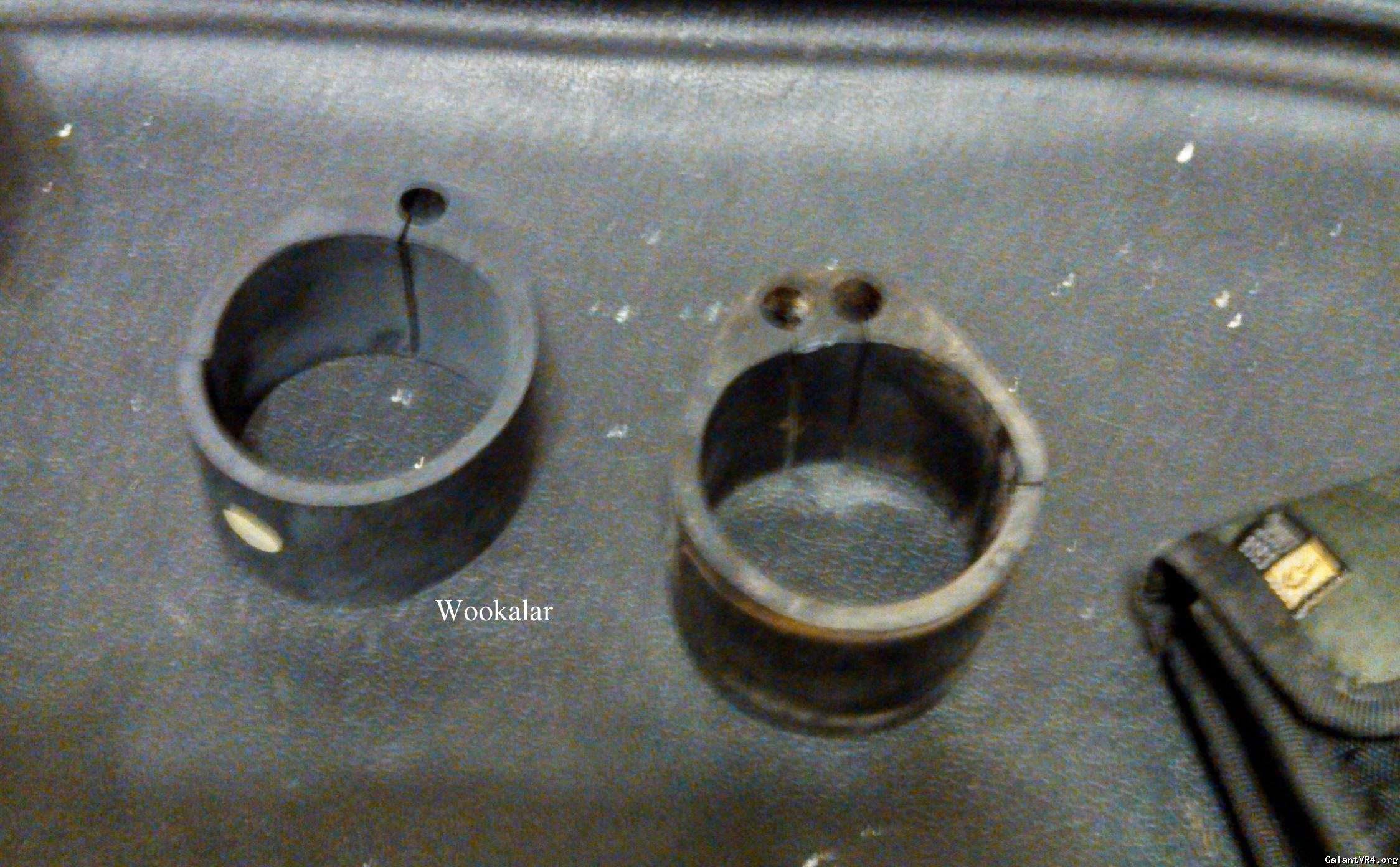

One of the front rack bushings is different from galant to dsm. The galant rack n pinion bushing has two holes in it for the two lines that pass through it.
The dsm rack bushing has one hole in it. See the pic below:
