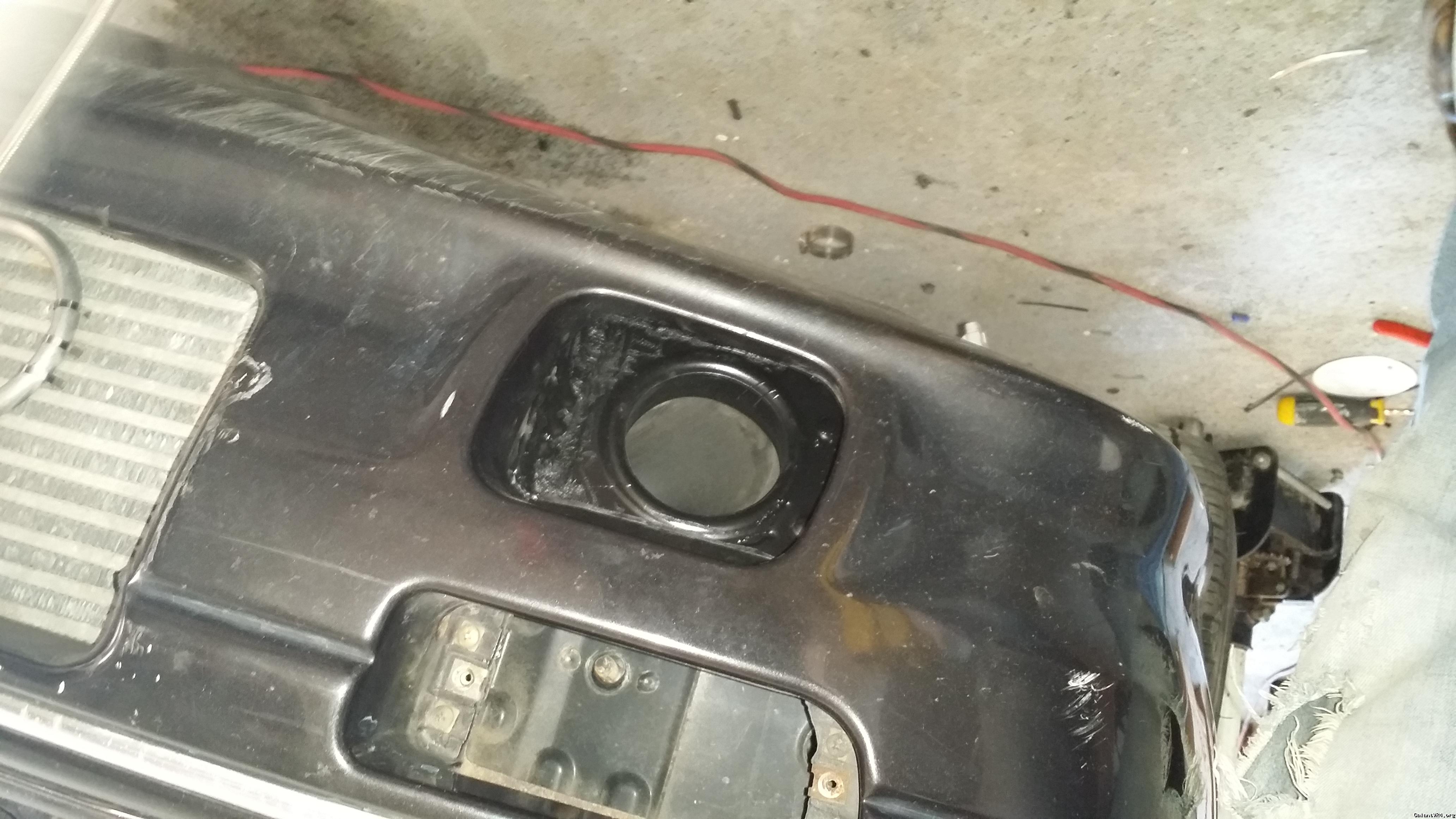

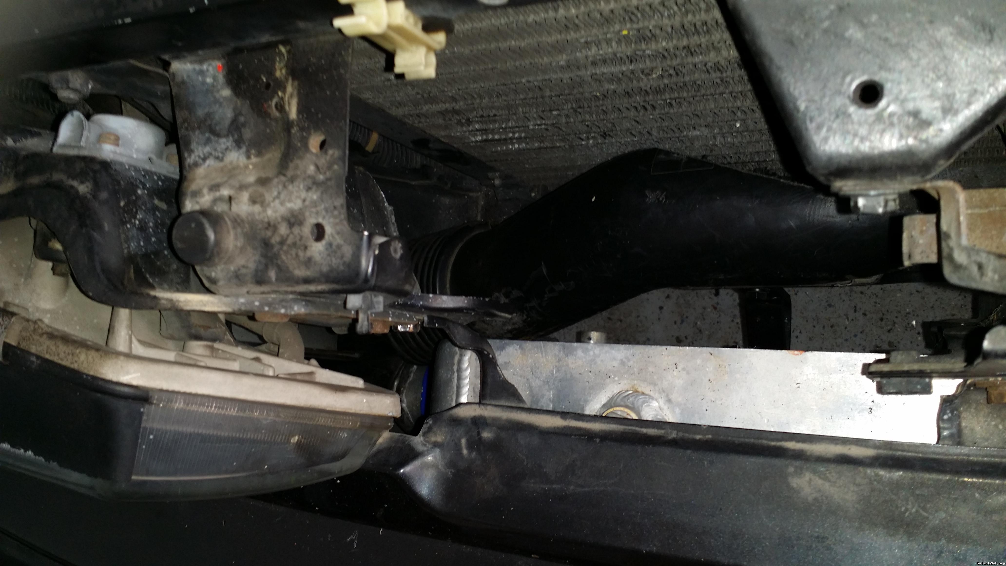

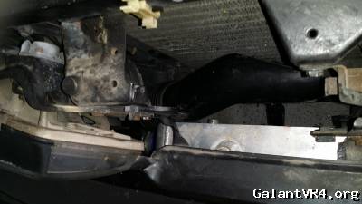

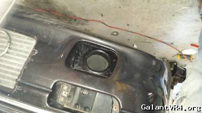

So this summer when I bought #901 I noticed the temp creeping up to 3/4 then back down note we did hit 108 some days, after some research here and cool ideas this is what I have, first off I do have a big FMIC so it doesn't help, I put on an Evo 3 Koyo, 12" electric fan and made a shroud for it, also took off the oem fog lamps to create some air vents to lead to the radiator, sealed the radiator to body crack with weather striping, changed the thermostat to 160, here are some pics (not the best) but hopefully you get an idea of what I'm doing, so if there is anything else that mite help please let me know, I don't know why but the browser flips my picture of the bumper, thanks for your help!!!

You need two fans, and to close that gap on the bottom, either with a thin sheet metal plate or a composite plate so air is channeled through the radiator and not lost out the bottom. A vented hood would help to alleviate hot air also. And wrap all hot pipes in the vicinity with some heat wrap. A upper radiator plate would also be beneficial so air does not flow over the top of the radiator.
