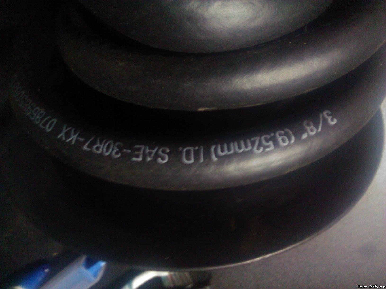

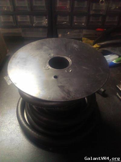

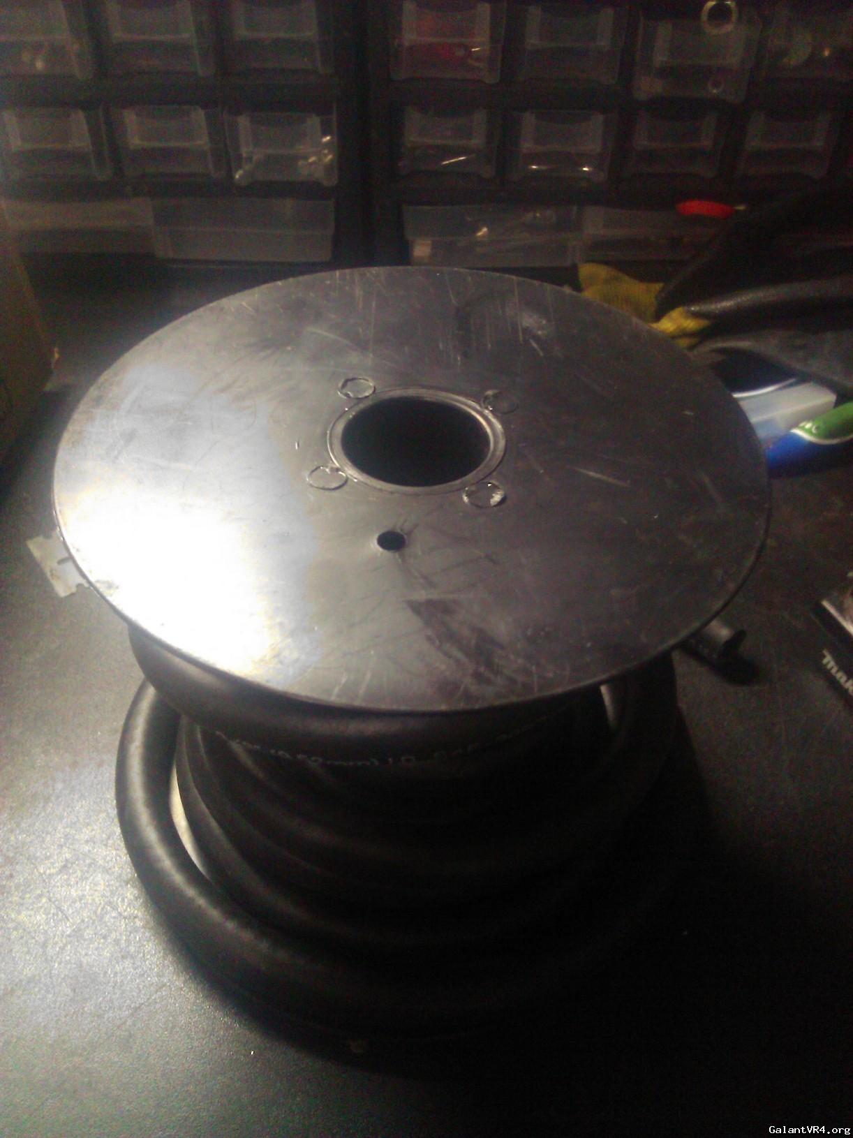

3,473
a spool of 3/8" hose from any parts store on earth will do the job just fine. Unless you just want to by more expensive rubber hoses that are pre-cut, I don't see the point in ordering each one individually. The whole spool cost me $22 bucks.

Thanks Brett, that's what i thought, but research around is full of the OEM nazis going IT AINT ONE SIZE FITS ALL and WHAT IF SOMETHING HAPPENS blah blah. 3/8ths it is.
