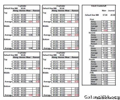

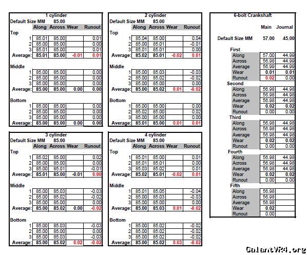

My cylinders are in a decent shape, but pistons have a bit of wear. Since the engine is out I will replace the questionable parts.
Only need about 300HP. Replacing pistons with stock. From what I read, Big16g should not destroy them if stay under prescribed pressure.
