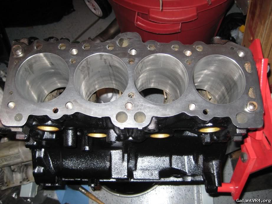

^^^Just out of curiosity...which Mitsu gasket did you go with? I will be pulling the head off this winter and will most likely replace it but I really don't know which to go with. Also, which studs did you go with and did you reuse them? Here's a pic of my block before the install...
I wish I would of done a little more research back them before going with a Cometic.
