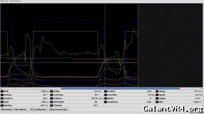

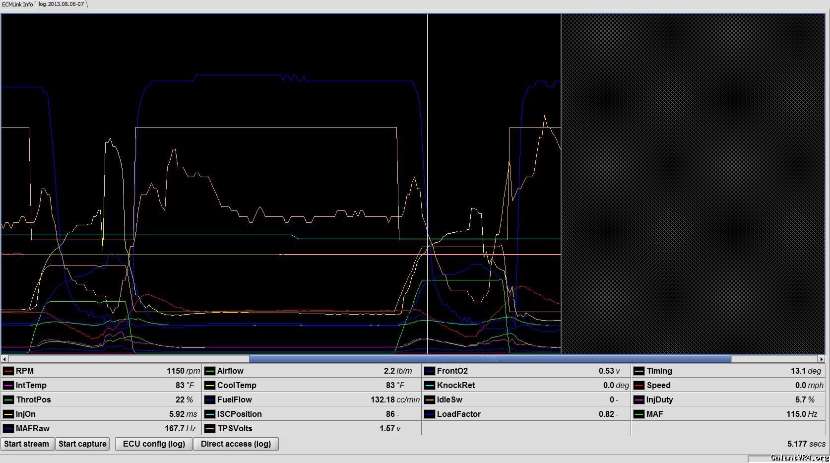

For some time now, I've has this stumble right off idle as I'm just getting on the throttle. It only occurs while the motor is cold.
I've attached a log with two captured events.
This issue has persisted through tuning changes and different injectors.
MAF is a 399 model with honeycomb in place, and BOV is a stock crushed unit still configured to recirculate. I've checked for boost leaks up to 25psi and cannot find any. Throttle body has the FIAV block off but functional ISC. Trims are within 3% normally.

Screen cap the graph/chart for those of us non-linky folks.

TPS Throttle Position % is way high ( 22% ), should be 9-11 when the throttle is closed. First thing I'd adjust.
tsitalon1
Dec 29, 2010
309
Montgomery Al
I think you misunderstand...
It's at 22% because that's the point in which I stepped on the throttle. All those figures are at the exact point shown by the white vertical line.
