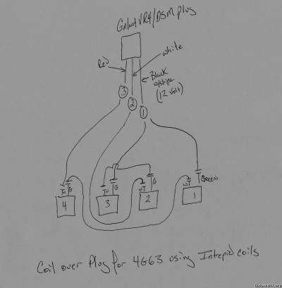

Yeah, I actually did read that thread. I haven't added any extra resistor packs or anything. I simply have my COP system wired like so:
3,473
The coils are intrepid coils. The harness is the regular 3 prong connector. No pics, but I could take some.

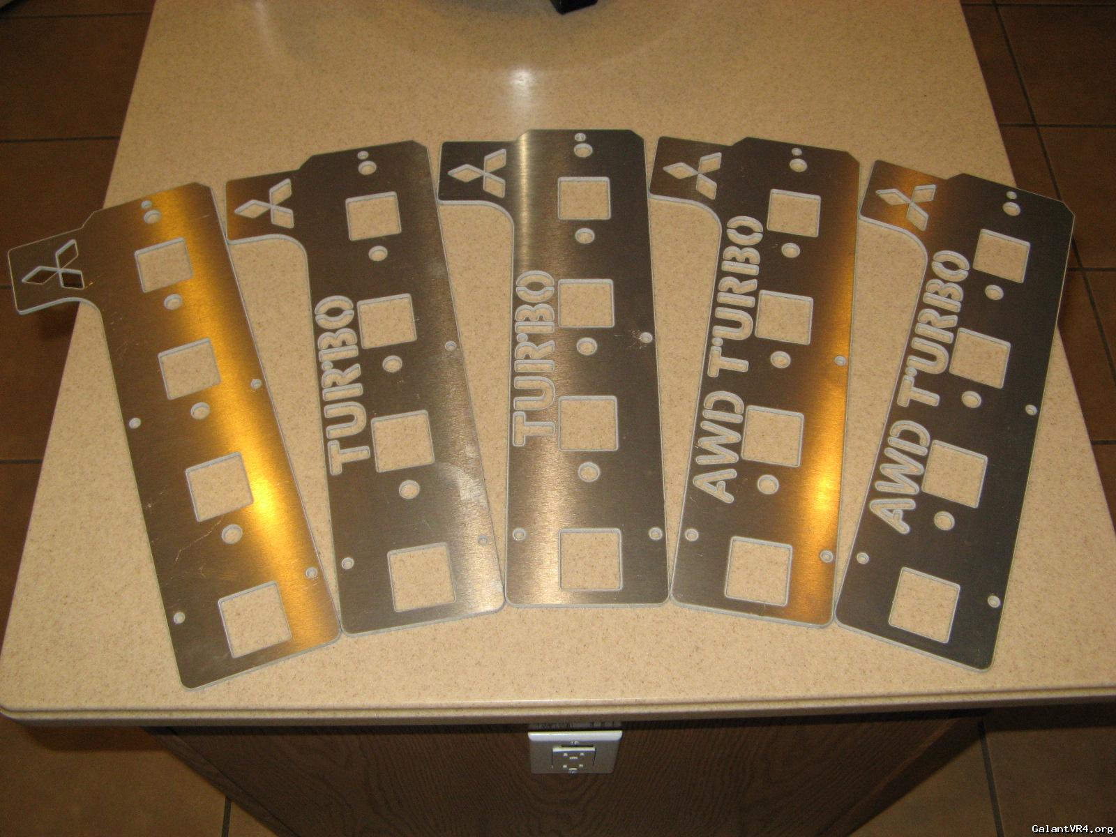

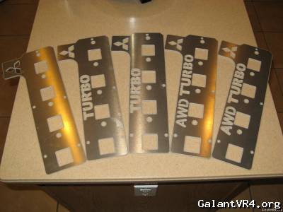

Anyone know where to get cheap COP plates? The only ones I can find are JMFs and they are priced outrageously.
Sorry for the thread jack. It didn't seem like it was worth it to start a new one.
