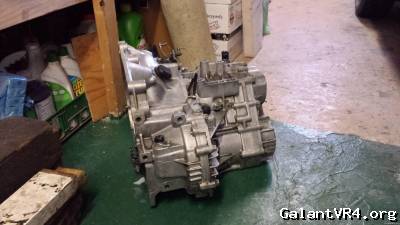

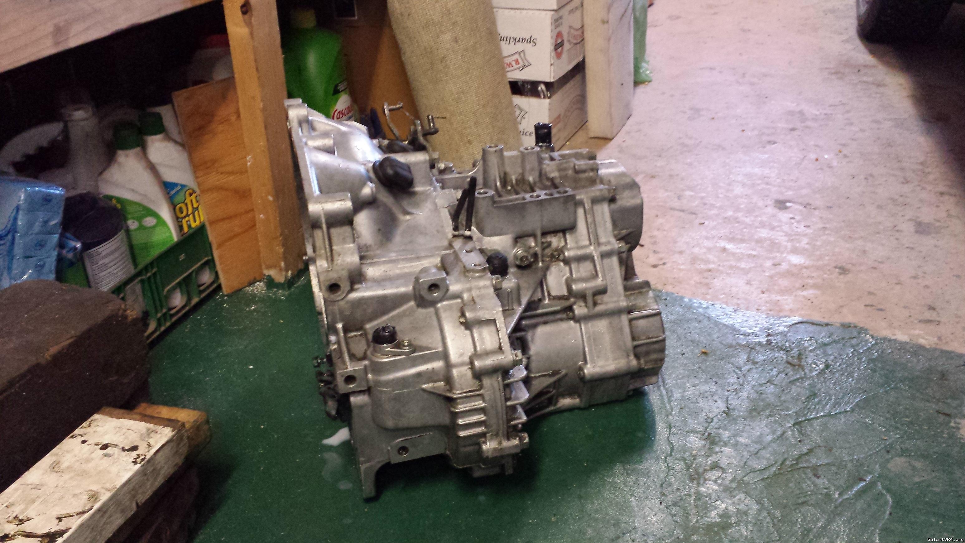

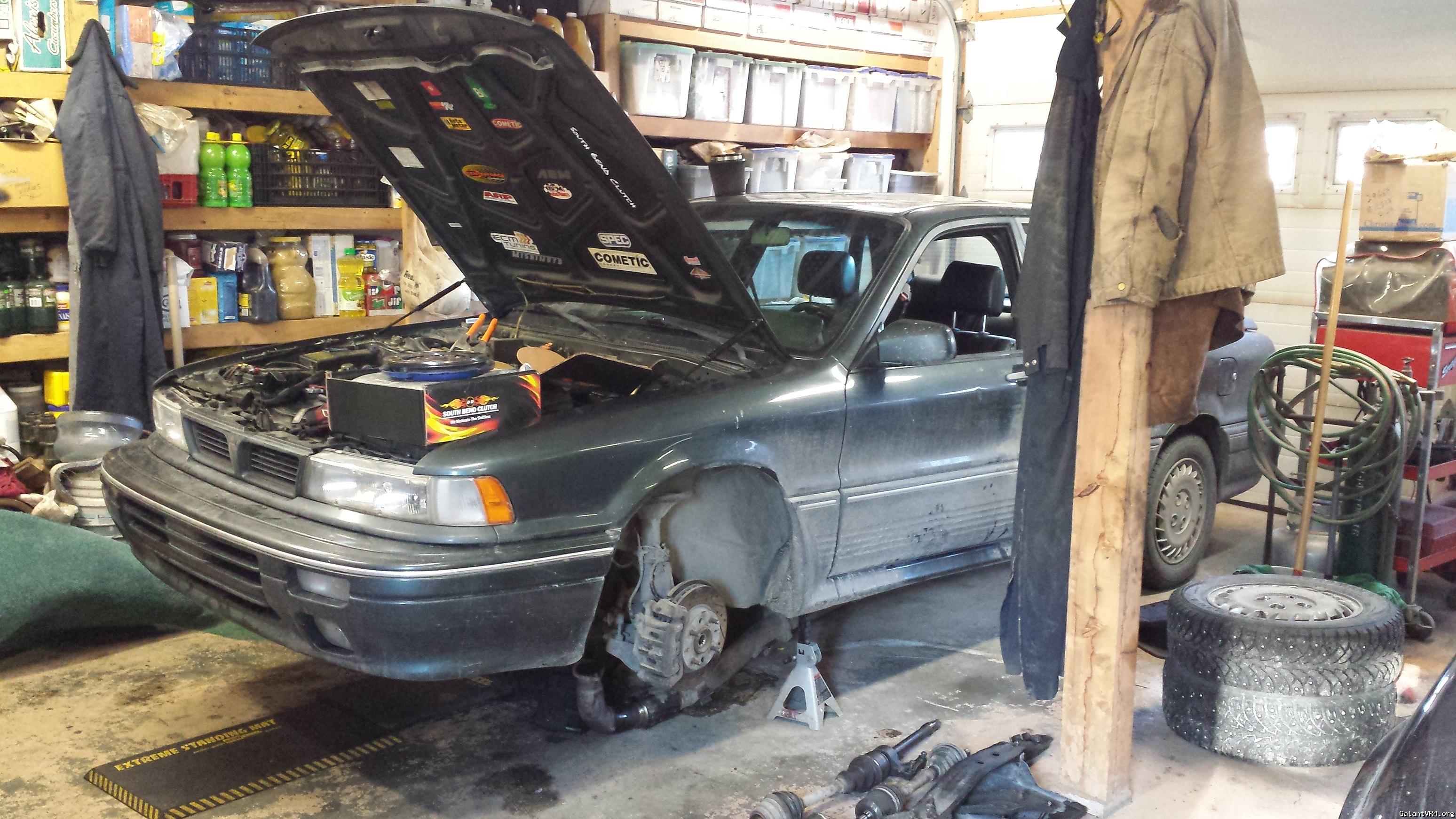

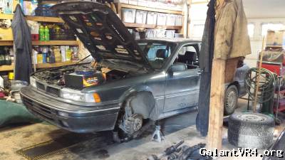

Update: Well the car is still jsb while I workout the clutch issue,
But this did give me an opportunity to finally scrub most of the road grime off the transmission /ubbthreads/images/graemlins/smile.gif
At this point I'm leaning towards ordering a different clutch since I've been unsuccessful at getting the Southbend to work, but I have a few calls to make on monday that will probably answer my questions, I'll try to let you guys know what happens.
