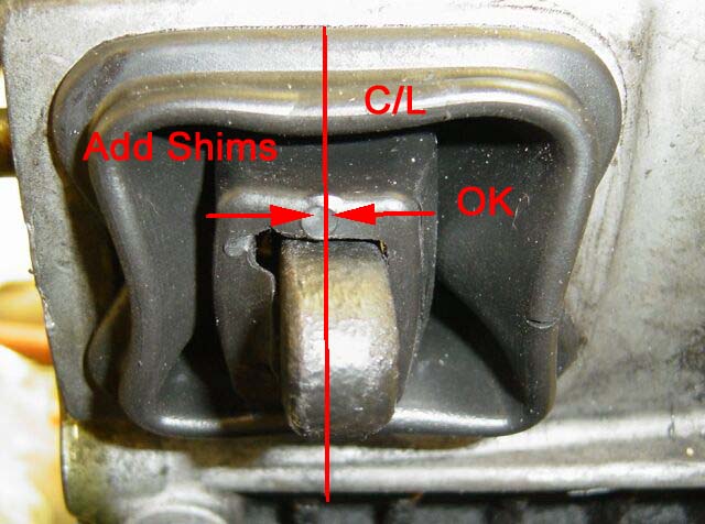

I have read about shimming the fork after it has been worn...Does anyone have a link that would show me more about this??

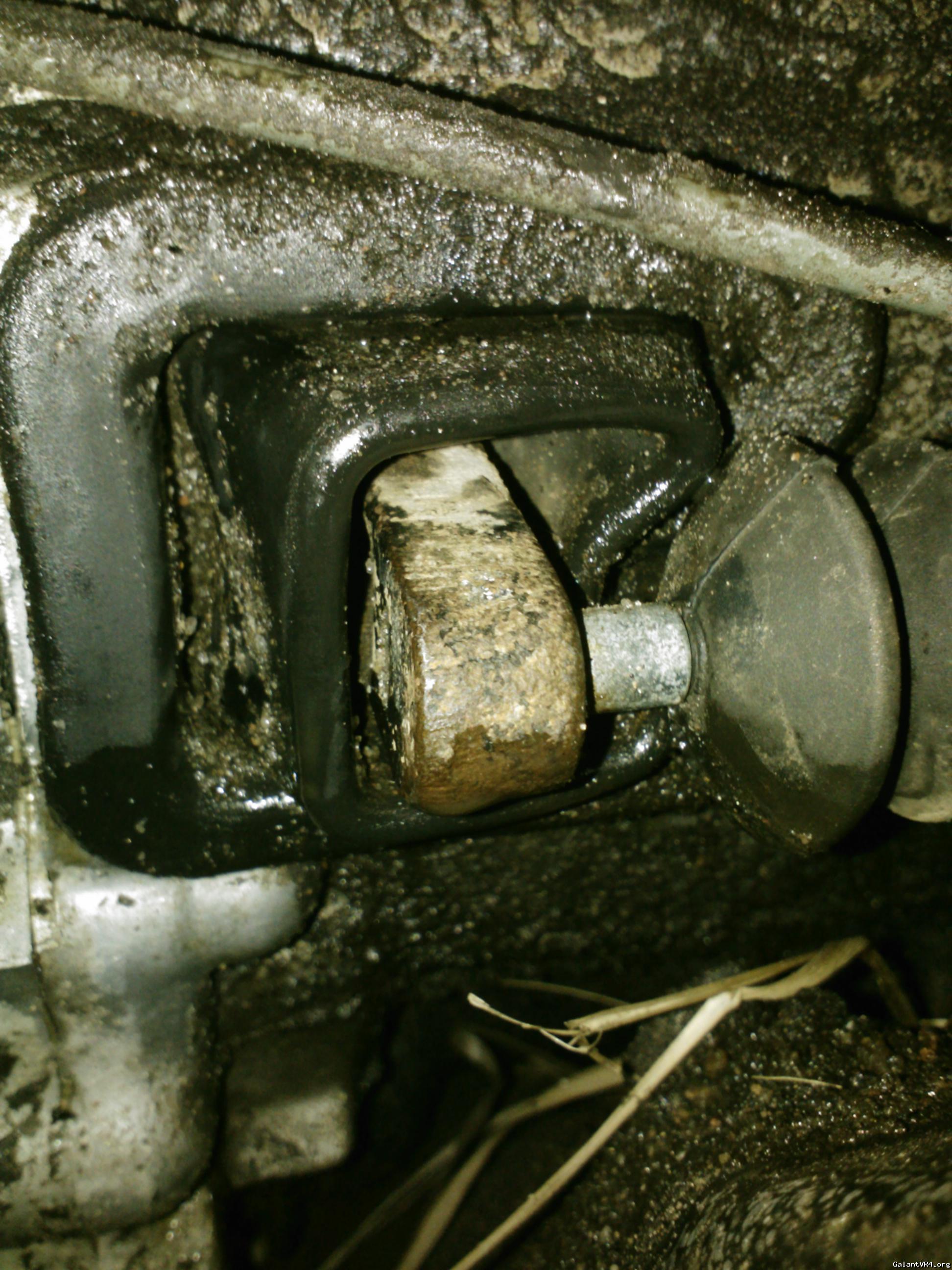

2nd- Have pictures but it appears to be sitting a tad bit to the passenger side...but the cylinder rod is tight against it.

That is the best picture I can get showing the positioning of the clutch fork.

Favoring the passenger side indicates an issue within the fork/pivot ball, it should be more to the driver side.

Clutch fork actually looks okay to me, though it's a weird angle for a pic. My money is on hydraulics.
