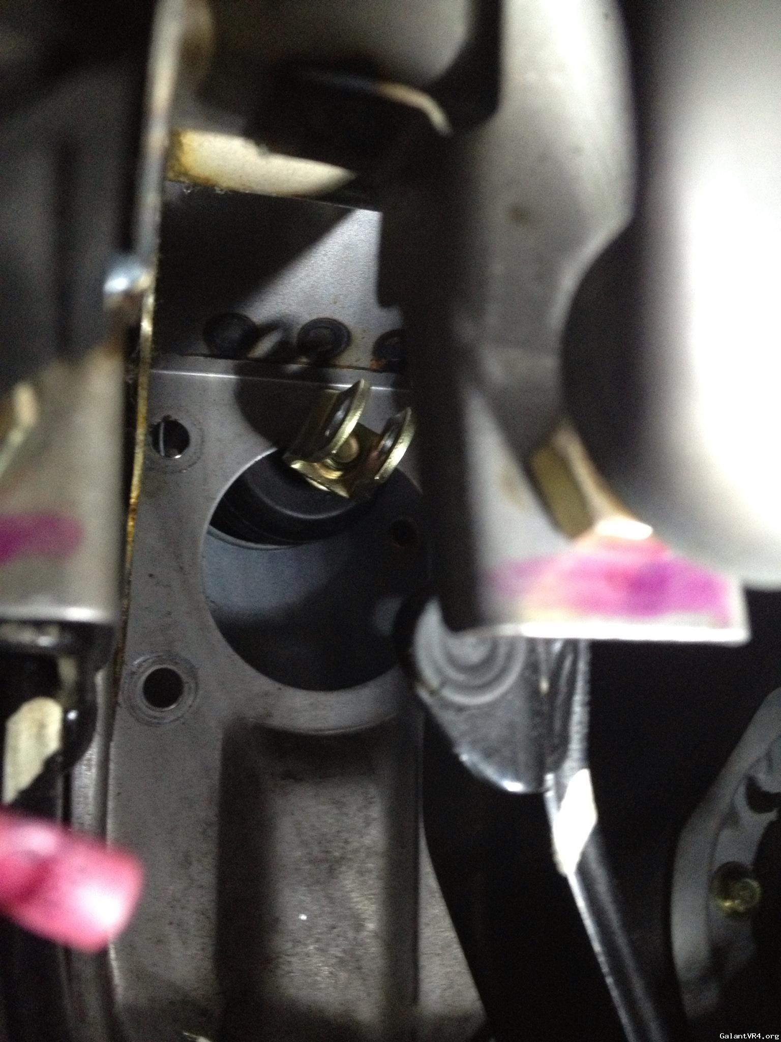

So I started pulling out my clutch pedal assembly this morning. I got it unbolted, dropped the stealing column, disconnected the befalls from the rods and pulled the mastercylinders back. The brake master cylinder doesn't go very far back. When I try to wiggle the assembly out it won't clear the mater cylinder rod fork. I then can't pull it out enough to clear it because the top of the assembly hits the bracket the would hold up the under dash cover/ holds up the little fuse box.

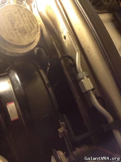

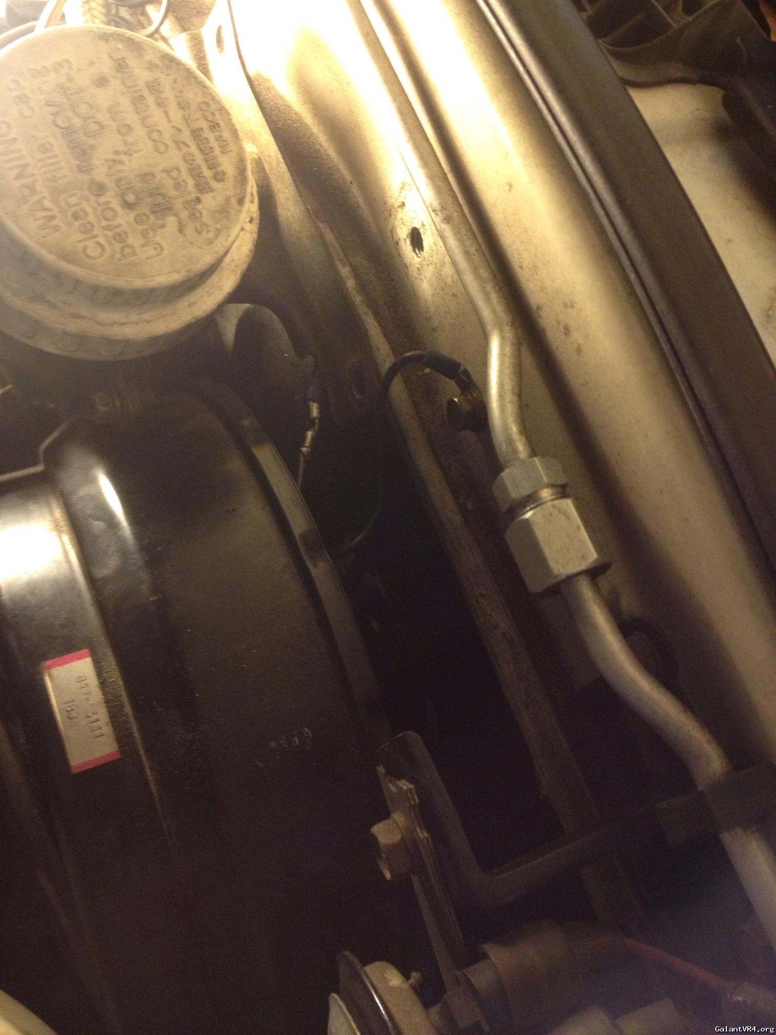

Master Cylinder Puller back as far as it would go

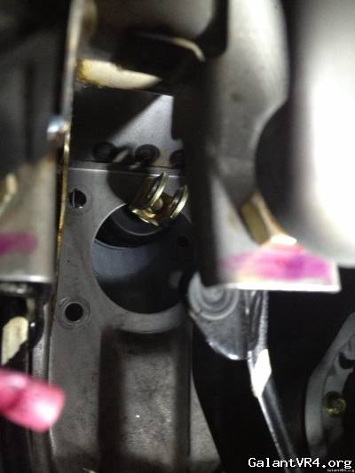

Inside view of Master Cylinder Fork
Bracket that hits pedal assembly

That is the brake booster rod. Remove the two nuts on the master cyl to brake booster and seperate from booster. Move master cyl as far out of the way without kinking the brake lines. Then angle the booster and pull it the rest of the way out.

When I removed mine, I pretty much did exactly what you said. Once the brake and clutch masters are loose, I pulled them away from the bulkhead as far as possible.
You have to remove both C brackets (rod forks) from both the clutch and brake master adjuster rods. I had the same clearance issues you are having, and found that removing both brackets gives the the wiggle room you need.

Thank you! That did the trick and gave that extra little wiggle from that I needed to get it out. /ubbthreads/images/graemlins/smile.gif
Sending it out to Shepard. It really doesn't have play that I can tell but going through a process of elimination for my really low engagement point.
