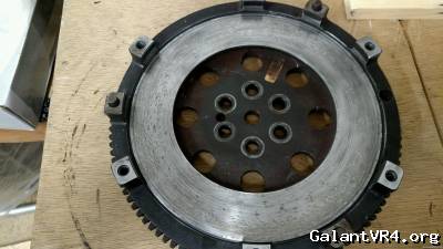

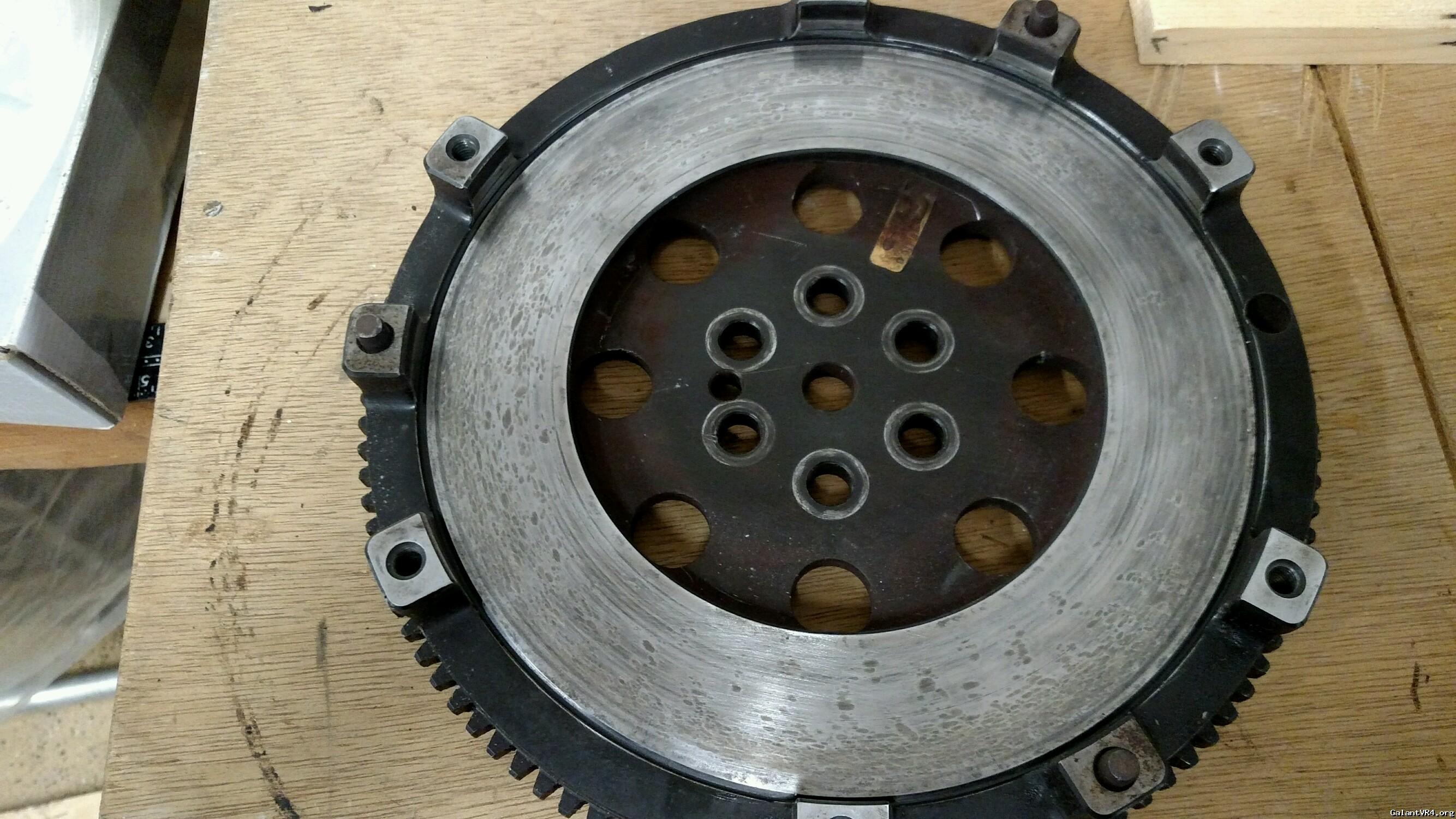

Wells, found that iceman had a lightweight ACT flywheel available so picked that up from him. Anyone have reliable recommendations for a clutch / pressure plate setup for a build that will 'grow'? Or better yet, anyone have the rest of this part of a setup up for grabs? Easy feel and RELIABLE as this is just a setup for the girl to go get whiskey & smokes quickly plus the occasional track day to get me out of the house. Otherwise 600-700-800hp grocery getter is just my style.

Messaged ice, thank ya sir, the box arrived - quickly. Even better, I prioritied some parts for the bathroom to arrive today as well, so when I ran upstairs with the box from ice,,, the girl got all excited,, the puzzled look on her face when she opened it,, but I could tell right away,, she's going to love her new ACT street lite shower fixture : )
