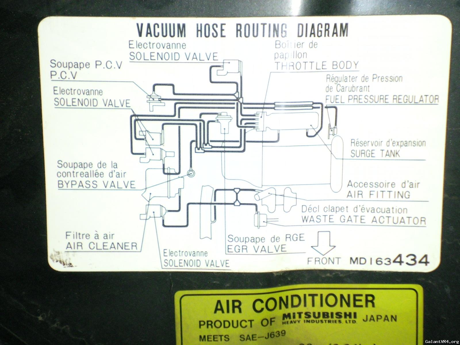

I'd be interested in learning more about the vacuum hose routing as well to verify my car is setup correctly. Is there a diagram or doc on this somewhere? Would it make sense to post pics of the engine bay and let people comment?

If you have an orginal vr4 hood there should be a good diagram. If you don't have one I can put up a picture of it.

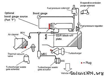

would this work? if it doesnt load the pick the link i found is

The picture looks good, but mine is a little different. I read that you may have more boost spiking if you use the intake manifold source for the MBC. I used the fitting on the pipe coming off the turbo to connect to the MBC. This allowed me to use very short lines going to and coming from the MBC. So, my line from the intake manifold to the blow off valve does not have a "T" in it.

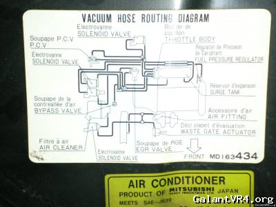

Ok so I have a question. What if im running a na tb and I only have 3 vaccum ports. What to do with them? But all my vaccum lines ate routed just like picture above.

Quoting theboyo19:
I thought the consensus was that we didn't want anything teed off our bov line.
T off the bov line is OK I just wouldn't t off the fpr. And you can just cap the ones off the NA TB ASAP FYI PDQ JK YW
